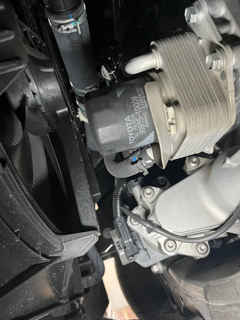

Ok this is a weird question. I researched the oil filter number for my 2024 Taco Limited Hybrid. I came up with the number 90915-YZZN1 based on several sites. Just had the dealer do my 5000 service and they used a different oil filter. They used 90915- 10009.
just a little bit confused.

So if I read this correctly it appears the dealer did not change my filter at the 5000 mile oil change?????
My guess is that they did not change your oil at all (or filter)---- since Toyota recommends oil changes at 10,000 miles, the dealership likely had no intention of including that w/ a 5000 mile servicing. Most here (myself included) don't think waiting that long is wise, but that's what's in the manual. The pic in your initial post looks like the filter that came w/ your truck from the factory as well (made in Japan). When I did my own oil change the factory filter was also made in Japan, but none of the ones I got as replacement parts were. Here's a pic of the label from one of the filters I purchased from the dealership:

Unless that's an old picture I'd say that is the original filter.

Yep
Stopped by the dealer to verify. All they do on the first service is rotate tires. Looks like I get to change my own oil until 10k service.
