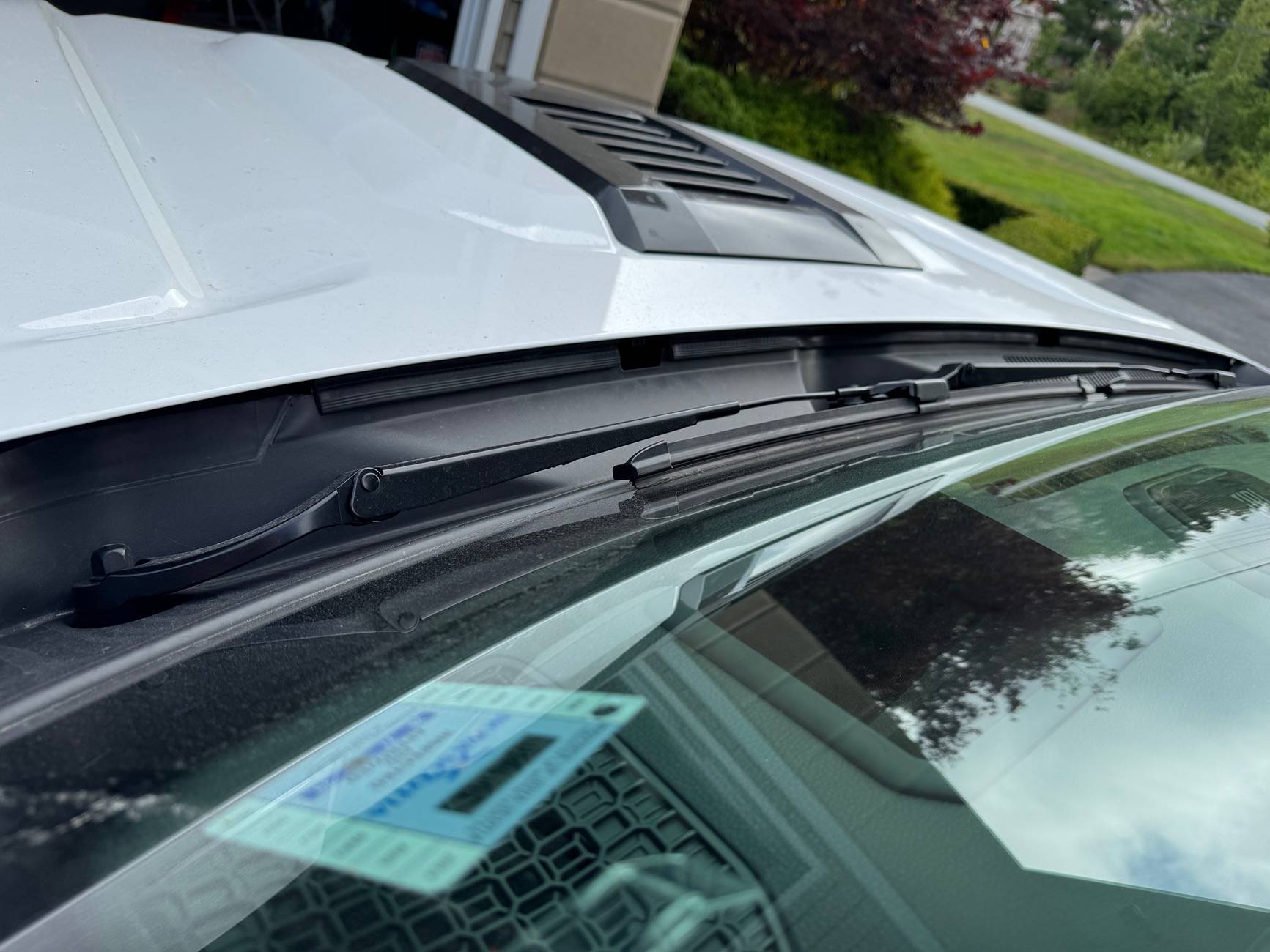

So I got to solve the hood vibration with the help of a member ordered this and installed it no more vibrating hood.
Here is what it looks like installed, got it from Amazon.
Automotive Door Weather Stripping 10Ft Car Door Rubber Edge Trim Seal Strip Gasket with Top Bulb Easy to Install for Car Bus Camper Boat RV Truck Doors and Home Applications
2024 Tacoma Hood Vibrating Fix! (Weather Stripping / Rubber Trim Seal) 20250713_195750

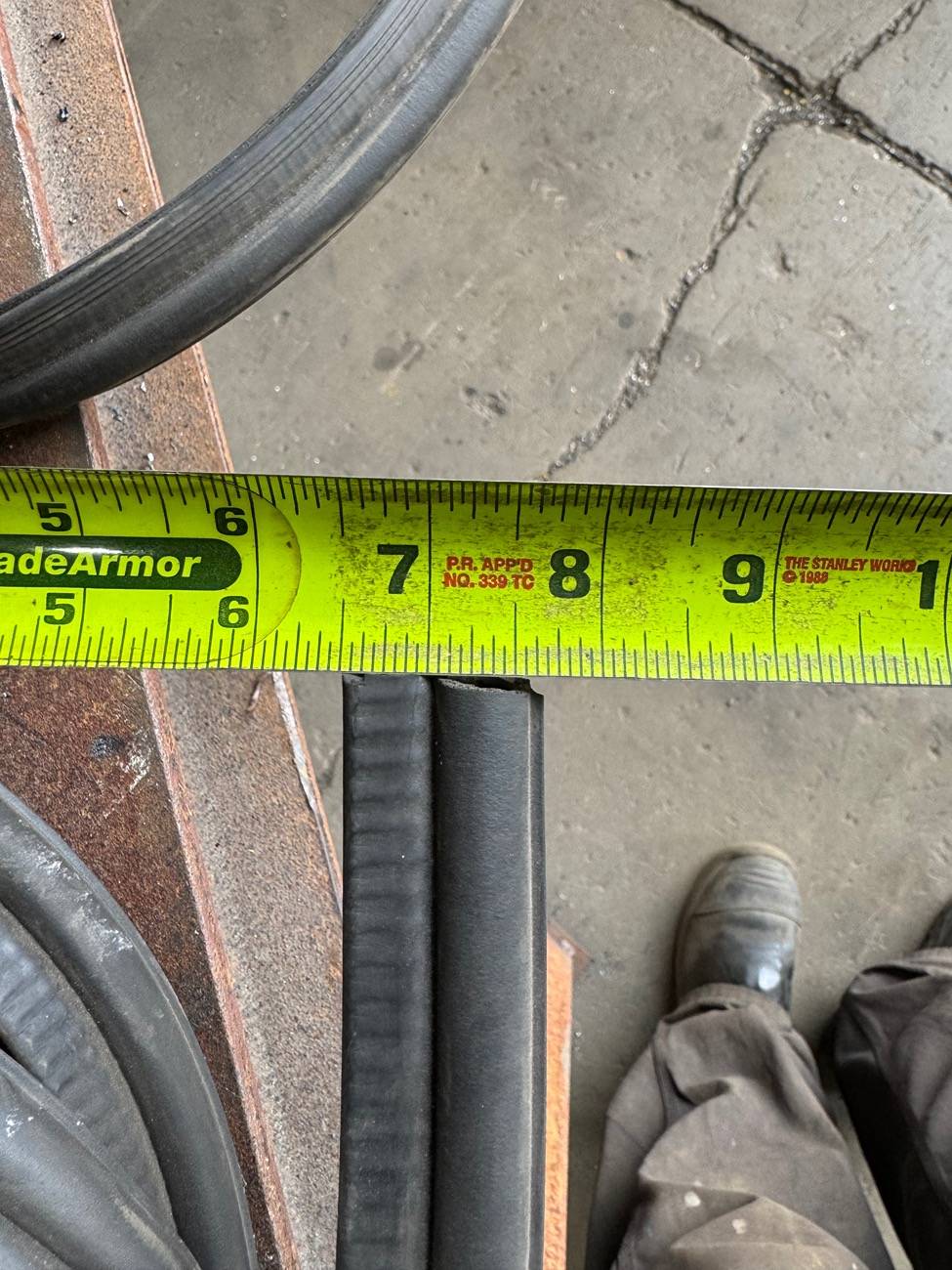

I just happened to have some of this at work, how long of a piece did you need? I feel like I don’t need close to 10’
I went with enough to fit between the washer nozzles
SnowmanJPS
Josh
Feb 11, 2024
752
812
Halifax, NS
2025 TRD Pro

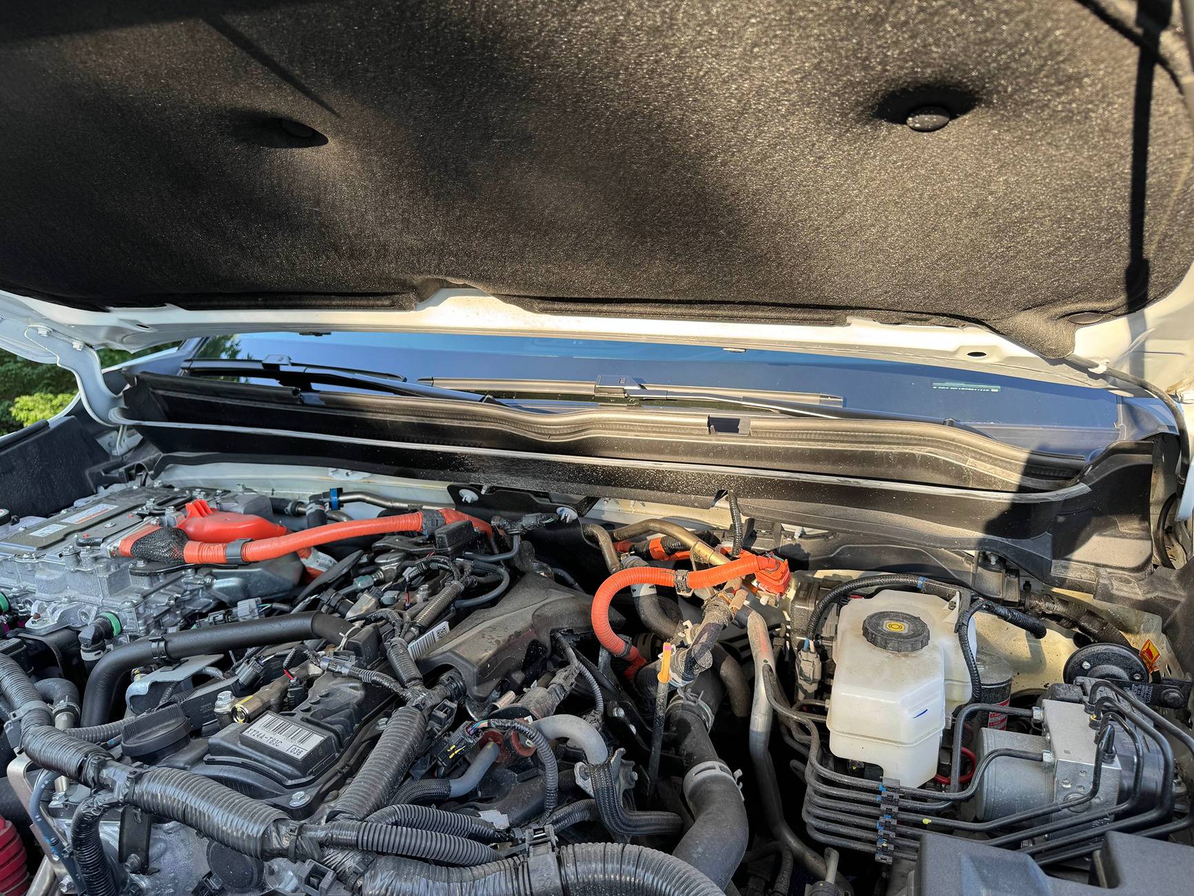

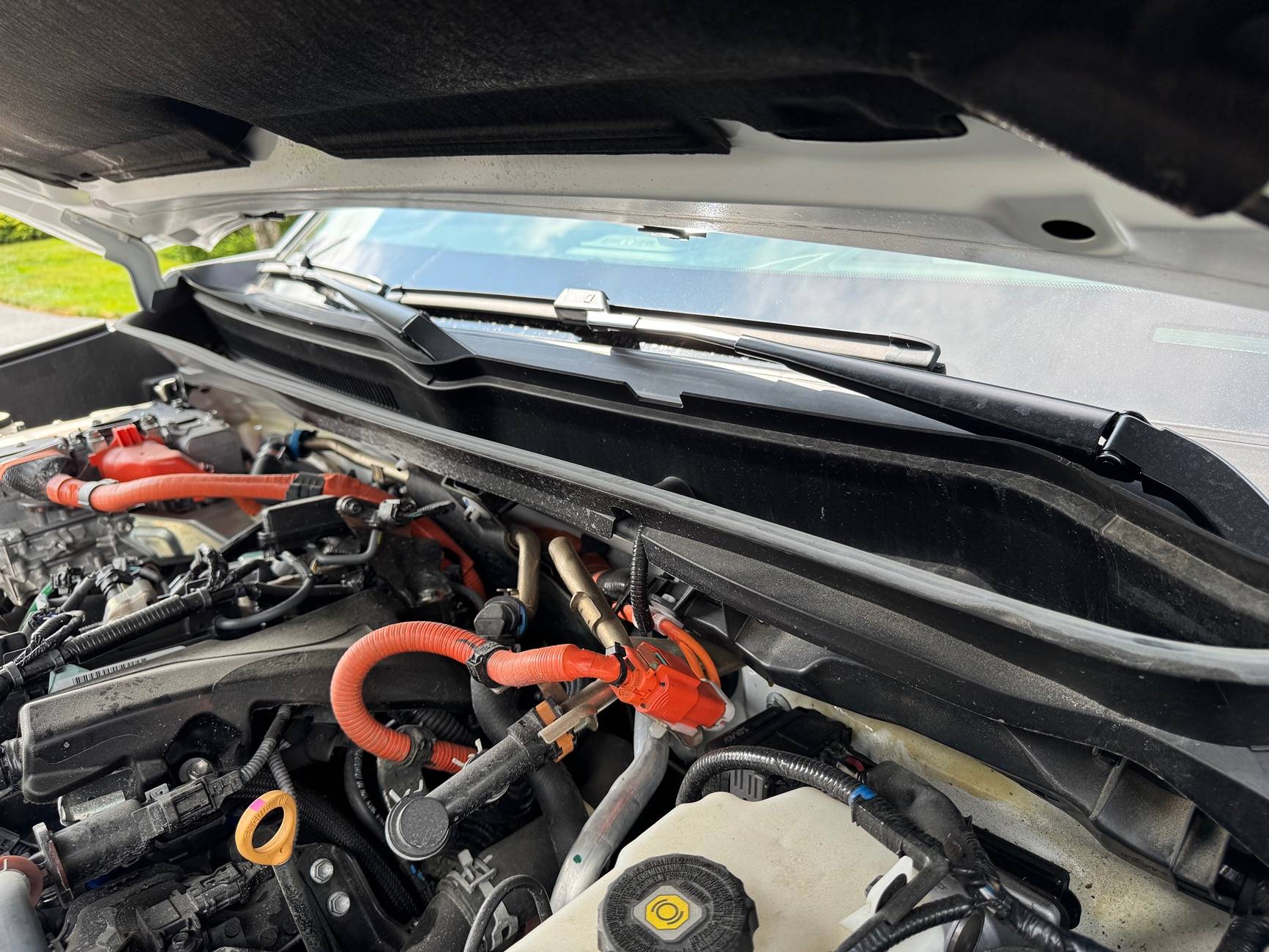

It’s way easier to get a nice cut off the truck I went with 13 1/2”, 21 3/4” and 13 1/2" in order from left (passenger) to right (driver)
I brought 7’ home, there’s still another bit left so if you ordered the 10’ of 1/2" bulb seal from Amazon you could almost do two trucks
Also FYI this type of seal is metal ribbed, you need a decent set of tin snips to cut through it, also the exposed ends left after cutting will rust and drip below to beware if you don't rip them out with channel locks or pliers of some sort, maybe fluid film for good measure to keep all the rust away
Edit, finally tested over the speed bumps in my neighbourhood and it seems to soak up 75% of the shake, definitely a huge improvement, I’ll test more this weekend as I’m driving 3 hours down the province
Before
