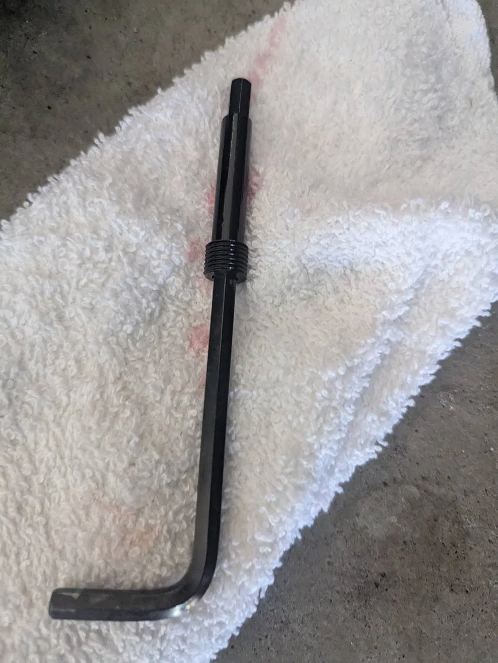

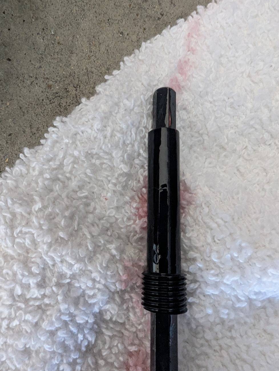

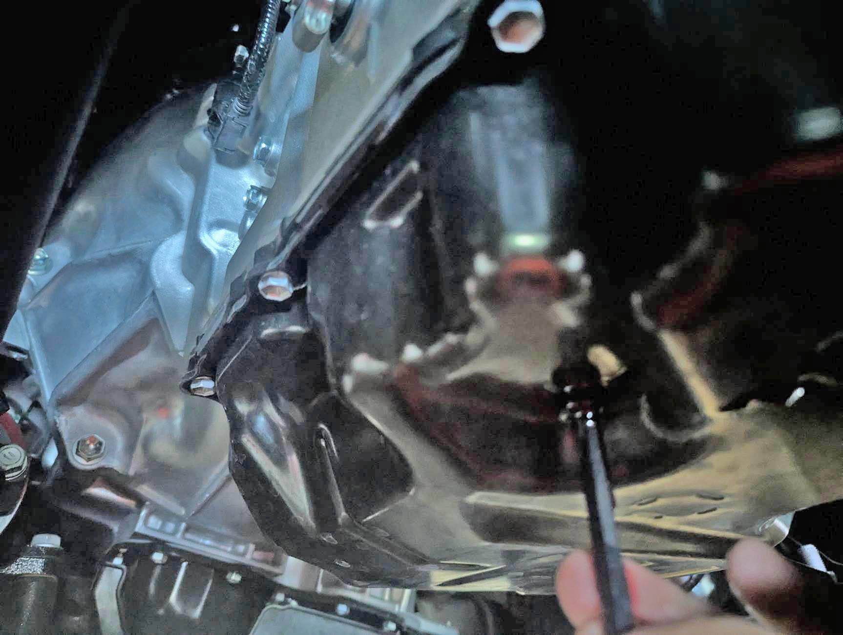

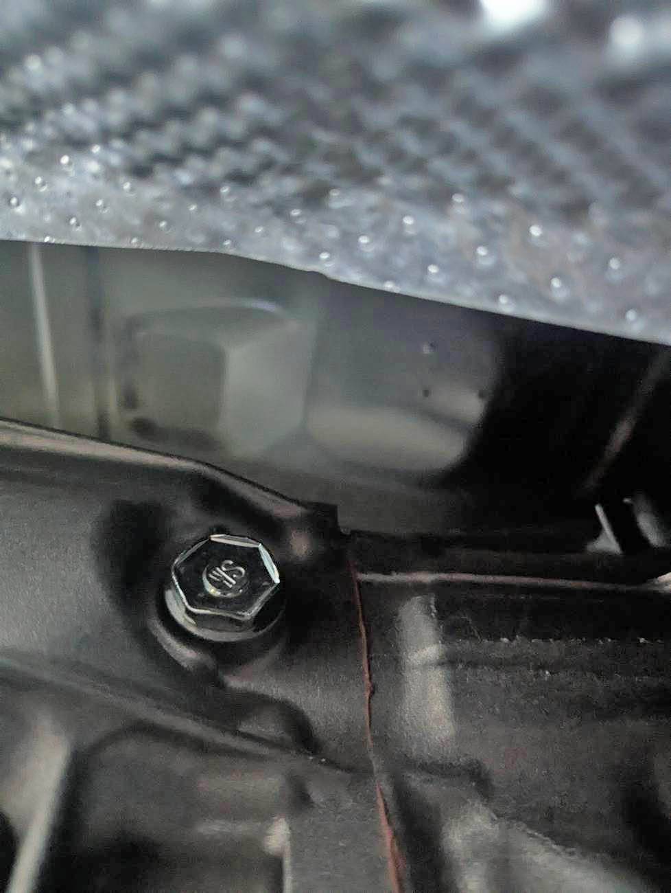

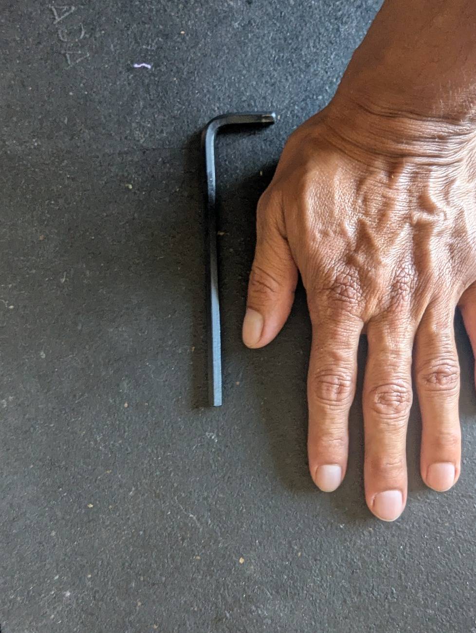

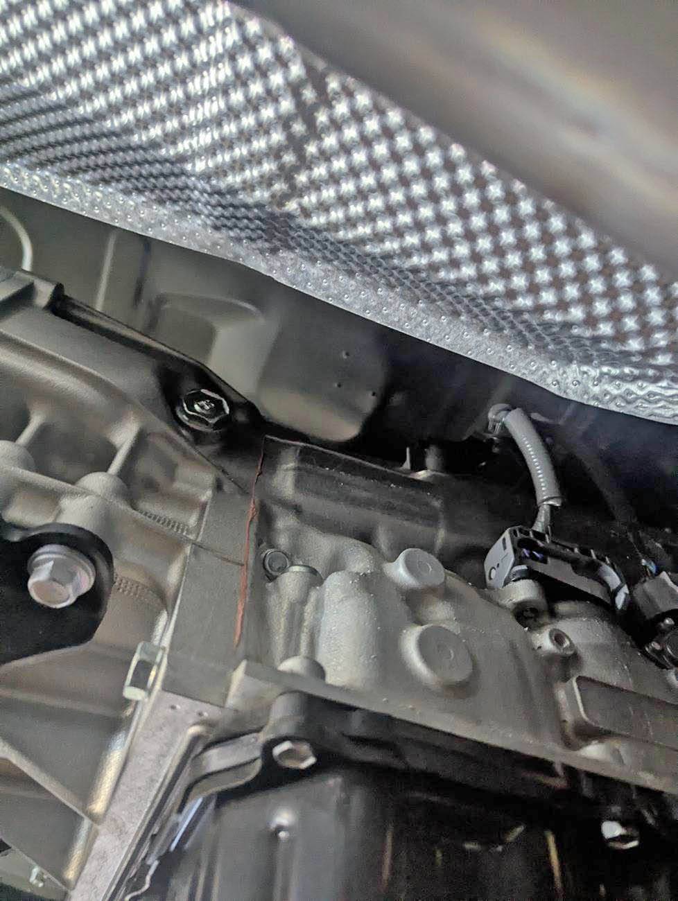

The UA80F transmission uses an internal fill-level tube (a "standpipe") instead of a traditional drain plug.
2025 Tacoma UA80F Transmission Fluid Drain & Fill Guide
Transmission: UA80F (8-speed automatic)
Fluid: Toyota WS ATF (World Standard)
Capacity (Drain & Fill): Remove overflow plug and internal standpipe (level tube)
? Tools & Materials
4–5 quarts Toyota WS ATF
Fluid pump (with hose for side fill)
5mm Allen wrench (for inner level tube) and outer plug
24mm socket (fill plug)
My process
1. Warm the Transmission
Start engine and let it idle.
2. Level the Vehicle
3. Drain Old Fluid
Locate the transmission drain/overflow plug (5 mm hex) on the bottom of the pan.
Place a drain pan beneath it and remove the overflow plug.
You'll see a slow dribble — this is from the internal standpipe.
Insert a 5mm Allen wrench into the center of the opening and remove the standpipe (aka "fill level tube").
Fluid will now drain fully
4. Reinstall the Standpipe
Once fluid stops draining, reinstall the internal level tube (hand-tight, don’t overtighten).
5. Fill with New Fluid
Locate and remove the fill plug (24mm hex) on the upper driver’s side of the transmission case.
Using a fluid pump, fill Toyota WS ATF until it begins to dribble out the overflow port.
Wait for it to slow to a light stream or drip, indicating the pan is full to the level tube.
Temporarily install the overflow plug hand tight only.
6. Start Engine & Check Level at Temp
Start the engine, leave vehicle in Park, and let it idle. Put it in all the gears.
Remove the overflow plug (again).
If fluid dribbles out, the level is correct.
If no fluid comes out, add more ATF thr

4ough the fill port until it dribbles.
Replace and torque bolts
