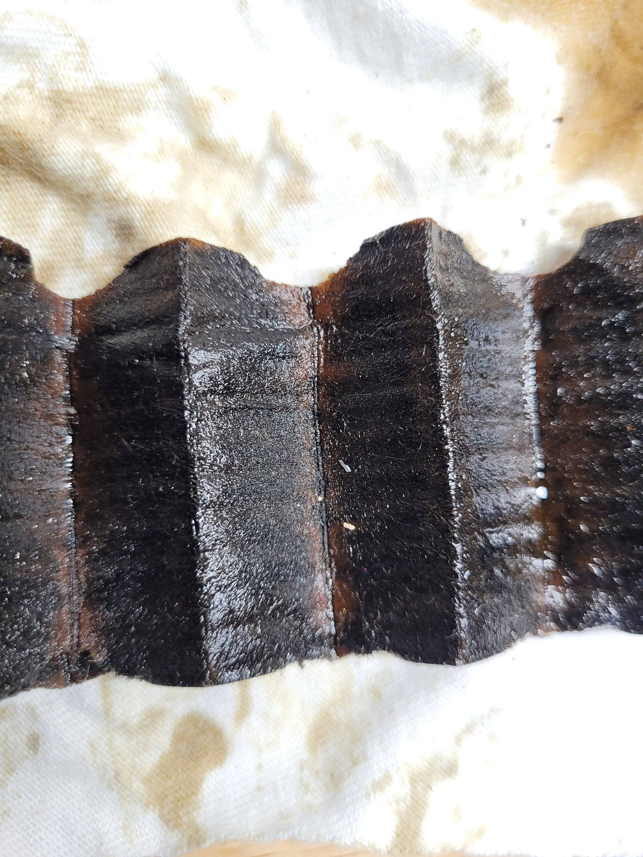

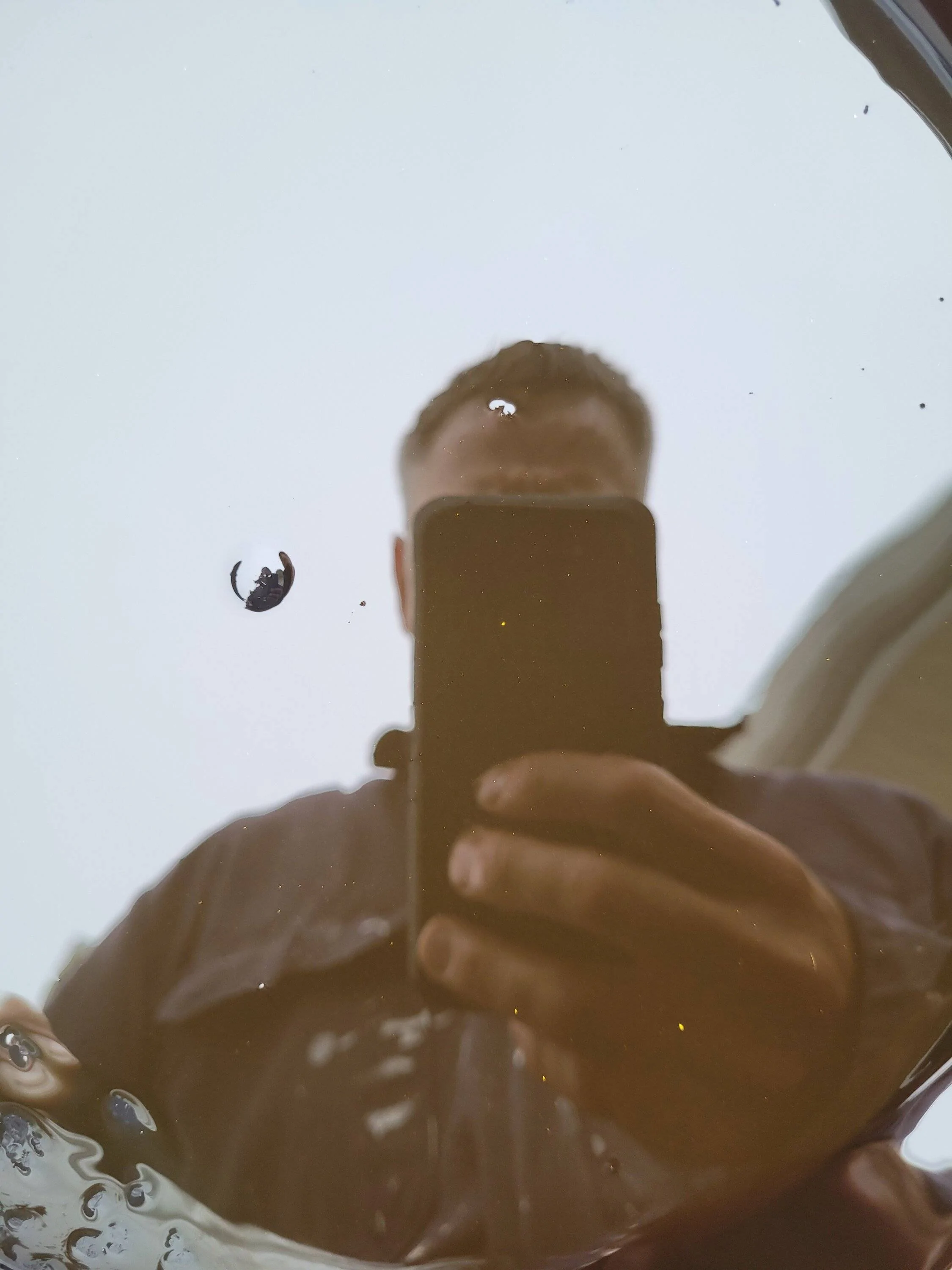

I just did my first oil change at 4100km and approx. 3 months.
The oil itself looked good but I did notice some small metal flakes at the bottom of my oil drain pan. I cleaned this plastic oil pan prior to removing the drain bolt on my Tacoma. I know the photo is not great but this is me, looking down into the plastic oil pan after pouring the approx 5 litres I got out of the truck into a waste container. I stopped just before the pan was empty as I wanted to see what was located. I noticed a number of gold flecks some small, but a couple at least 1mm large.
I'll be doing another oil change at the 8,000km (6mo) mark. I'm hoping this is just usual break in wear, I haven't noticed any difference in the truck since new or any strange sounds.
Given what I found, I'm happy I did the oil change early.
Please let me know if you experience similar...
Update, I cut open the oil filter, same gold flakes found in the pleats of the filter.
