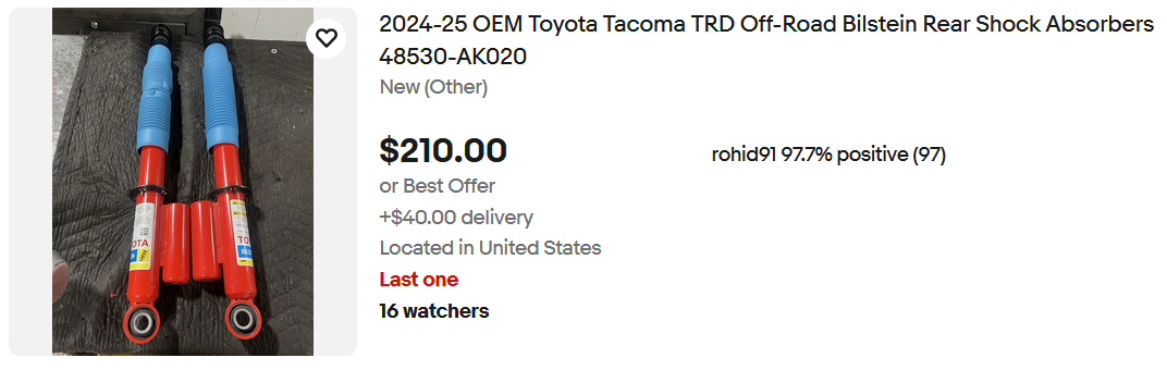

Shocks - Toyota Part# 48530-AK020, tons of places to get them by just googling the part #

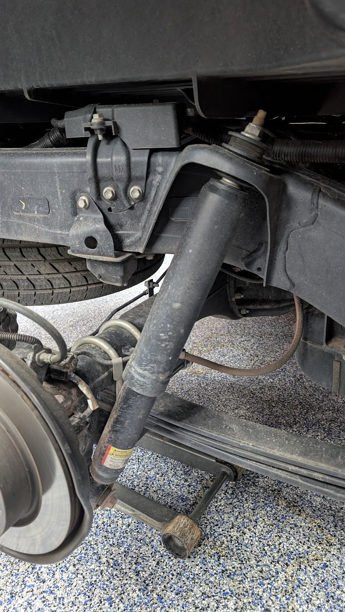

Factory Shock Removal:
2024 Tacoma Xtracab owners - rear shock upgrade (w/ TRD Off-Road rear shocks) makes a HUGE difference! 1756011598575-d5
Top bolt is 19mm, a ratcheting wrench works best. The top bolt will spin the shock shaft so a crescent wrench on the flat part at the top will keep it from spinning.
Bottom bolt is 17mm and comes off easily. A small pry bar can be used to slide the bottom shock mount off the post at the bottom.
The bottom post on my passenger side had a bit of rust on it, which I removed with a wire brush and covered with a little bit of red grease. On my driver side there was zero rust.

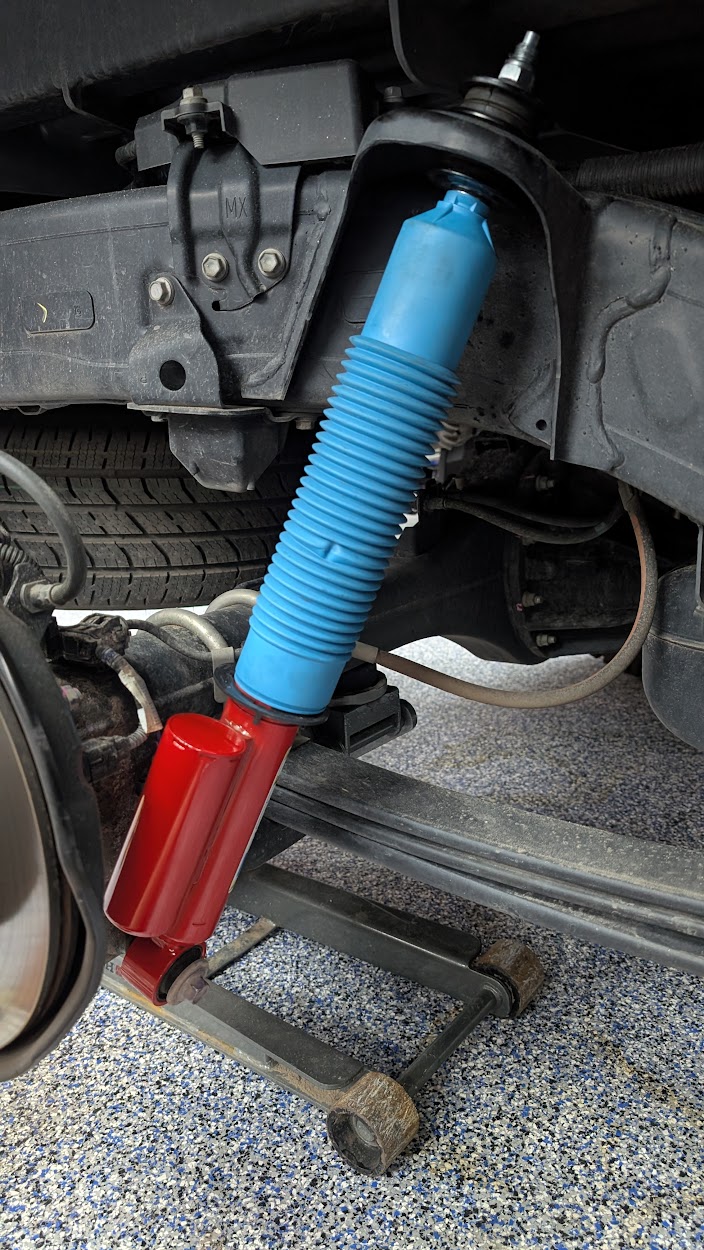

2024 Tacoma Xtracab owners - rear shock upgrade (w/ TRD Off-Road rear shocks) makes a HUGE difference! 1756011784076-i
The shocks came to me with a wire holding the shock compressed, I left that wire on when mounting the shocks. I ran the top of the shock through the hole at the frame, put the bottom shock mount over the post then used a rubber mallet to push it fully on. Before tightening, I used wire cutters to cut the wire holding the shocks compressed. This pinched the wire at the top where I had to use the earlier pry bar to slightly compress the shock, then pull the wire out.
Top mount torque spec: 18 ft-lbs officially. Since you are just compressing those two rubber boots, at some point it will go from easy to tighten to much harder. Stop tightening.
Bottom bolt torque specs: 72 ft-lbs. Tighten then torque as normal.
Total install time for me was about 40 minutes.
