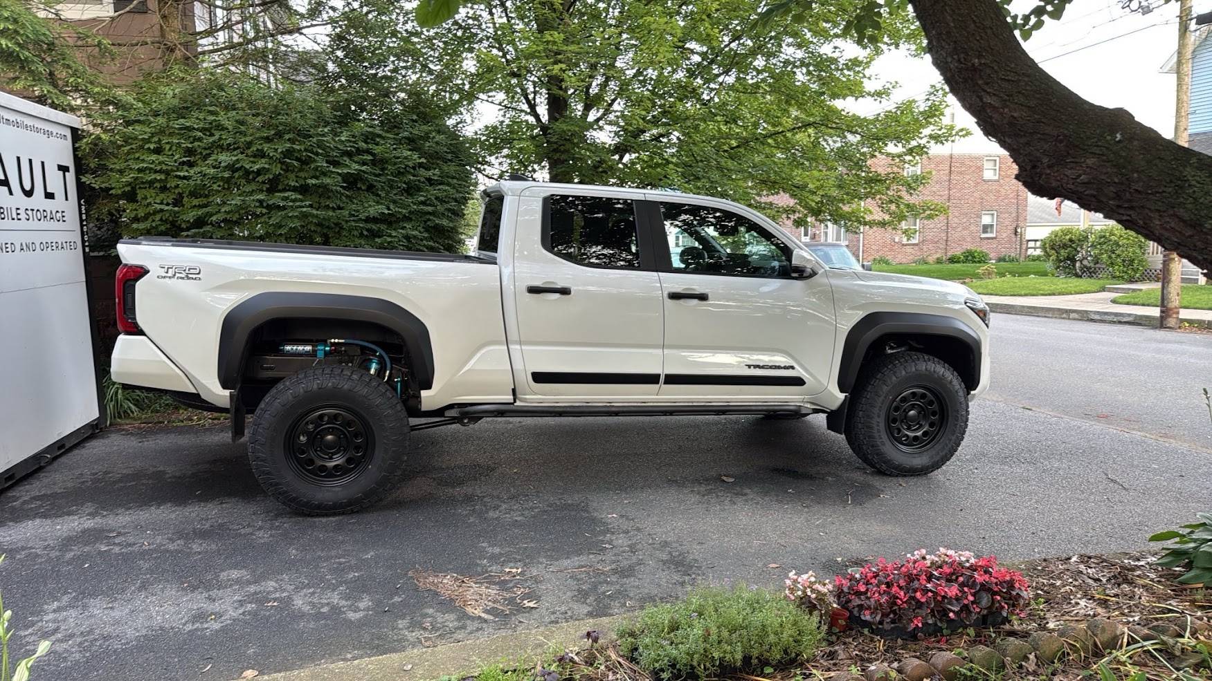

This is such a great thread. Led to me getting the Dobinsons 821s installed on my '24 DCLB OR. Just had the work done so have yet to get all my gear on -- it's crazy how much the rear sits up without any payload, even with a 2.5" lift in the front. Will have to measure, but iirc the guy at the 4x4 shop mentioned about a 5 inch increase on the fender height from stock (of course due to the tires as well.)
2024 Tacoma Dobinsons Coil Spring Rear Suspension Upgrade (C59-819V) Installed on 2024 TRD Off-Road Longbed IMG_1102.JPG
I don't think I'll quite hit 1000 lbs for the payload, but should be close. Was originally leaning more toward 819s, but they've been on backorder for quite some time and it seems like a couple of you guys here are happy with the heavier spring. I hope it was the right choice.
I stupidly ordered a pair of 822 front springs as well (in anticipation of a steel bumper and winch), but turns out they are not compatible with my suspension kit (they should work on a stock setup). Should've called King and talked to them prior to just impulsively getting the springs.
Anyway, I'm past Dobinsons' return window by about a week so if anyone is interested in these, shoot me a message, because they're now for sale. Red, new in box 822s (C59-822R)

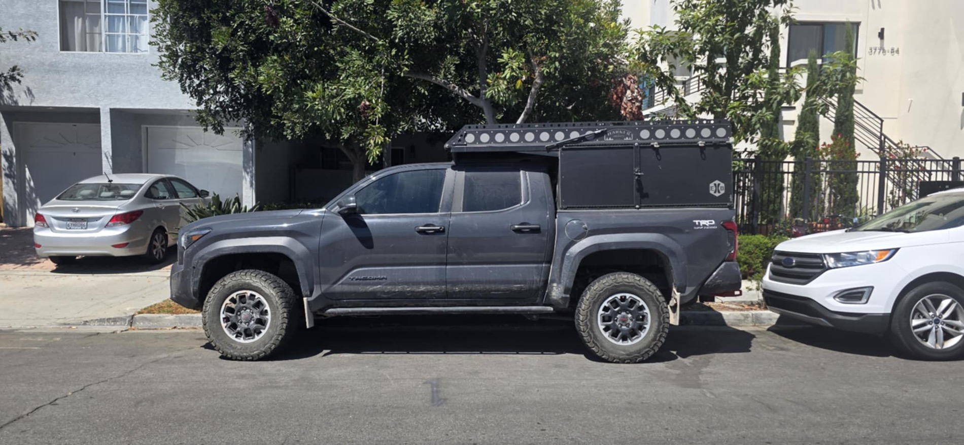

As my truck stands, with 500 lbs of weight in the rear and with the Dobinsons 819.
Front 22.25
Rear 24.5
With additional 100-200 lbs I expect to be around 22 front and 24 rear. So about 2 inches of rake which I love. It keeps my tail off rocks and obstacles as I wanted.
In comparison, when I had the 821s in the rear, my ass was way high even when fully loaded. My stance would have been about 27.5 in the rear.
817 would have been a waist of coil, as it would have been fully compressed and really not helping carry the extra weight. It would have been worse than a spacer lift.
Hope this helps.
