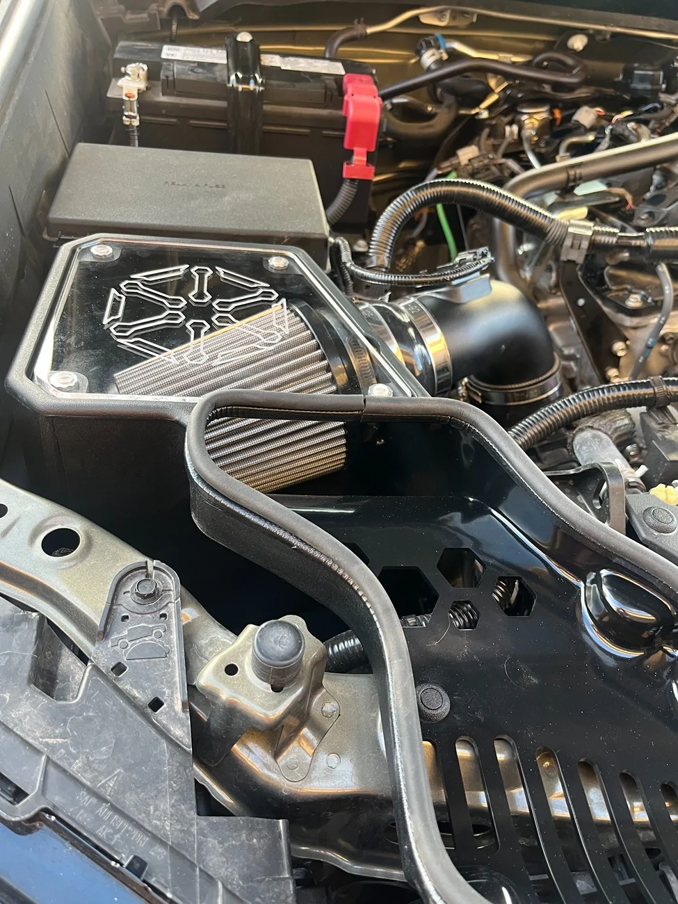

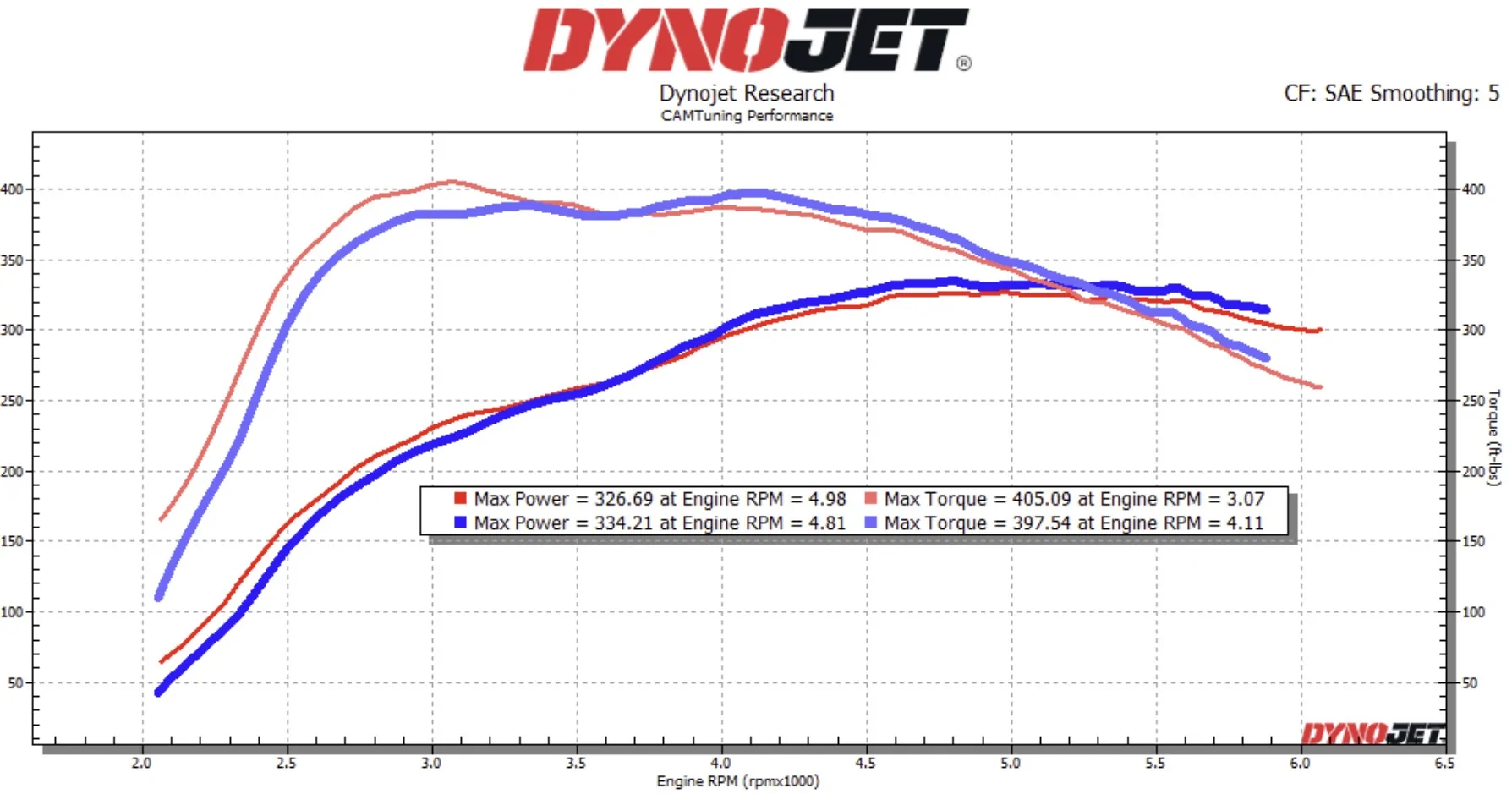

My SXTH Element parts came on Friday and I have the intake on. Drove the truck almost 6 hours round trip yesterday to watch my daughter race districts for cross country (They won!). I datalogged the whole way there on both my tuned map and the stock mapping.
I'll head to our dyno in a couple of hours and do some tuning with the intake, then install the intercooler and do some more tuning.
