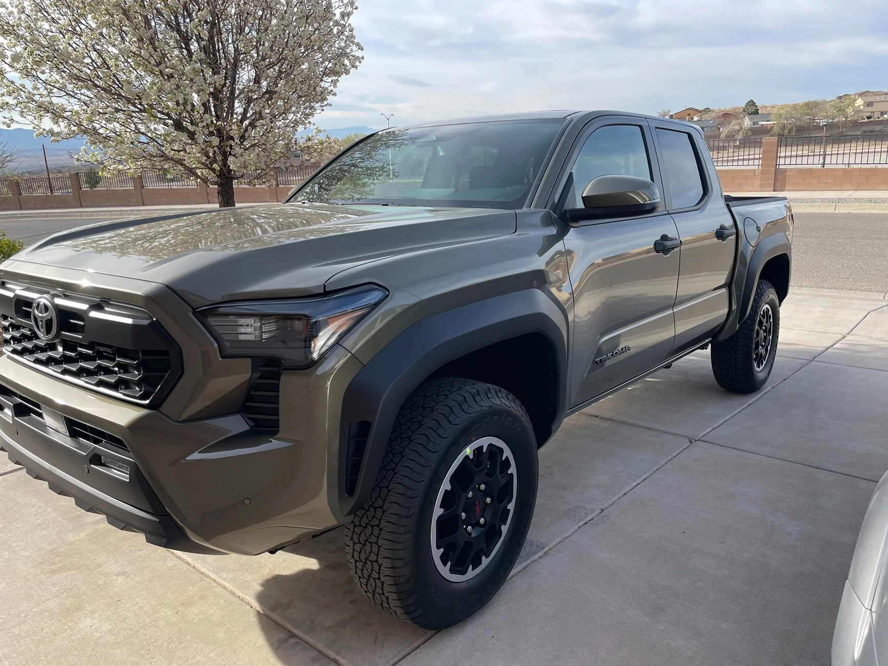

The day I brought it home. My first Tacoma, but one of many in a long line of turbo 4 cylinder vehicles.

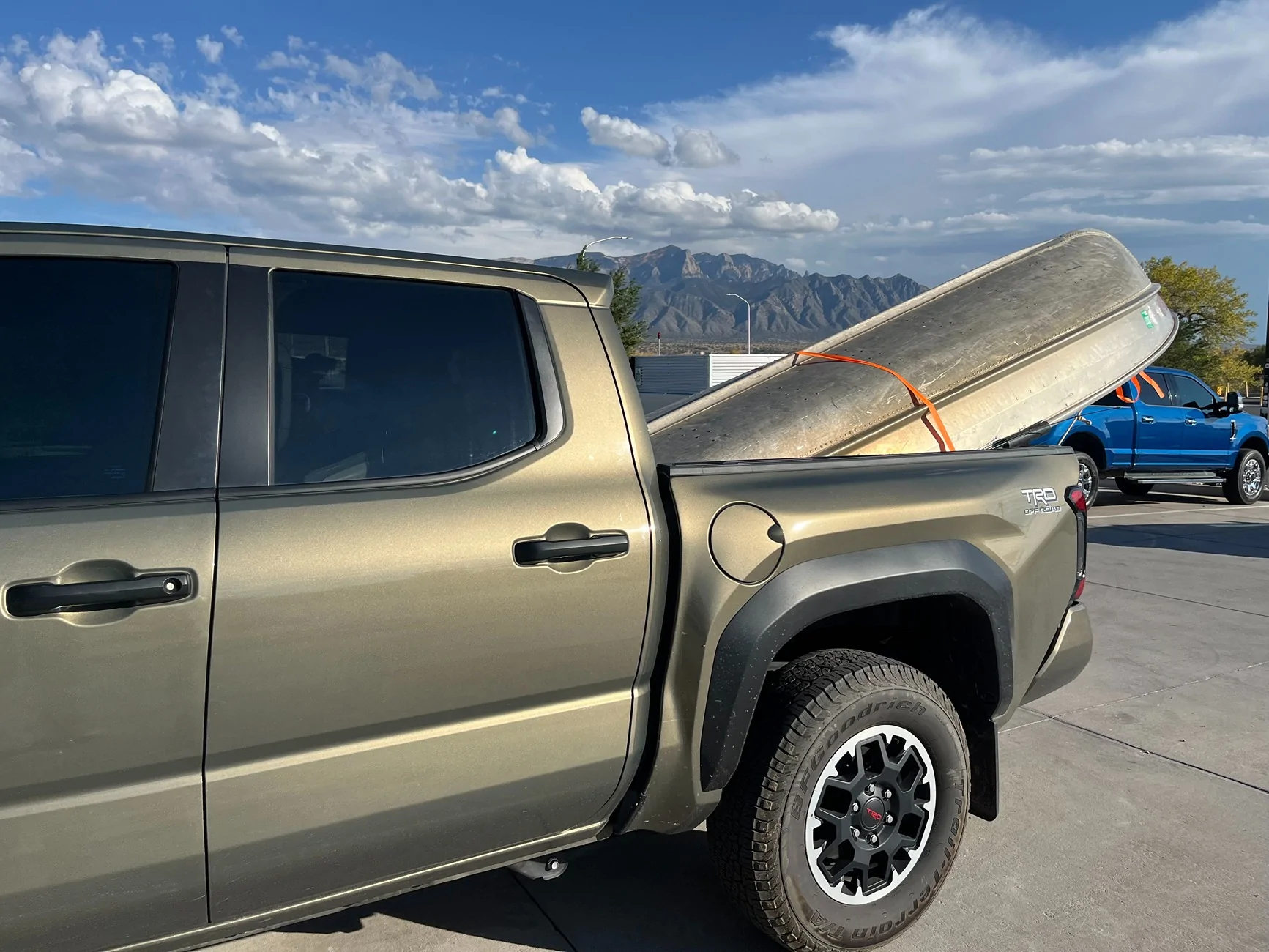

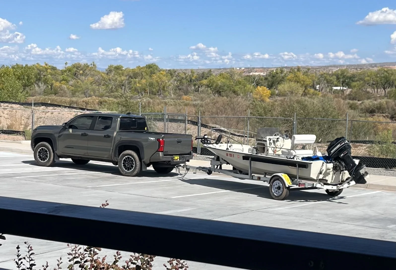

Couple of fishing trips- who says you can't haul in a 5' bed?

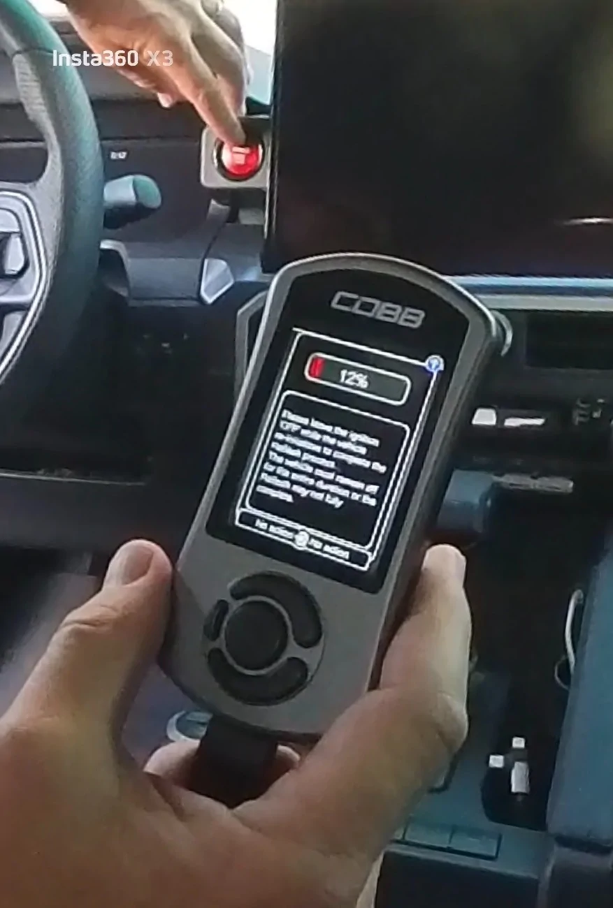

Installing the Cobb Accessport- Exciting day. I've been a Cobb Protuner for over 12 years and believe their software is among the best anywhere.

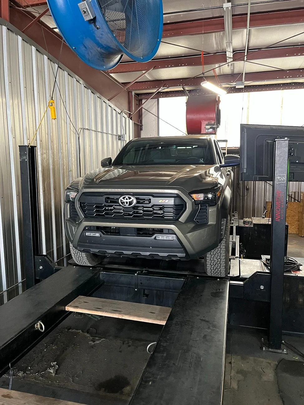

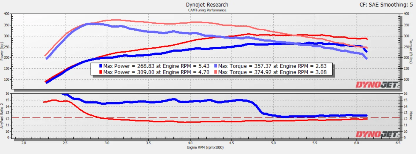

Dyno day! Did some pulls on the stock file locked in 4th gear on 91, and then started custom tuning, focusing first on the awful oem fueling curve. Then kept at it until I was happy with the curves. The gains were really impressive and the truck feels phenomenal. The shifting is so much better with the transmission tuned as well. I remapped the throttle to make it much more responsive, which really changes the driver experience.

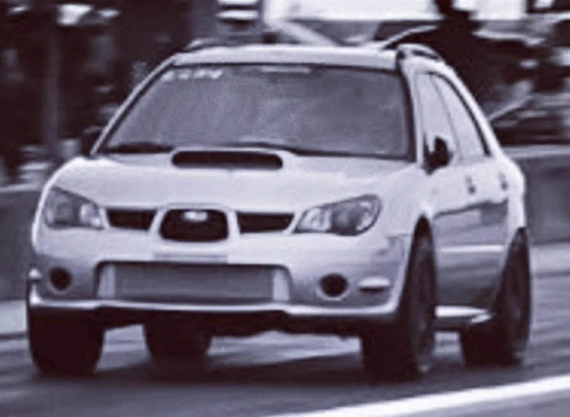

My 9 second WRX Wagon that I still have and drive, just because I know there are some Subaru people on the page!

How much different would you say your custom tune results are vs the OTS maps that come with the Cobb AP?

Great question! I did do some pulls on the Cobb map the same day that I did the baseline on the stock map and my custom mapping. My custom tune made a significant amount of power (nearly 30whp at peak) vs the Cobb OTS map, and that is usually the case across all platforms- remember I've been tuning with Cobb software on Subaru and Mitsubishi for 18+ years . The OTS map is designed to be safe for every truck at every elevation. I'm at 5300', and the factory atmospheric pressure compensations for load control are not perfect. You may not need to touch these at sea level, but at elevation, really dialing in these types of tables can make a big difference.
