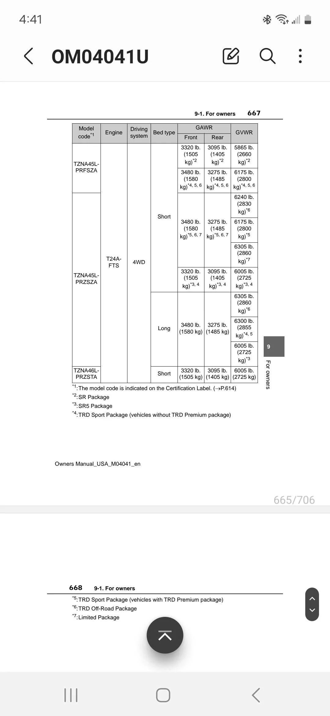

Payload figure from page 613 in owner's manual
GVWR / GAWR numbers from page 665 in owner's manual
Front
Rear
Total
24 Toyota Tacoma TRD-Off Road SB Spec
Curb
5040
Gross/Total Spec
6240
GAWR based max
3480
3275
6755
Payload spec
1200
Payload to GVWR
1200
Payload to max GAWR
1715
2024 Toyota Tacoma TRD-Off Road SB Spec
Curb
5105
Gross/Total Spec
6305
GAWR based max
3480
3275
6755
Payload spec
1200
Payload to GVWR
1200
Payload to max GAWR
1650
BillyJoeJimBob
Nov 10, 2023
43
Idaho
Nothing
2024 Tacoma over sold once again...

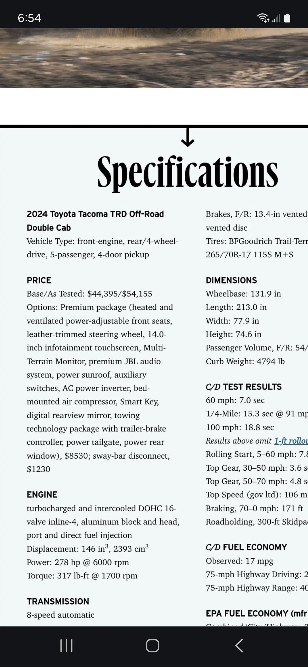

EDIT:
So after some sleuthing yesterday and opening a can of toyota payload worms I think the 24 Taco payload will be much better than 1200. 24 Tundra and 23 Taco listed sticker/manual payloads are hundreds of pounds lower than real GVWR-curbweight. This appears to go for the 24 Taco too.
GVWR for Offroad Taco according to manual: 6240
Curb weight as tested by Car and Driver (with full tank according to their protocol): 4794
Actual available payload for fully loaded offroad with full tank: 1446
Not too shabby, some thing without a premium package and sway bar disconnect may actually be approaching 1600 or 1700. I'll happily eat my own criticism in this case.
2024 Tacoma Payload, GVWR, GAWR Figures for 2024 Tacoma (published in owners manual) screenshot_20231214_164128_samsung-notes-jpg
2024 Tacoma Payload, GVWR, GAWR Figures for 2024 Tacoma (published in owners manual) screenshot_20231215_065438_chrome-jpg
