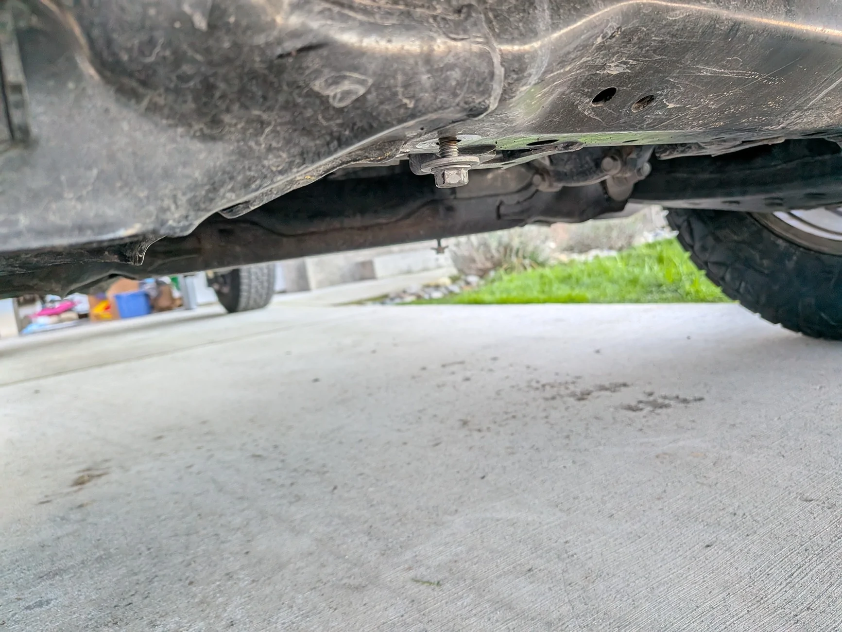

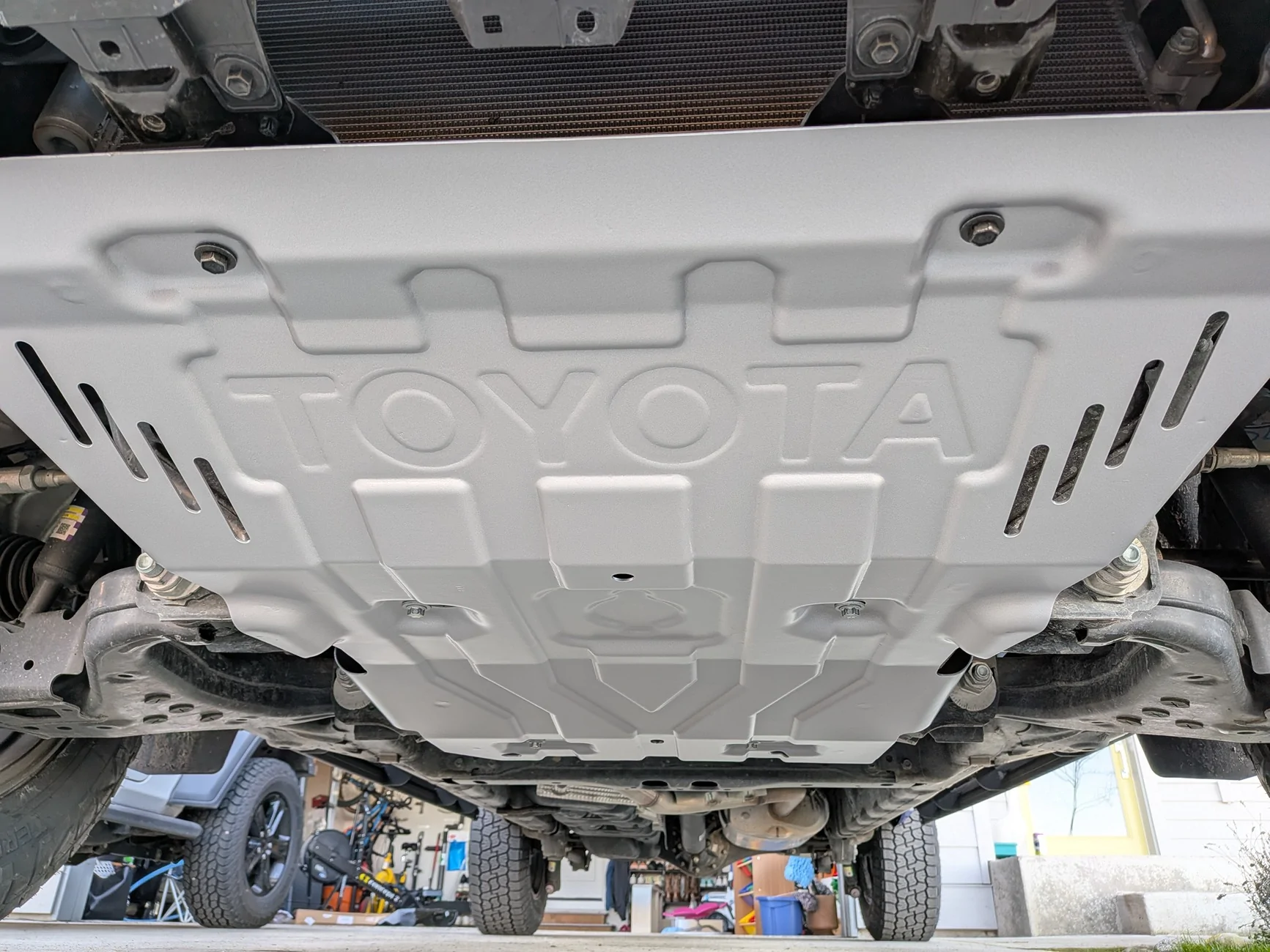

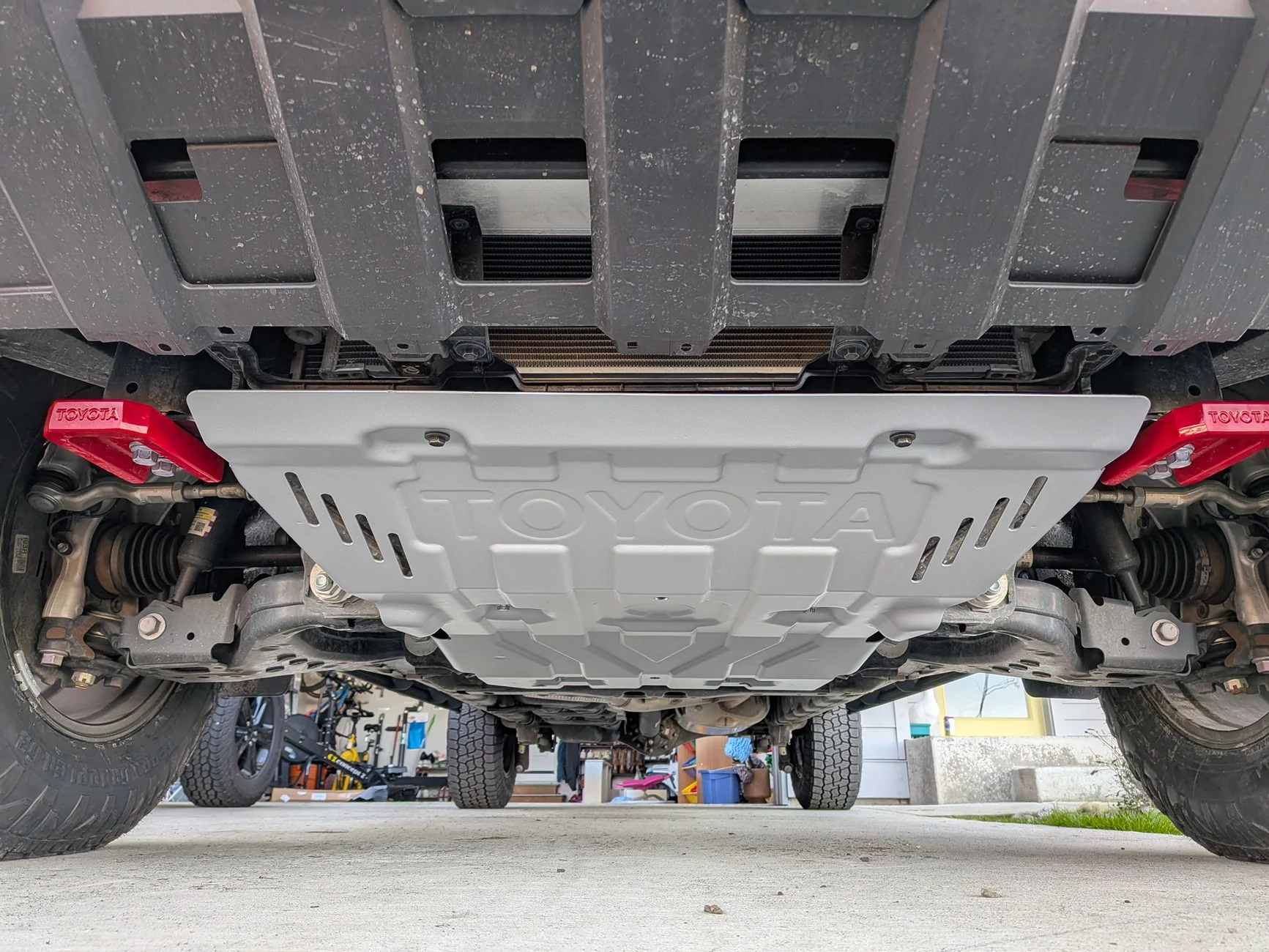

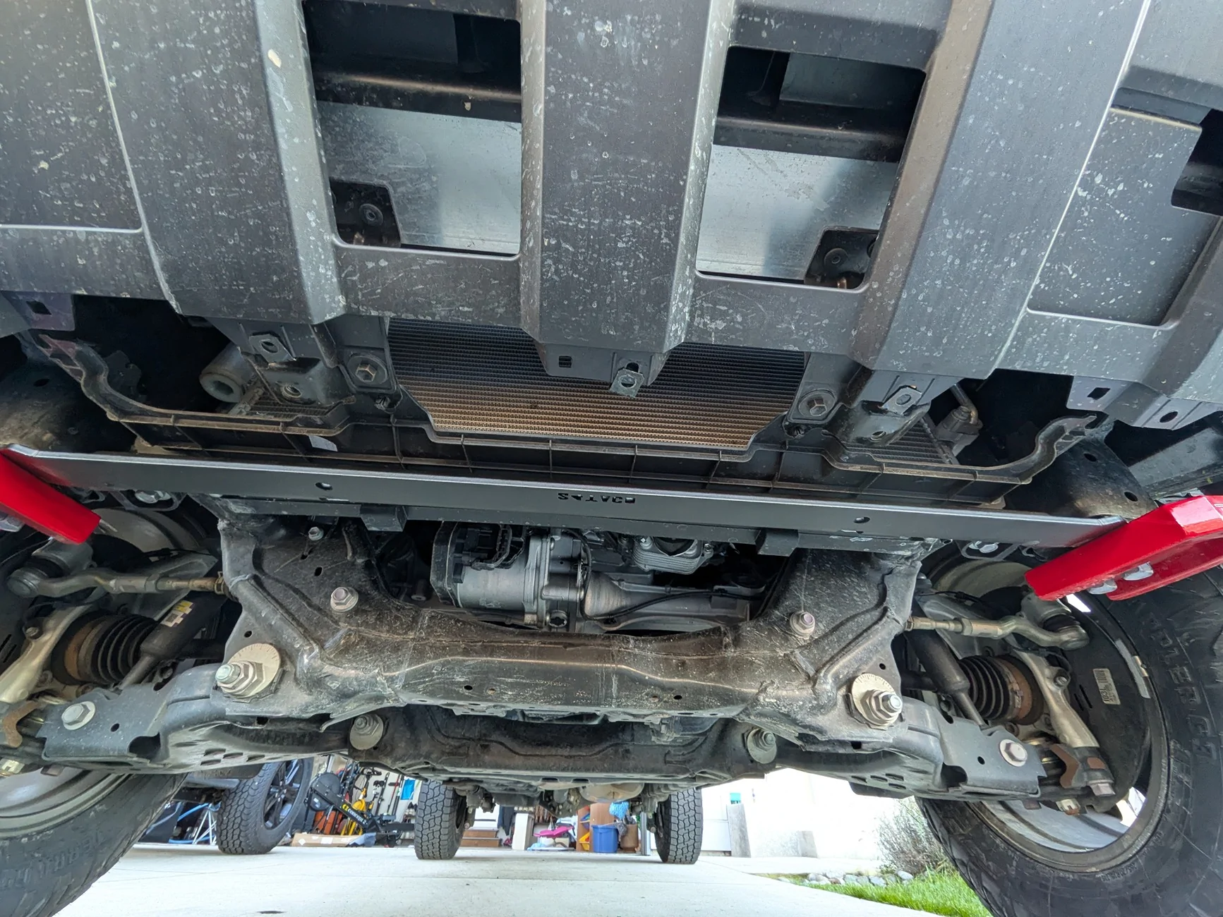

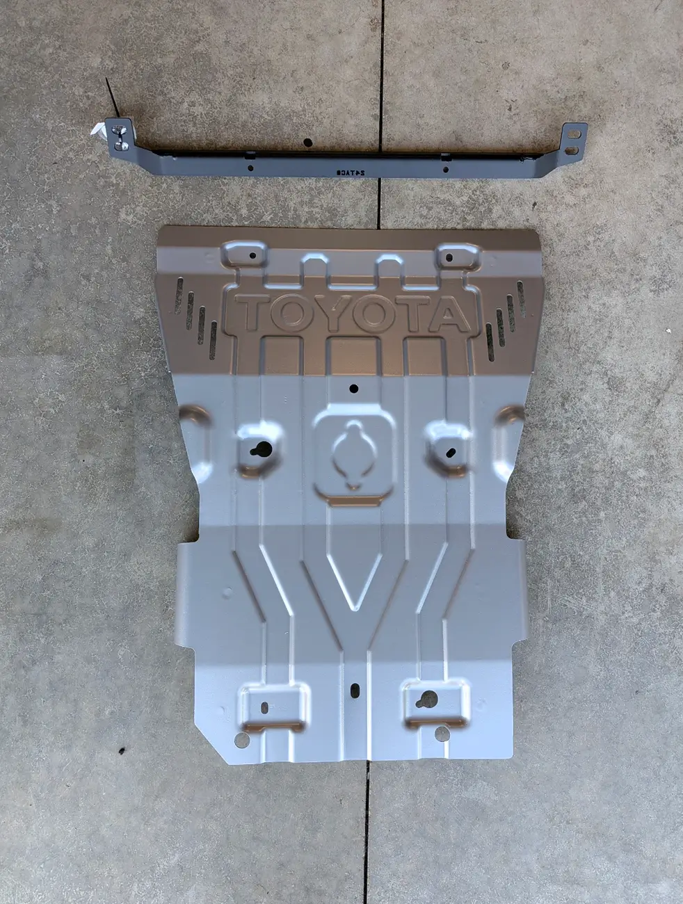

First you need the skid plate (PT228-60242). And then you'll need to order a crossmember if you have a lower trim (SR, SR5, Sport, or the shiney one). I chose the RCI crossmember.
Install the front crossmember as shown below and then tighten it down underneath your front tow hooks to 75#. Loosely install the the two bolts that correspond to the larger mounting point cutouts on the skid so you can hang the plate while installing and tightening the rest of the bolts. Install the remaining 4 bolts. The 4 rear bolts are then tightened to 27# while RCI says the aftermarket crossmember bolts should be hand tightened.
And that's it! Enjoying being awesome.
Landcruiser skid plate and RCI crossmember
Front crossmember installed beneath tow hooks torqued to 75#
Loosely install 2 mounting bolts to hold the skid plate
Skid plate can now hang while you install the remaining bolts
Tighten all 6 bolts. Rear 4 to 27#, front RCI crossmember bolts handtight
Now you are super cool.

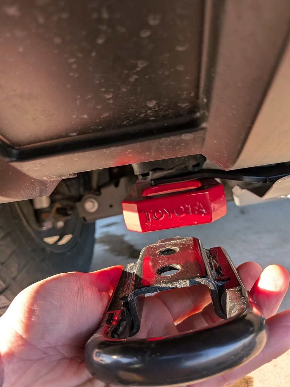

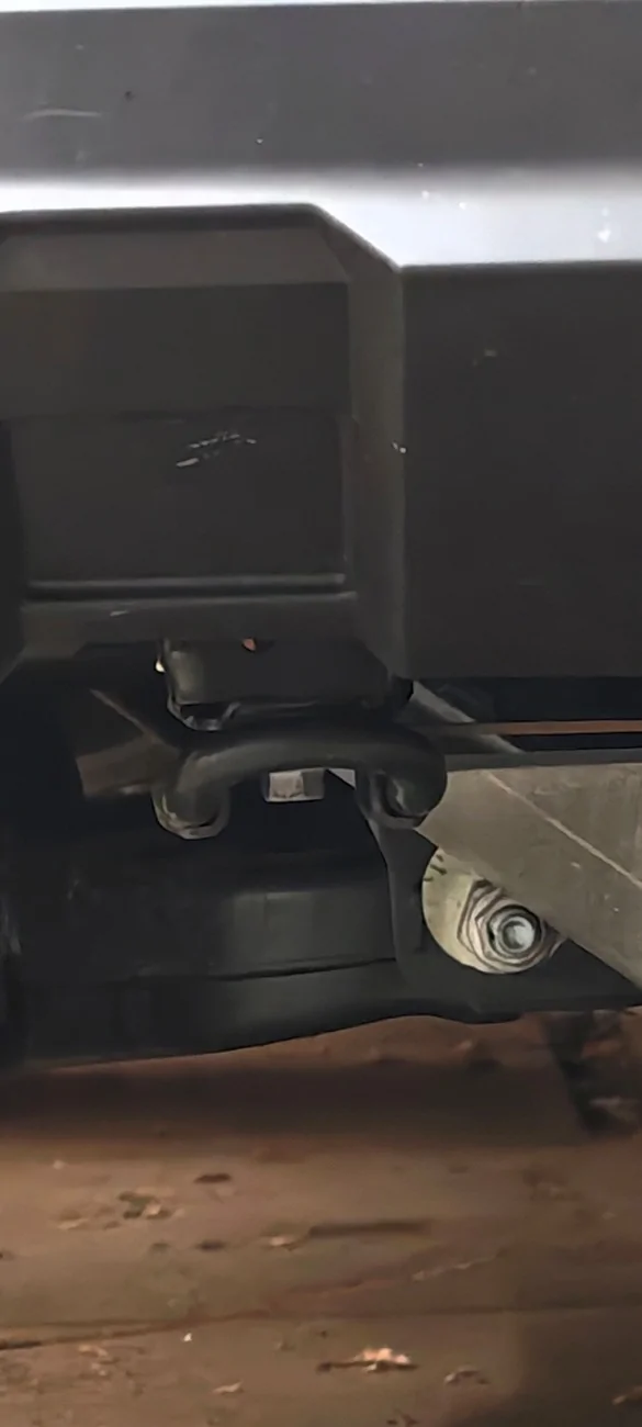

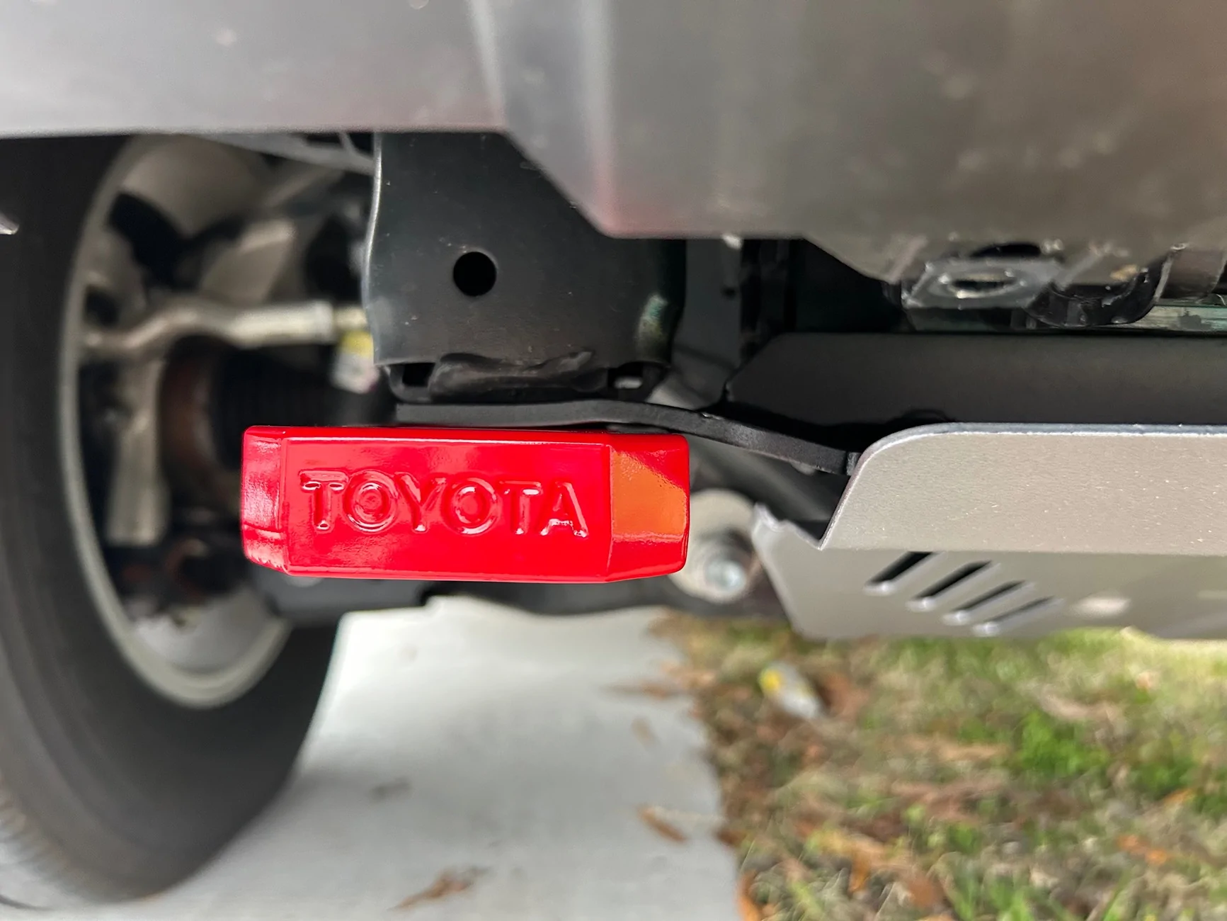

That’s awesome dude. Did you have this when u installed the RCI piece with the tow hooks where it didn’t sit flush, even when you cranked down on it? (Notice the slight wave in the crossmember)
Deleted User 412290
Dec 12, 2025
731
647
Yes I did ! I wonder if this is RCI specific with their design ? Or if anyone has this with the factory hooks and factory crossmember ?
I went back and forth between brands and then victory put theirs on sale for 20% off the day I got this one lol I had been looking at those skids since I brought the truck home
TX-MD
marvin
May 18, 2025
83
AR
Tacoma, 4Runner
Ok yeah. Mine are like that on both sides also. Good to know it wasn’t a “me issue” only. I was a little concerned at first but figured I’m not gonna be hanging the truck by those hooks so it’s probably ok. 😂

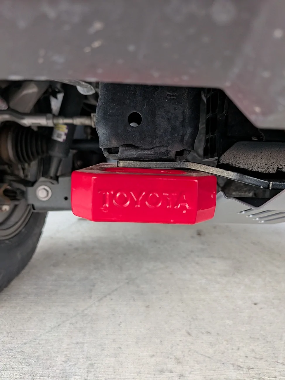

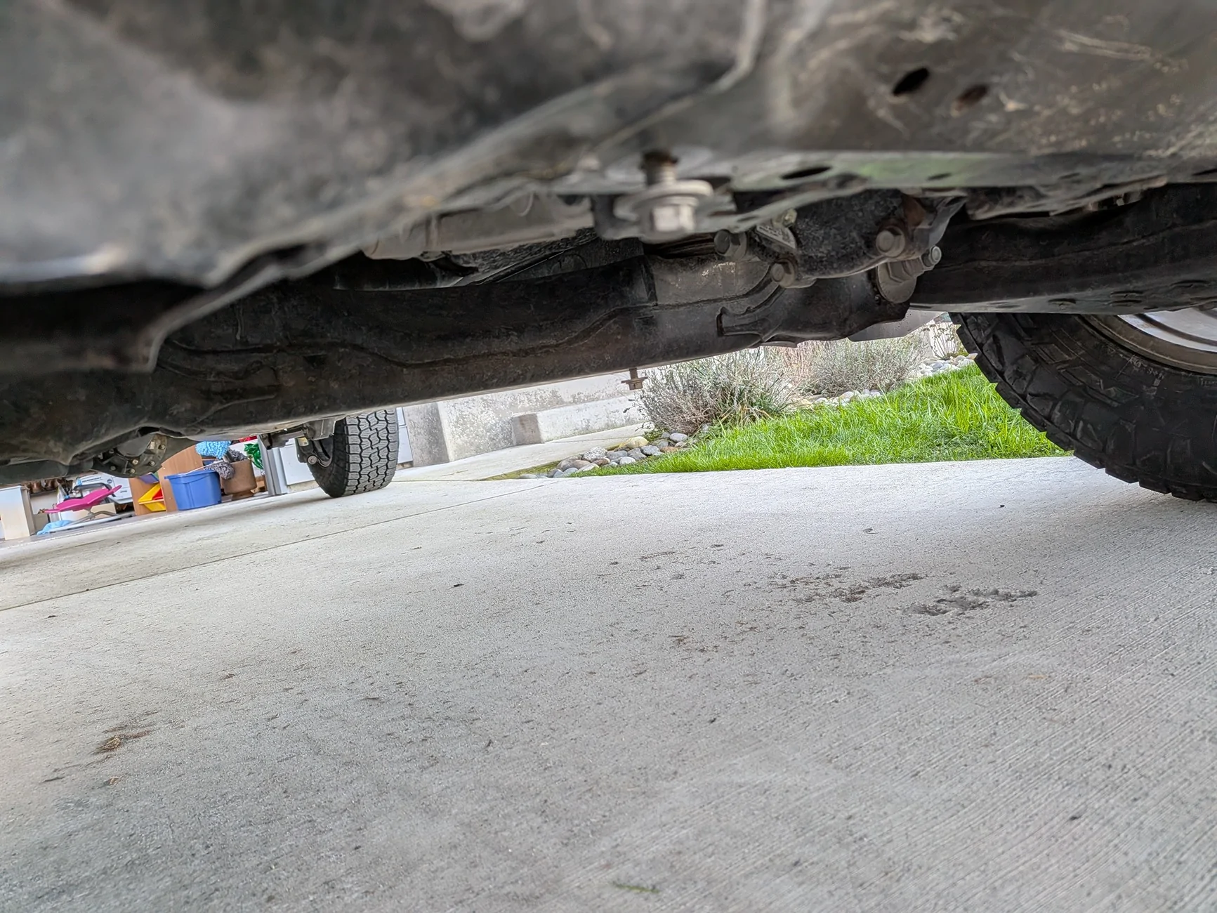

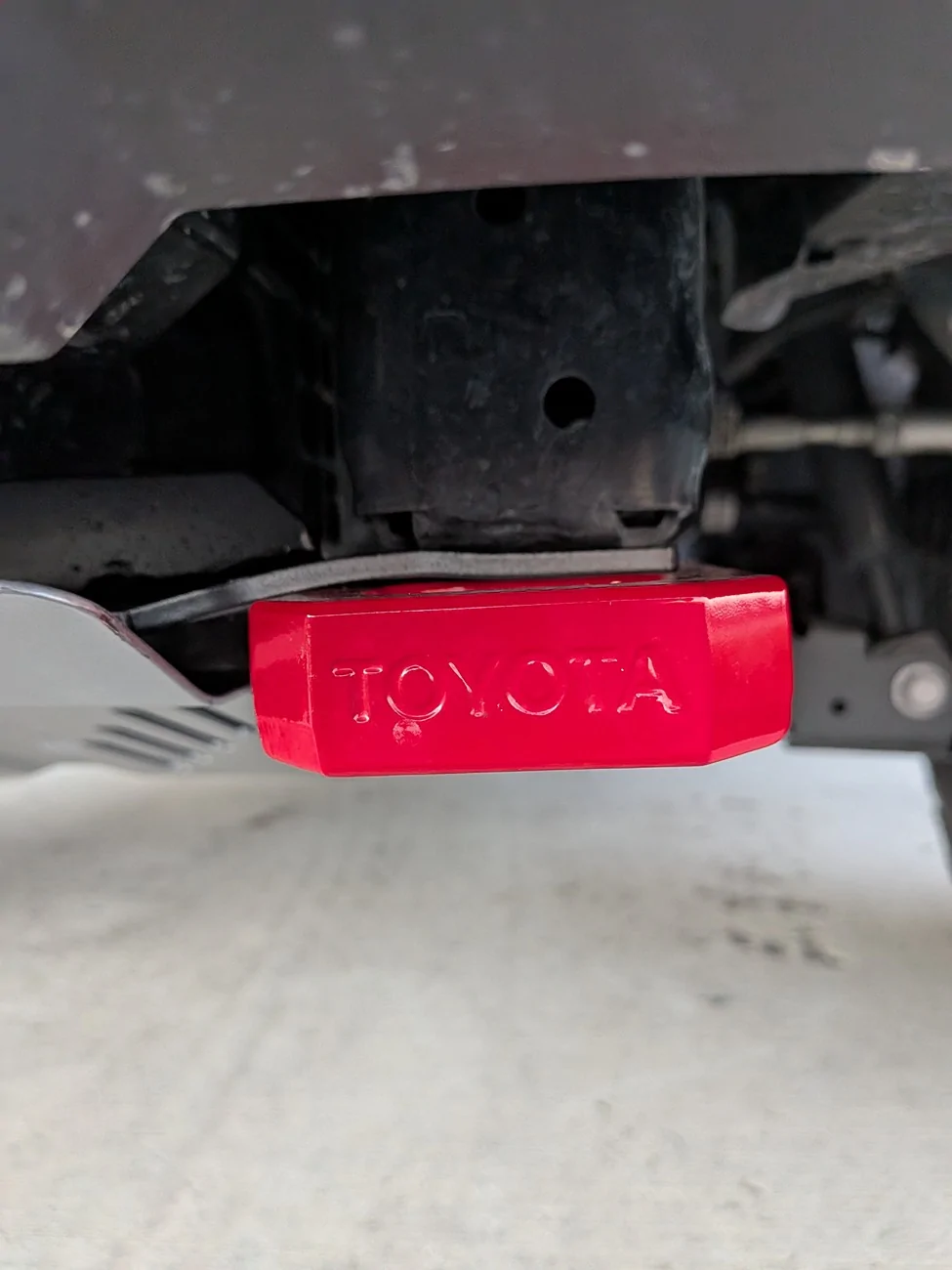

factory hook and CBI front cross member sits flush, sorry for the kinda crummy photo
izzy
Jun 6, 2025
525
510
Bay Area

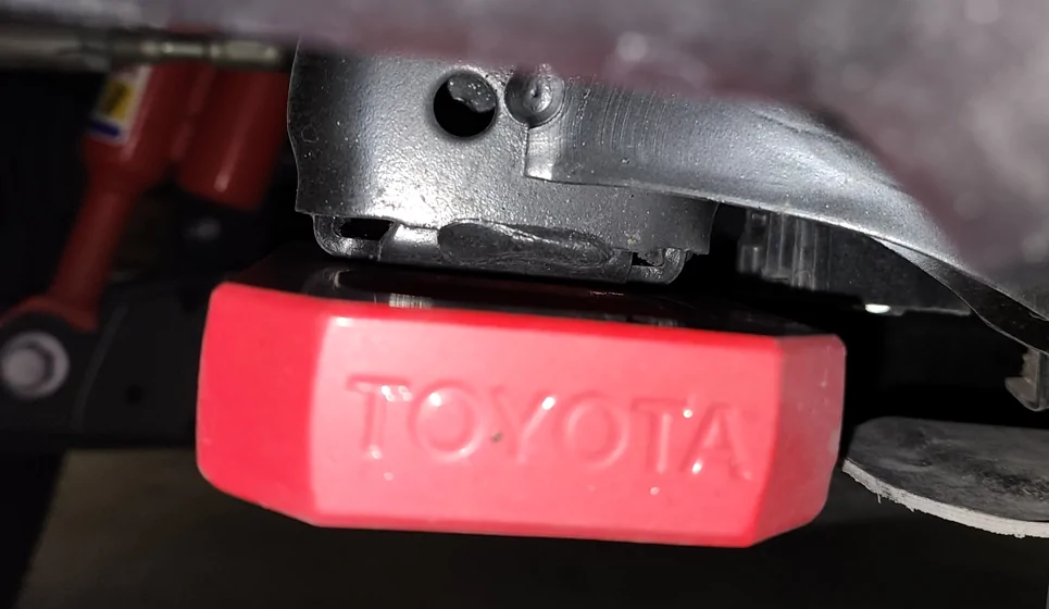

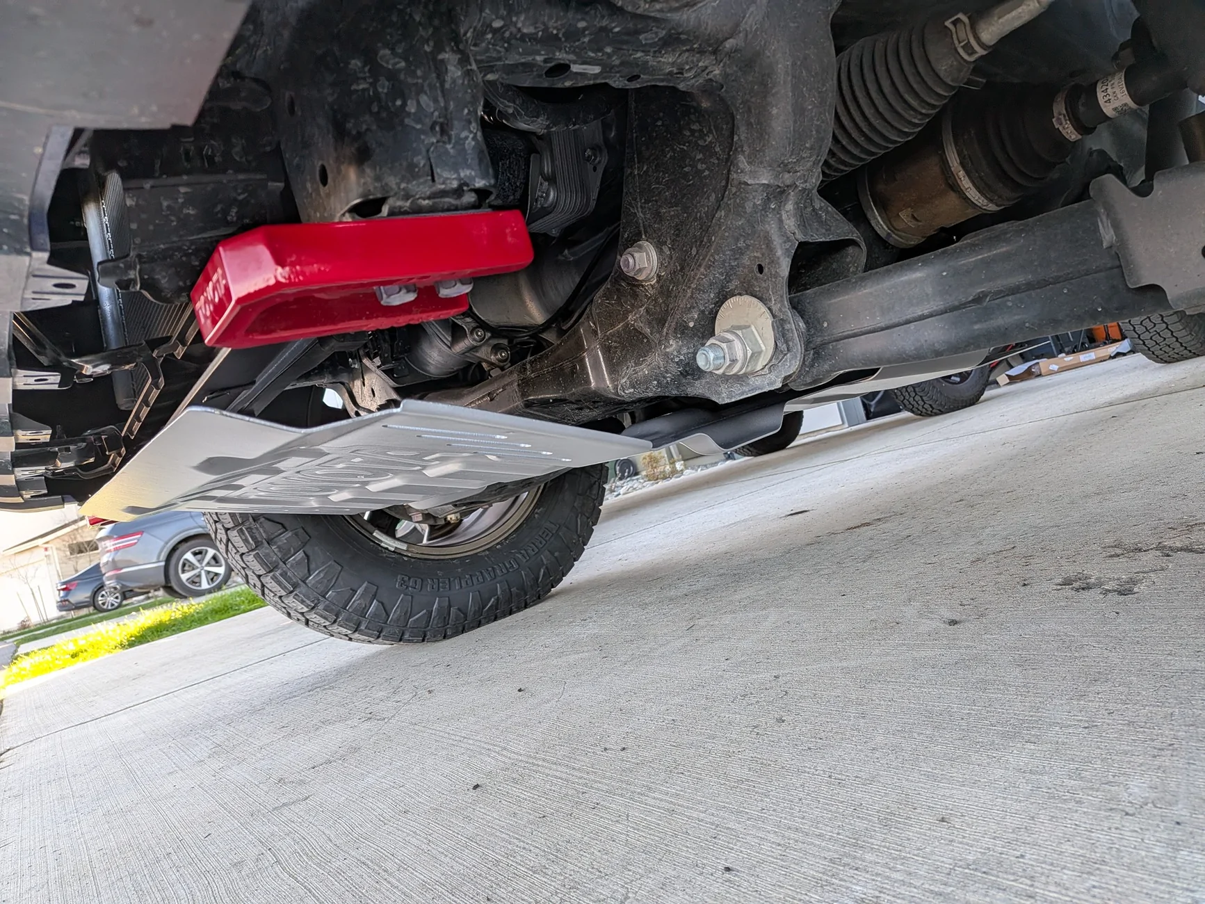

Front red OEM tow hooks have a different design - it's flat across the top
To be honest, it might not be a problem but I'm not sure if I'd be comfortable yanking on the tow hook if it's crooked on the bolts.
Not sure if washers are the fix, probably shouldn't move the hook further from the frame and reduce the threads it has contact on.
Deleted User 412290
Dec 12, 2025
731
647
It's such a small gap, I'm sure it's fine. Torqued down to 75# just fine. I'll be honest, the front hooks are pretty much just looks for me anyways 😂 as my wife said when I I was buying stuff "You really think you're gonna take your shiney new truck off roading ?... Over big rocks and shit ?" Hey hey hey lady... 🤣
Looks like the crossmember is designed to fit perfectly with that stock black hook though!
The OEM cross member does not come that close to the mount point.

I wish they start making the skid plates with access for oil and filter change
Deleted User 412290
Dec 12, 2025
731
647
Personally I'd rather have a skid that's easy to drop than those with access ports. It takes less than a minute to drop this and, for me anyways, I think it's a good habit to take a quick look underneath at oil change intervals.
