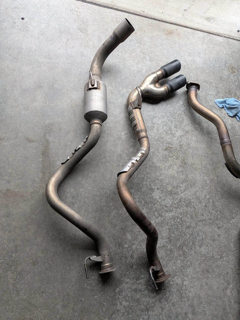

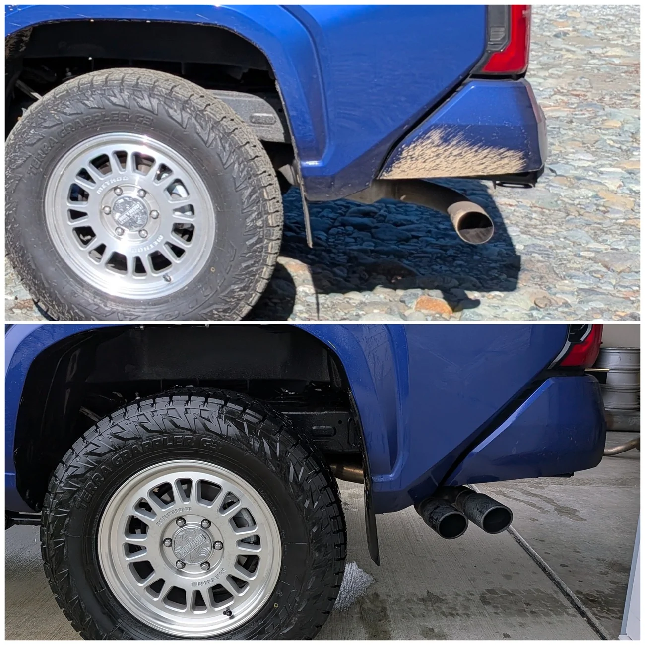

I found a great deal on the TRD center pipe (PT226-35240) + axle back portion (PT226-35241-02) and went in on it with another 4G member so he could get the center pipe and I could get this.
Install is a obviously a breeze: Unbolt 2 bolts, release the hangars, jack up the rear, twist the old pipe out without getting under the truck, put the new pipe in the same way, lower the truck, put the new pipe on the hangers, put the two bolts back on, tighten. 10 min job.
Been considering this for a while and all I can say is, I should have done it sooner! It provides the perfect growl at start up as well as when you step on it, but it is otherwise pretty quiet. I hated the sound of the axle dump near the cab, but this is nice and refined. Not too much, not too little (to my ears anyways). Looks good and fits the long bed just fine.

Definitely an upgrade over the stock exhaust, it also looks like it doesn’t hang as low as the stock tailpipe.

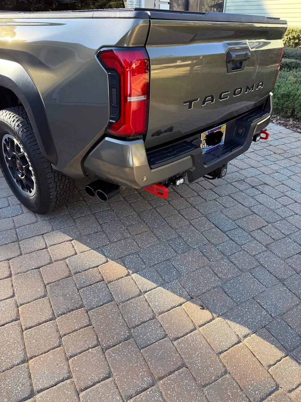

Installed mine about 2 months ago (no center pipe add) and very pleased with looks and sound. The current 40% off sale price is outstanding but when I ordered mine last November during a similar sale it ended up taking almost 3 months to deliver. Happy otherwise.

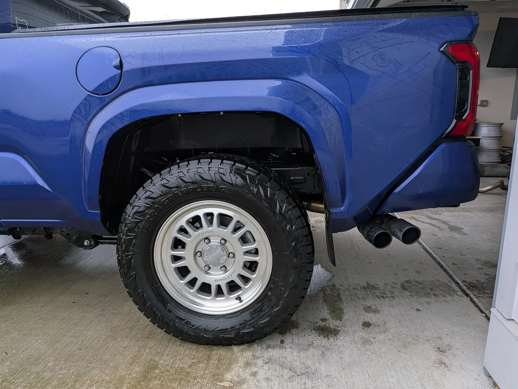

Big thanks to @PNWkip for scoring a screaming deal on the TRD Performance Exhaust and then selling me the center pipe section!! I've had the tail pipe section installed for a while now (more than 10k miles) so I have a good feel for how it sounds. I installed the center pipe section yesterday and I'd say the sound is a little deeper and maybe slightly louder at idle, but honestly the change is very subtle. If the tail pipe added 10% more volume, then the center pipe adds another 5%. I haven't driven it much yet, but I haven't noticed a difference at wide open throttle. It seems like the change is at idle and low RPM. I'll update with additional thoughts after I've driven it some more.
I'm not the best at these kinds of videos but here's the center pipe and tail pipe installed. Cold start.
