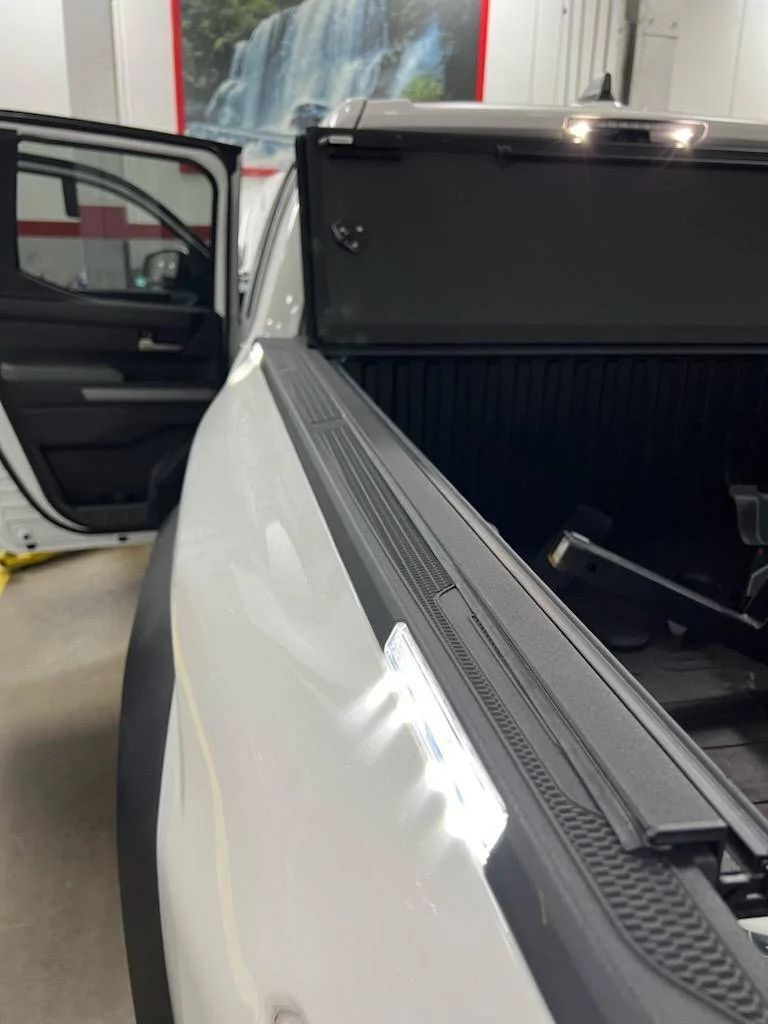

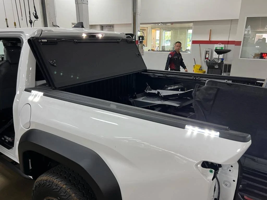

Well, the news isn't good so far. Alternator relay and all the fuses are good so there's power. It's just not getting back to the cargo, bed and bed scene lights! They are tracing wires now and keeping the truck for a second day.
brentbba
Brent
Jun 20, 2024
234
218
2024 Tacoma Trailhunter
Ok, not sure of the part back in the bed, but it had a loose wire and needs replacing. Of course being brand new production, the part is on backorder. They've patched it up and the lights are working. Now they have to put it all back together until the part arrives the
take it apart again. It's taken them a full day to find the issue.

Ok, semi conclusion. The driver side bed scene rail has a short and it was taking out both rails and all the cargo and interior bed lights. A new ds bed rail with the bed scene lights is on order. They've just left the ds unplugged for now and all the other lights work. I can't imagine the bill they sent to Toyota for the time to take apart, trace the wiring and put it back together!
