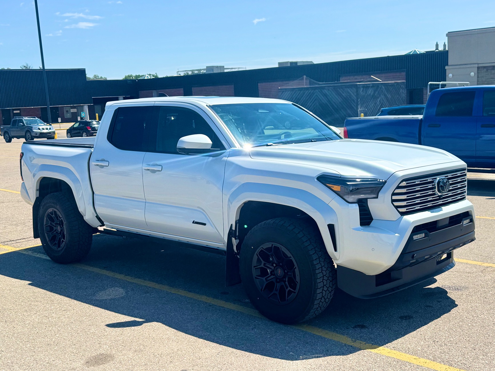

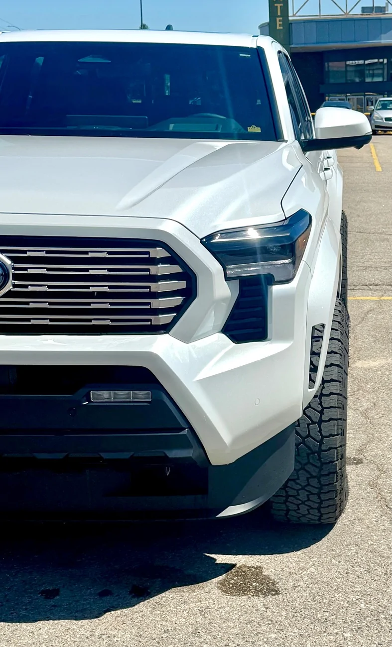

2nd time Tacoma owner. I loved the All Wheel drive aspect of the Limited but I hated the chrome. I also REALLY like the Wind Chill Pearl colour.
Here are my before and after
BEFORE
After

Do you know how much the front lower bumper was to replace? Also did it mess up the camera, thinking of doing this mod.
Eesh29
Eesh29
Jun 3, 2023
83
62
2025 Tacoma Hybrid Limited
This is the part number for the Black lower front bumper.
53931-AK050Extension, Front Bumper$216.35 CAD
I did it myself. So ya it cost me $216.35 Canadian. It does not affect the Camera in any way because the Camera is mounted in the upper grill.

Eesh...I am going down the blackout path on my 2025 Windchill Tacoma Limited and really appreciate your post and the part numbers. The last two items on my list are the bumper extension and tailgate handle swap from chrome to black.
I captured the following part numbers from your post:
  • Tailgate Handle (Black) p/n 76839-AK02
  • Bumper Extension (Black) p/n 53931-AK050
I have not found a video/images on the actual removal/replacement of these components yet. On the tailgate handle, were you able to access the handle from inside the tailgate, disconnect the camera and light, and swap the handle piece without any camera reset procedure?
Similar question wrt the bumper extension....were you able to move the existing sensors to the new part seamlessly or was there some recalibration activity after the new extension was installed?
The tail gate handle part is just a shroud that clips on. I just used a screwdriver to pop the old one off.
As for the bumper extension….. I ordered black sensors. Unfortunately I don’t have the part number for them. I did have to get them calibrated at Toyota. I believe the 2 sensors were around $120 Canadian each and the calibration charge was ridiculous….. $630 Canadian…. I was not happy.

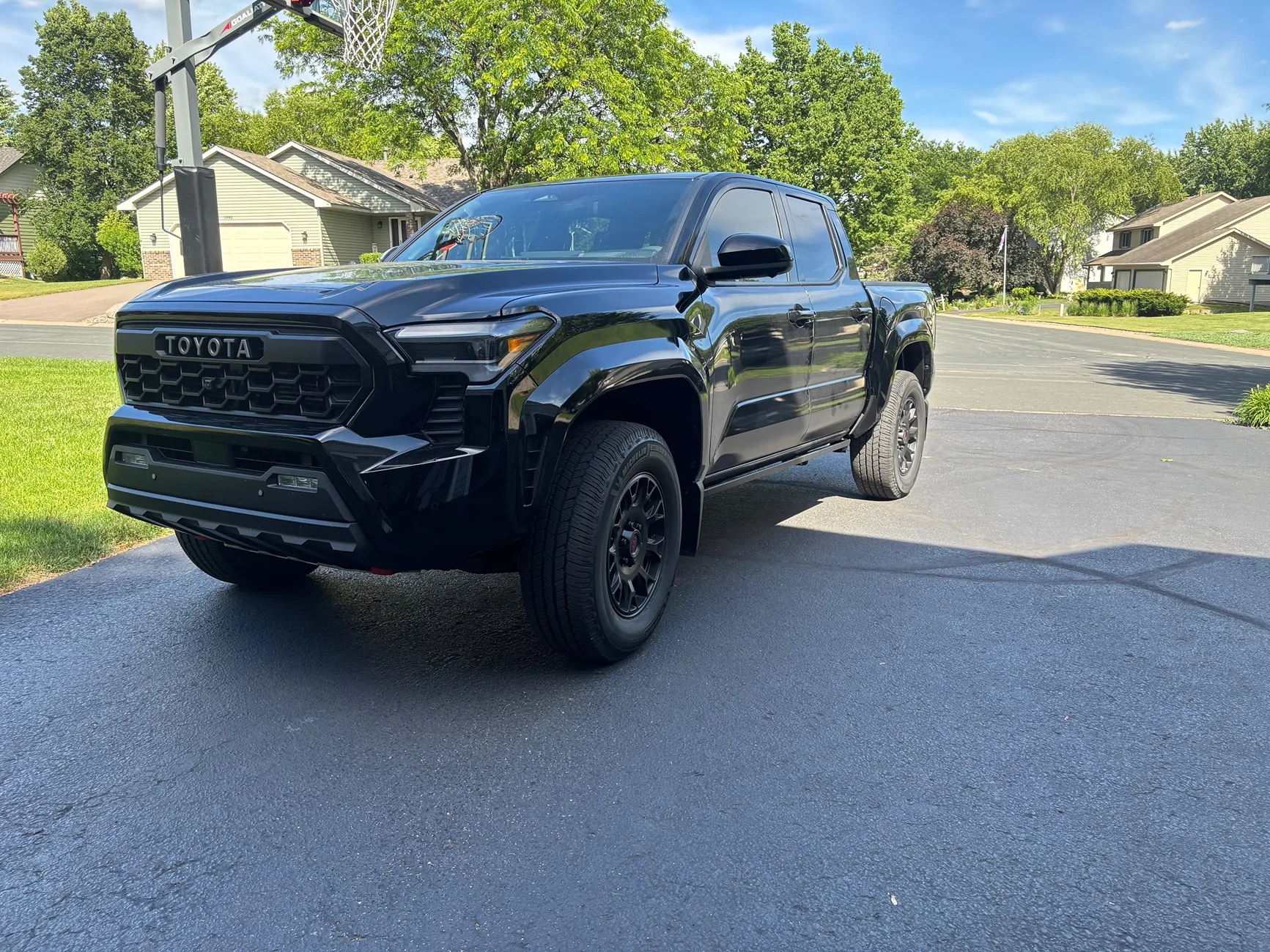

I just finished completely blacking out my 26 limited. I can help too.

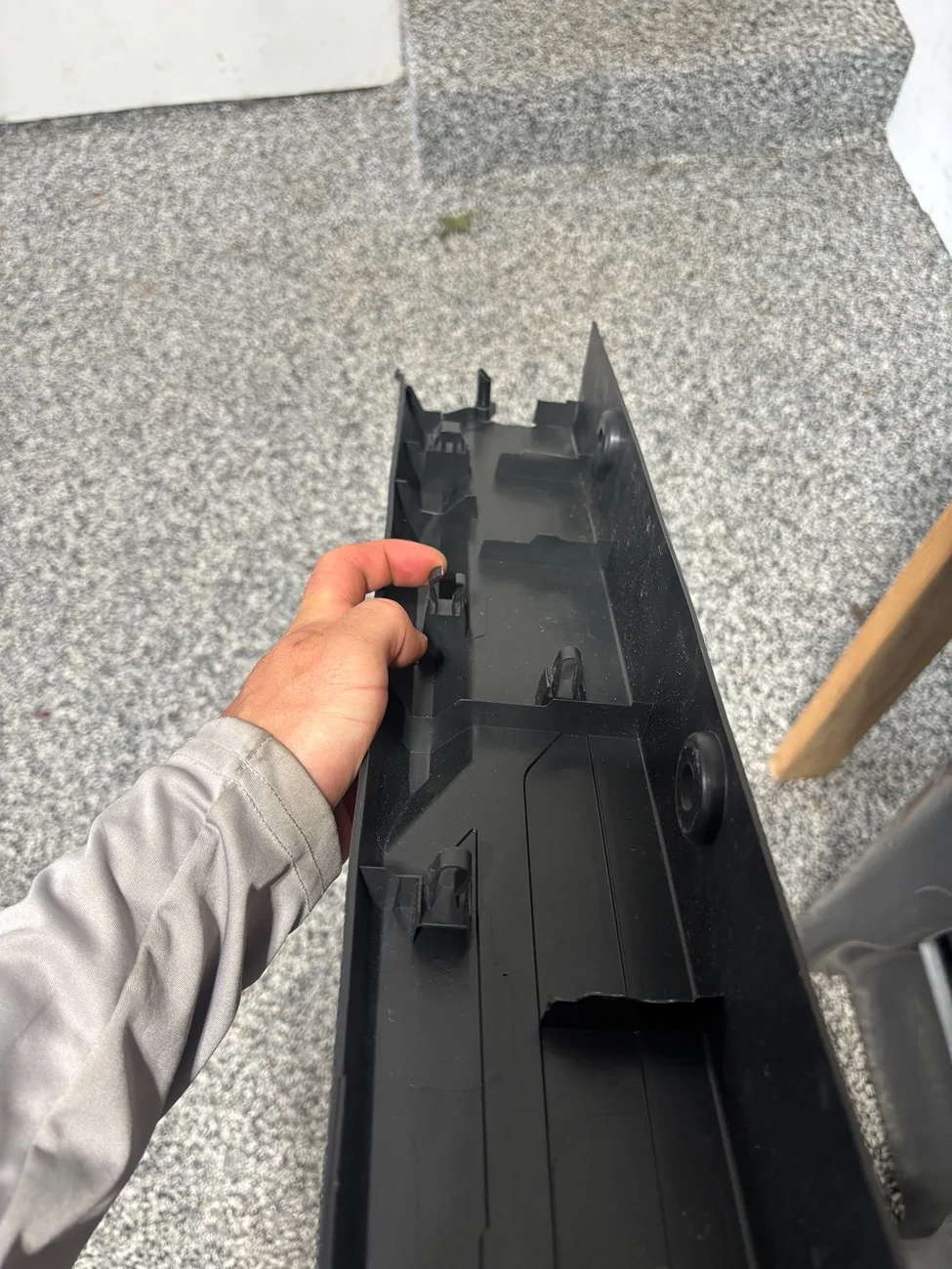

For tailgate handle, you’ll need to remove the inside panel of the tailgate as well as the top of the tailgate. It’s pretty self explanatory, a handful of screws for each. One caution, be careful when pushing this top piece back on so you don’t bend and break these tabs. I did and it didn’t fit tight so I ordered a new one.
As for lower bumper, I reused my sensors, the chrome IMO doesn’t stick out that much. Be sure to order two of these, 89348-04010-C1, they’re sensor self adhesive mounts that you’ll need to stick the existing sensors on the new part.
