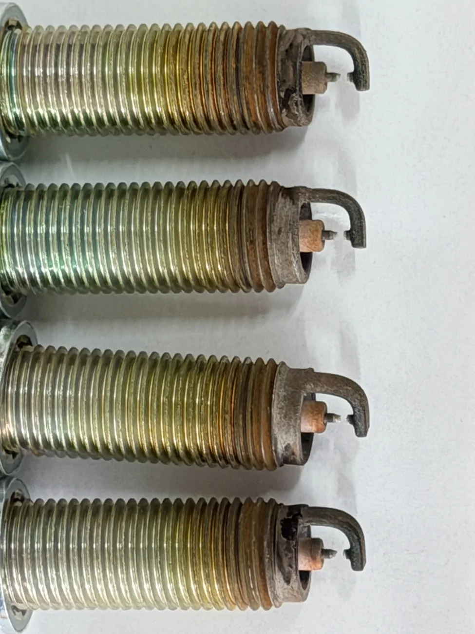

Technically 40,500 miles but it's not like that 500 is going to make much of a difference. These things are so easy to replace. To my naked eye it almost looks like some might be a fraction of a millimeter off but it could also be my eyes playing tricks since the electrode gap is so small and I'm fairly confident the mixture is running normal--though not sure what it's supposed to be. I don't know if anyone's hooked up an afr guage. I had one from my Subaru days but I'm not interested in installing it since I'll never have a tune. I just wish Toyota would let NGK sell these separately because at $30 each, they're 3 times more expensive than the NGK Iridums were on my old Legacy GT (granted these were far easier to replace).
For those wondering, the plugs are part# 90919-A1008, I purchased mine at a local dealership for $29 each. You will need a 14mm deep socket (spark plug socket recommended so you don't have to pull them out with a magnet).

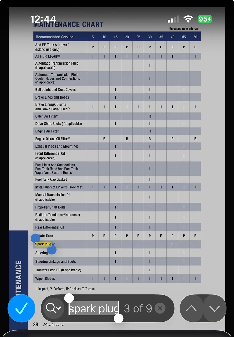

does oem recommend changing them every 40k? where can i see the maintenance schedule

Just did mine a hair shy of 39k miles. Dealer wanted $419 to do it. Just wanted to jump on here and say please don’t anybody pay that! All the plugs are easily accessible and even if you pay full price for them you’ll still save yourself $300 over letting the dealer do it. Plus they stripped out one of my skid plate mounts doing an oil change so they suck for that too.

I did mine at 32K. They looked worse than yours.
