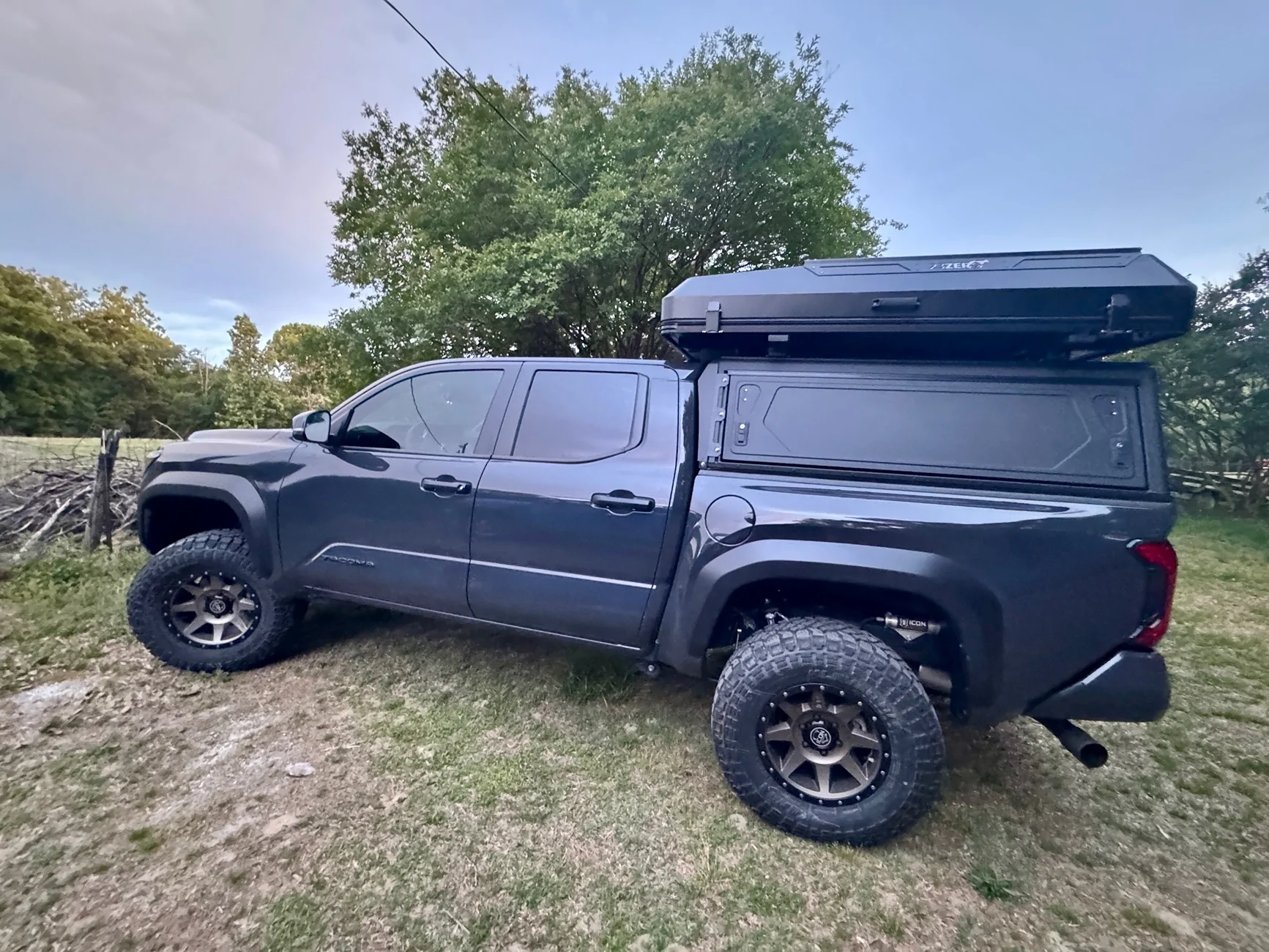

Hello everyone! Just got this truck a few weeks ago at 8k miles. It was already built out about how I wanted to build one. I’ll change a few things to how we end up using it. The main functions are getting to places where we are backcountry fly fishing, a mobile fly rod building workshop, hiking, trail running, mountain biking base camp.
I’m looking to make it more efficient and functional (and get better than my current 14.7mpg). I’m considering a tune and or CAI to help with this but don’t know much about them so I’m in the research phase. So any guidance and/or recommendations welcome!
Build details when purchased:
- ICON 2024-2025 Toyota Tacoma 1.25-3" Lift, Stage 3 Suspension System, Tubular, Triple Rate Rear Springs w/ Overland Rear Springs
5 wheel/tire setup
-ICON Alloys Rebound, Bronze, 17 x 8.5 / 6 x 5.5, 25mm Offset, 5.75" BS
- Kenda Klever RT 285/70r17
- 23Zero PEREGRINE PRO 5 ARM 270 DEGREE AWNING
- 23zero Armadillo Horizon 3 Hardshell Left open
- Decked slide out drawer w/premium accessory pack
- Alu cab Contour truck cap 5’
- ALU-CAB LOAD BAR 1250MM KIT WITH STANDARD PROFILE FEET
- Wolbox G900 Tri Pro digital rearview mirror. Dash and rear cam (need to set up the front facing trail camera)
I’ve got less aggressive and lighter tires on order. A friend that owns Send It Overland here in NC (he’s the one that built the truck for the original owner) recommended some Kenda Klever AT2 255 75r17 that I’ve got on order and will install next week. And I’ll hopefully get the tpms sensors to work too.
I’ll probably get a trail pipe exhaust delete pretty soon. Considering some rock sliders and skid plates. First trip to CO is in July. Going to do a shakedown here in
NC soon.
That’s all for now!
2024 Tacoma ‘25 TRD OR underground overland build IMG_9556

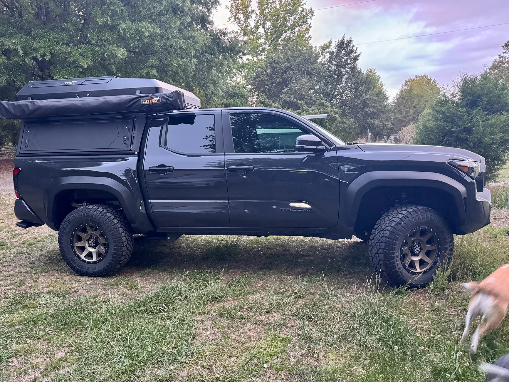

Hey guys thanks. Good thoughts. I posted over in another section asking some questions. Hopefully cam will see that. I’ve seen his detailed threads and it’s really interesting how much data he has.
Agreed on the tent. It’s a sail! I think if I had to do this from scratch I’d do an integrated topper/tent. Regardless I love this setup.
As far as I know the rake is ok. I’ll post a photo that’s not on a slope.
2024 Tacoma ‘25 TRD OR underground overland build IMG_9570

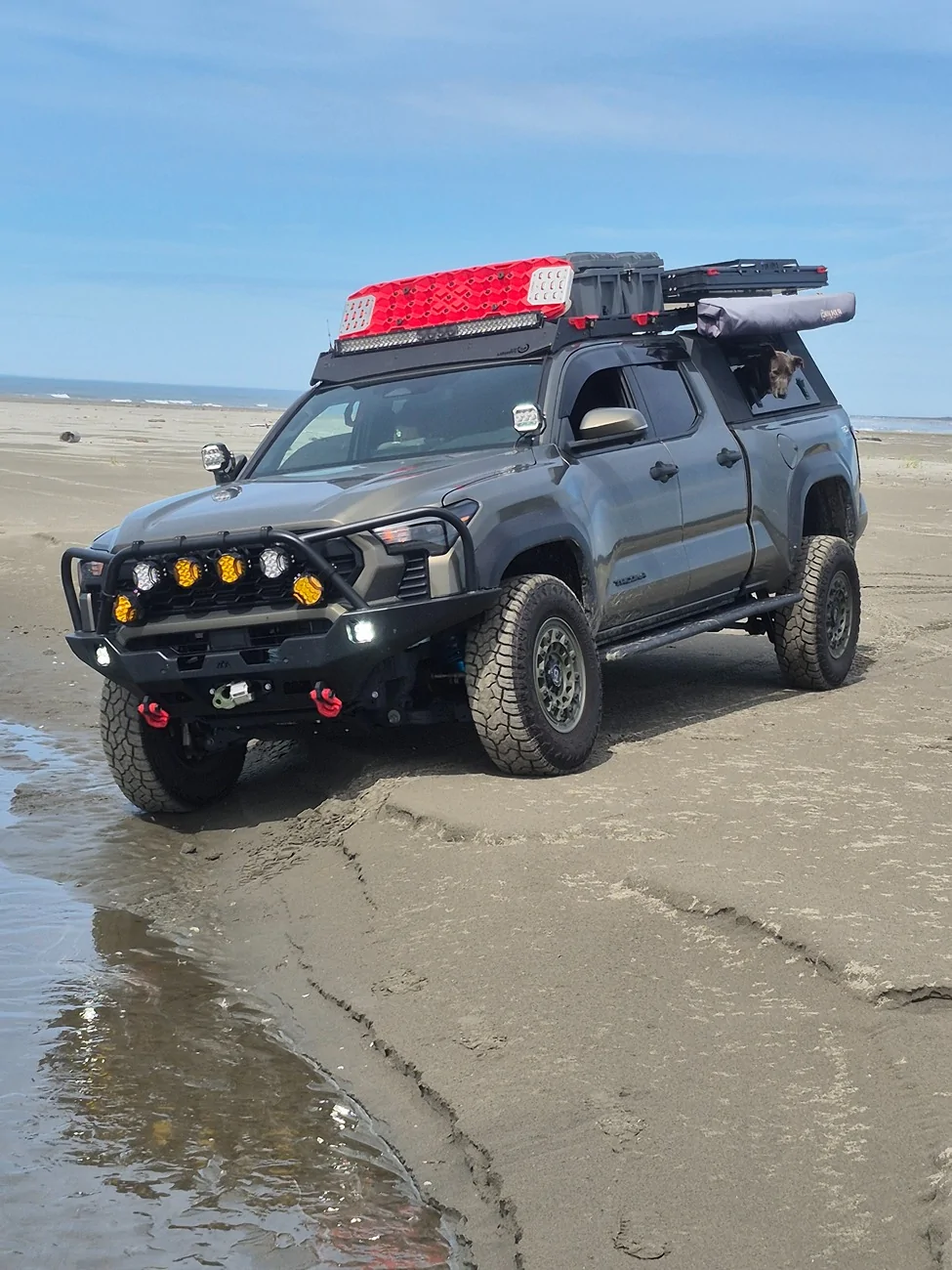

5 wheel/tire setup
NC soon.
That’s all for now!

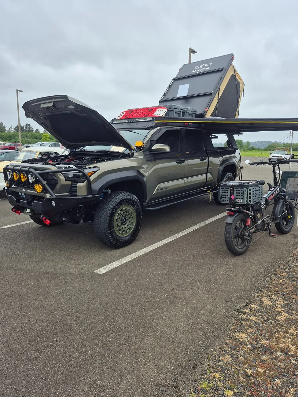

it.14and h t.g . . . els.o.
Thank you for Being Honest about your gas mileage.
Everyone I have been listening to says that you will get Worse Gas Mileage with a heavier Tire and Wheel 🛞 combination. I can save with certainty from real world testing that it is not s
I'm running Yokohama Geolandar X-AT 255 80 17's 10ply and Back Rhino Fuji 17X8.5 +20 wheels that weigh 27 pounds more than the stock whe
The Tires are a true 33x9.5, which makes them taller and narrower than the stock ones
At the point in my build, when I put them on my truck weighed roughly 1000lbs over stock with this setup
My gas mileage whent up 1 too 2 mileage a gallon
Then I had her Tuned, Stage 1 OTT, and if I keep my foot out of it and try to hyper mile, ( keeping the turbo boost low by manually shifting ) I gained another 1 mile 😅 now I was getting 17mp
Well, the downside of a tune: I don't know anyone that's had their truck tuned and keeps their foot out of i
Same set up foot in it now I was back down to 15mp
Next I started adding more overland gear for our trips, and a new front bumper with a winch, full aluminum skids and bla ba bla. My truck fully loaded down to go cross country weighs 2000lbs over stock. Of course I have re springed my king coilovers
rear spring of the truck with Dobinsons 821s to accommodate the extra weight. Now on a good tank of Premium octane I now average, 12 to
OMHO the biggest culprit to the poor gas mileage is the extra weight you add to the pickup and the way you drive, or baby

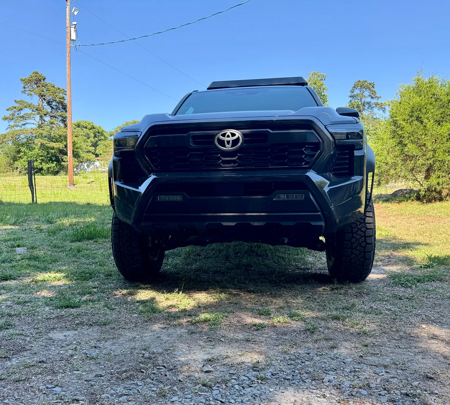

I replaced the tires this week. Only about 50 miles on the new ones so far but I can tell a huge difference in handling and agility. The previous ones were Kenda Klever r/t 285 70r17 e load @ 60lbs and looked amazing and rode well too but just weren't what I wanted. So I went to Kenda Klever at2 255 75r17 SL rated @ 45lbs. The ride is still really good and smooth over very uneven gravel roads and are nearly silent on the pavement with windows down. Steering is more responsive with a tighter radius. I kinda miss the beefy look but I think these look great too.
2024 Tacoma ‘25 TRD OR underground overland build IMG_9924
2024 Tacoma ‘25 TRD OR underground overland build IMG_9926
2024 Tacoma ‘25 TRD OR underground overland build IMG_9928
