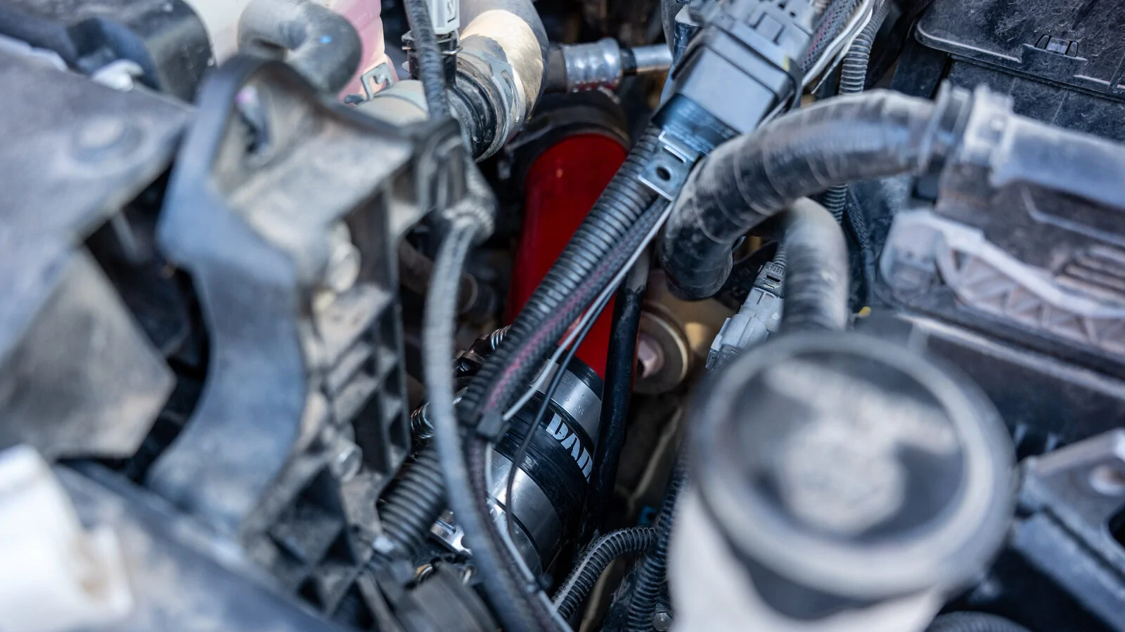

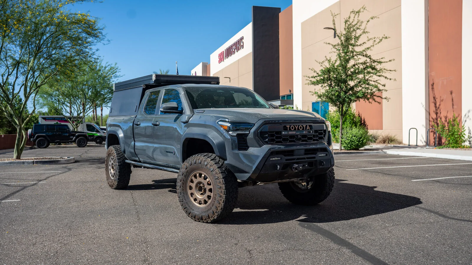

I want a full airflow build on this truck eventually, intake, intercooler, exhaust, the whole path. Before I bought any of it, I kept landing on the same thought: the air has to physically cross the engine bay before it reaches any of that, and the factory charge pipes are where that path starts. So I started there. This is part 1 of 4, and I am running the truck on a dyno before and after every stage so we can all see what the full airflow build is worth, and what each piece adds on its own. That is data nobody publishes.
Kit is the Banks 26012, on my 2024 i-FORCE MAX Trailhunter. SDHQ Off-Road did the install, about an hour, no tune.
2024 Tacoma Banks Stainless Boost Tubes for the 4G Tacoma IMG_8052

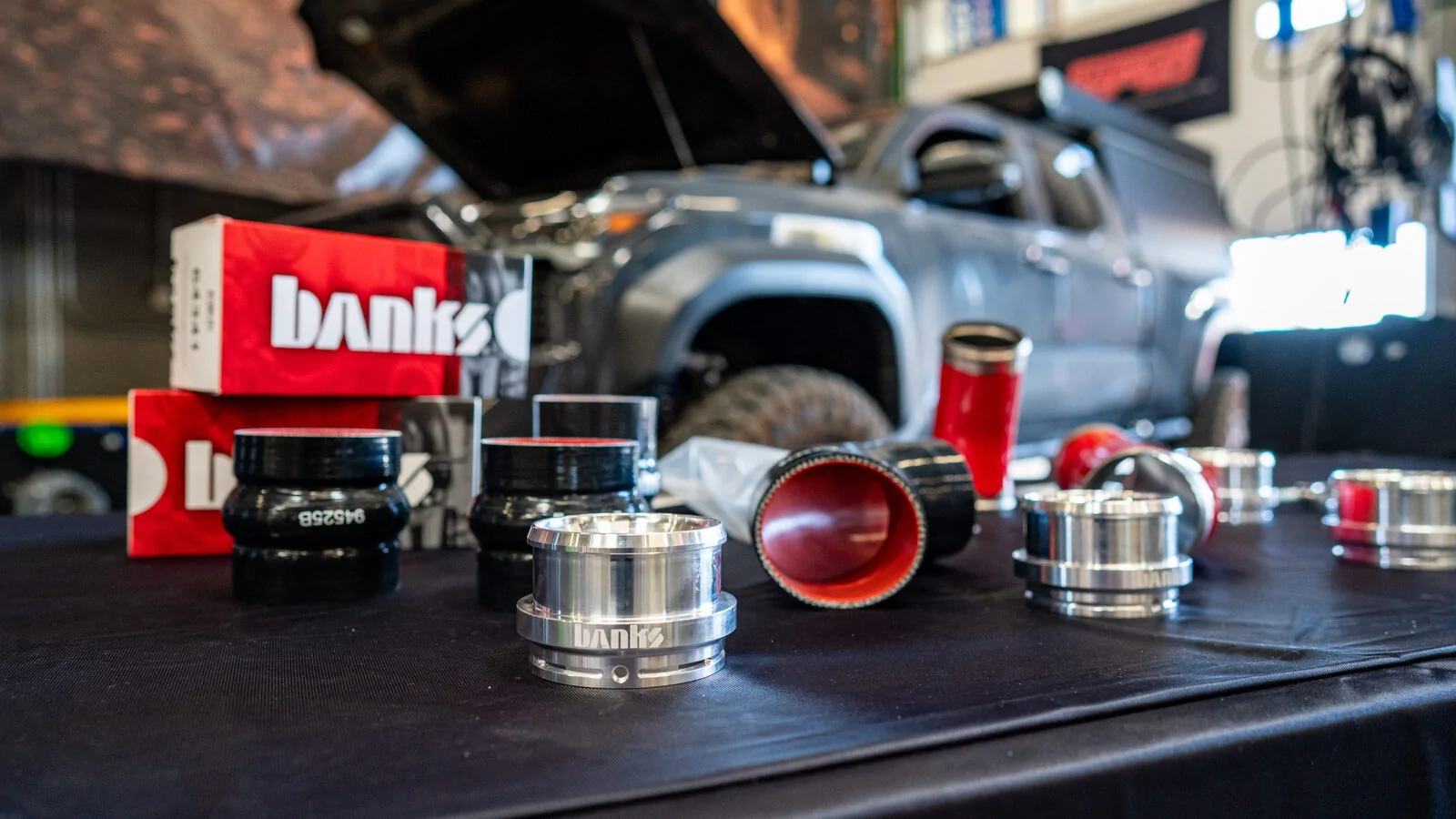

  • 409 stainless tubing, mandrel bent, uniform 3 inch on both sides
  • 5-ply Nomex-infused silicone couplers
  • Billet aluminum quick-connect adapters that mate to the OEM fittings with no mods
  • No tune, nothing to undo at inspection
  • Fits 2024-2026 Tacoma, 4Runner, Land Cruiser, gas and i-FORCE MAX
2024 Tacoma Banks Stainless Boost Tubes for the 4G Tacoma IMG_8057

Couplers and adapters
The couplers add a Nomex inner layer, the same fiber used in firefighter gear and race suits, which raises the temperature ceiling and resists abrasion at the clamp. That fifth ply is burst margin over a typical 3 or 4 ply. At stock boost a good 4-ply is already inside its rating, so this is headroom, not a cure for a problem anyone is having. The billet quick-connects are machined with smooth internal transitions so there is no step at the junction.
