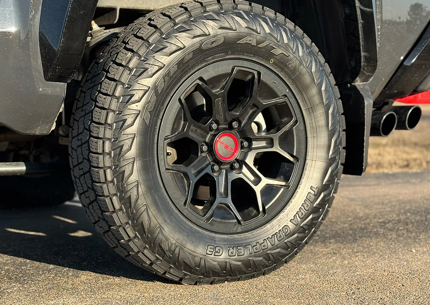

I have Nitto G3 in 275/70R18 and they've been great in all weather and the service roads I do. I might try the Toyo Open Country in 285/70R18 E @ 57# if I ever have issues with these, but would 100% buy the G3 again at this point.

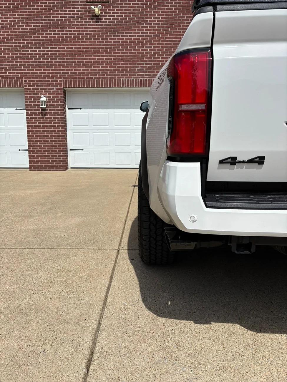

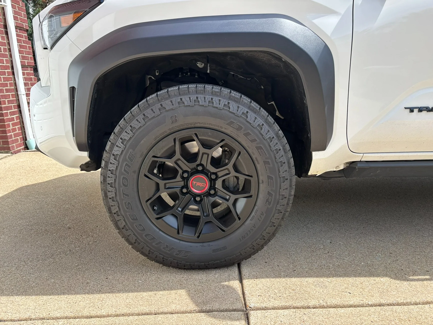

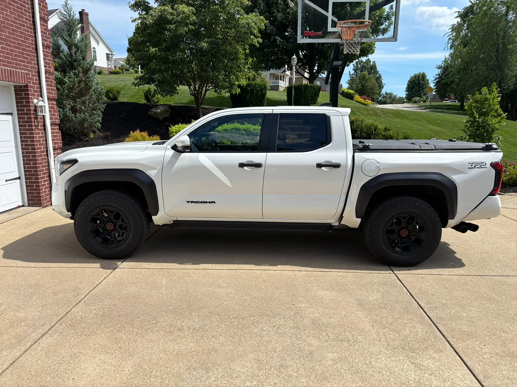

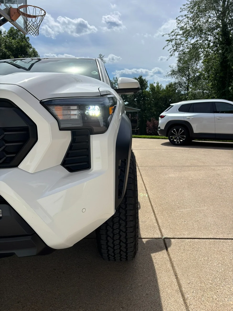

Upgraded my TRD OR from the factory 17's to a set of OEM TRD PRO 18" wheels. I put on 265/70/18 Bridgestone Dueler Ascent A/T's and they have been GREAT tires. I know they don't get much love here, but they are 5X quieter and ride 10x better then the stock BF Goodrich Trail Terrains. Little over 10,000 miles on them in PA, been through snow, sleet, rain and some light off-roading and they have handled everything with no issues. They look aggressive without looking ridiculous as well. Very happy with these tires, perfect fit with my truck.

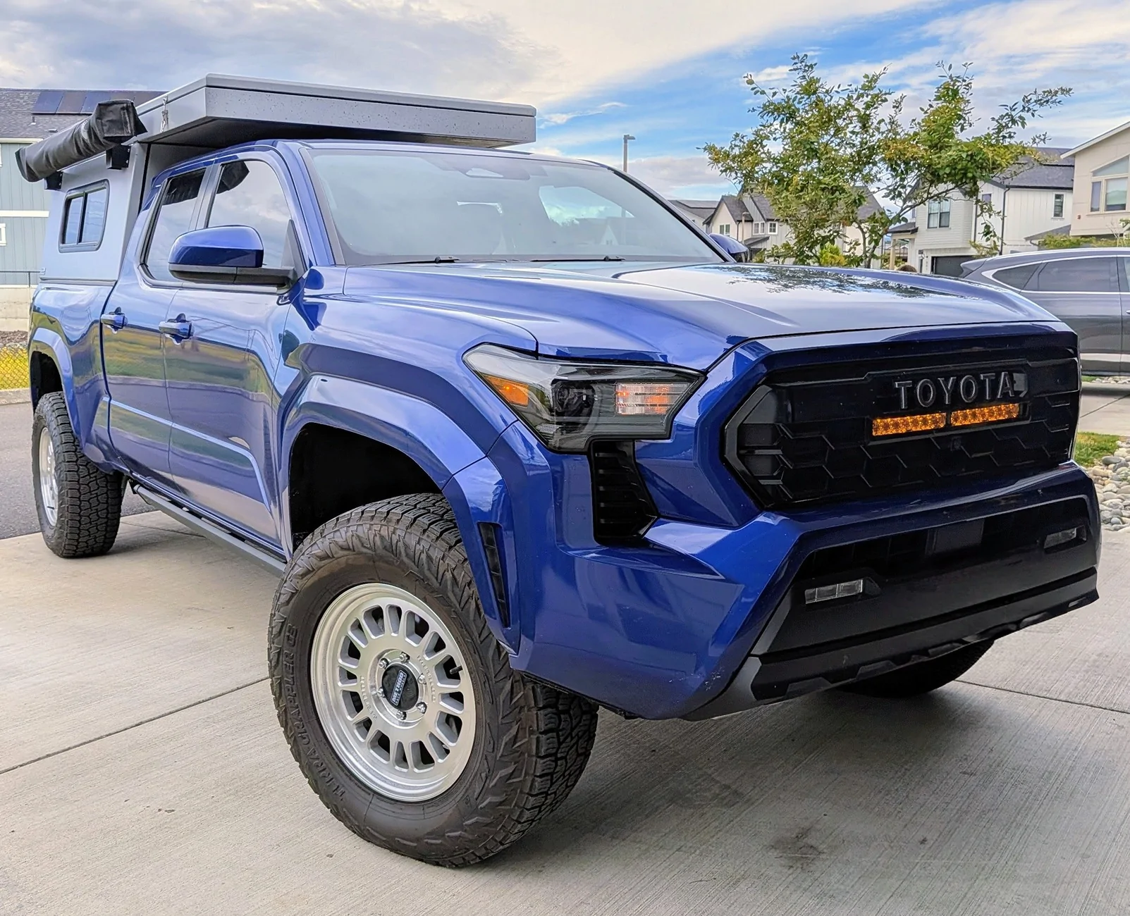

G3 is the best 18" option for Tacos that are city + gravel trucks that want a little off road capability IMO. Plus I think they look great and not overly "posery"
2024 Tacoma 275/70R18 Falken Wildpeak AT4W (10-ply) – Good Idea? PXL_20260609_171001333~3
2024 Tacoma 275/70R18 Falken Wildpeak AT4W (10-ply) – Good Idea? PXL_20260605_225556178~3
2024 Tacoma 275/70R18 Falken Wildpeak AT4W (10-ply) – Good Idea? PXL_20260519_034945238~2
