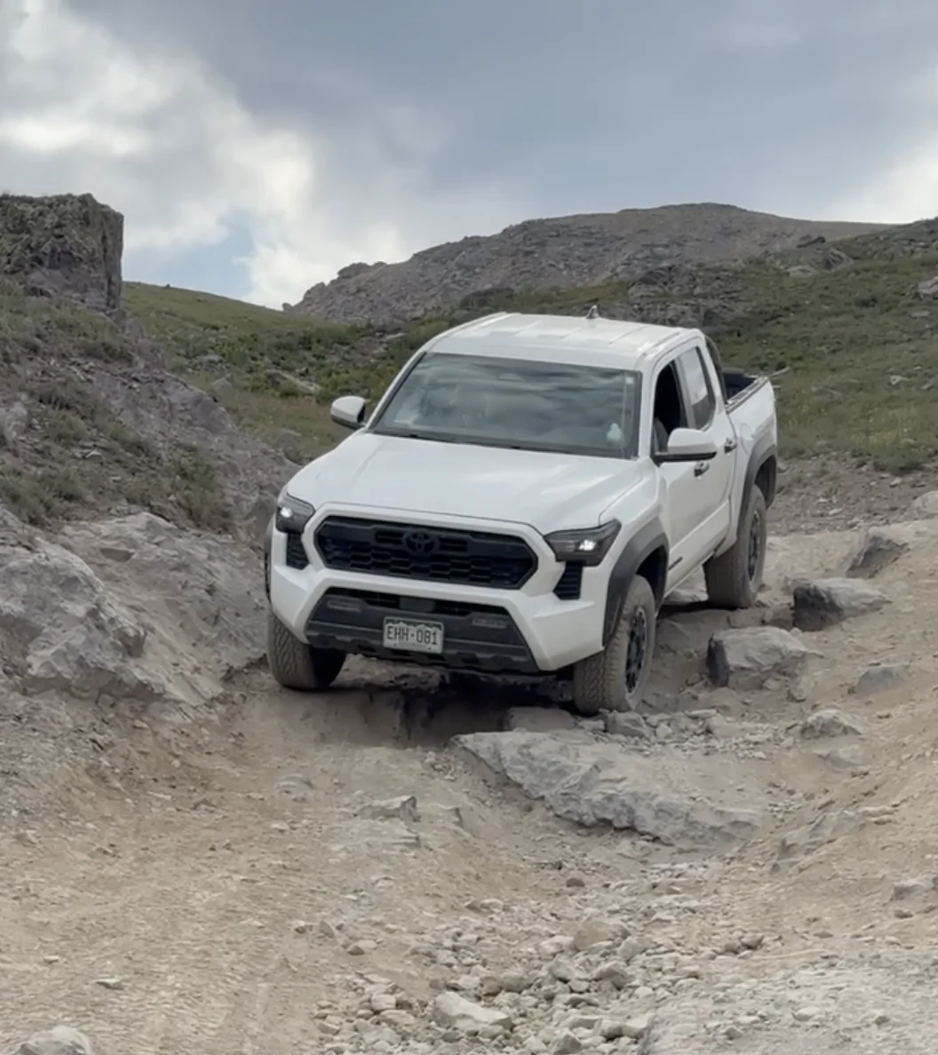

Going to throw in my experience too, because the transmission has been quite an annoyance. I did a bunch of wheeling these last few weeks, and just can't figure out how to get it to shift in 4 low. I've offloaded a prior gen sequoia, and a gx 550 Overtrail plenty, and haven't experienced the weird transmission mapping as I have with the tacoma.
The majority of the transmission gripes only happen in 4lo. It pins the RPMs without wanting to shift. That's fine in general, but it can be difficult to drive smoothly with others in the car if the throttle is super touchy. Uphill driving can be somewhat annoying, but I always acclimate fine by the end of the day.
Downhill is a nightmare. The manual mode doesn't actually shift the gears. I'll be going down a mild grade in "6th" gear, and still be at 4,500 rpm. The RPM's stay the exact same cycling through 1st-8th. Just make the manual mode actually shift gears. PLEASE. Once again, annoying, but technically can be lived with, except for the inconsistent shifting. I never use manual mode descending in 4lo, because it does literally nothing. Therefore, I'm left to the mercy of the auto shifting. I haven't yet really figured out what incentivizes the transmission to shift. I had a sketchy moment this Saturday on Imogene pass in CO. Very loose dry downhill, and the RPM's are pinned at 4k. Slight brakes going over some bumps, and I let of the brakes right when the transmission decides to shift up. The rpm's suddenly drop to 1k, and the car goes zooming significantly faster with absolutely no engine braking. I've had this happen quite a lot, and it's just not good.
I'm going to get some videos of this all happening at some point and compile thoughts because it's sort of hard to just write it all out. The transmission does also lie when in 2wd. I'll be going downhill in manual mode and the transmission will actually shift. I took video for my brother of it shifting up, gaining 2k rpm, while going 35mph and the screen says I'm in 8th gear.
