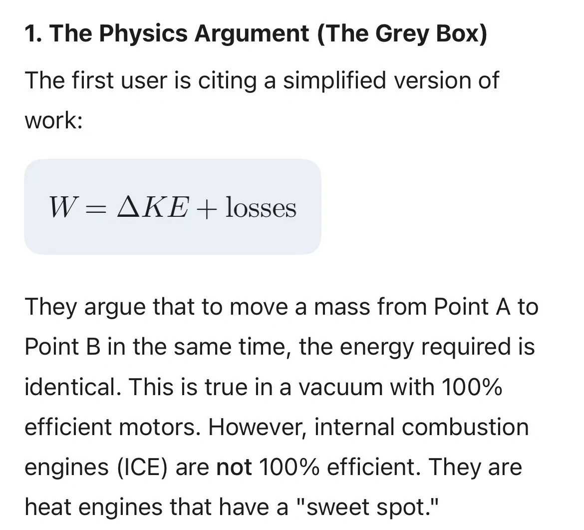

I’m not buying the study. Michu Kaku: takes the same amount of energy to cover that distance in the exact same amount of time. The variable is air resistance, if the engine is to temp, time (perceived faster but in reality took longer), braking, etc
Albert Einstein is rolling in his grave. From a complete stop to crossing the end point at the exact same elapsed time, explain how the laws of physics can be defied & you get free gas by goosing it off the line vs driving like grandma.

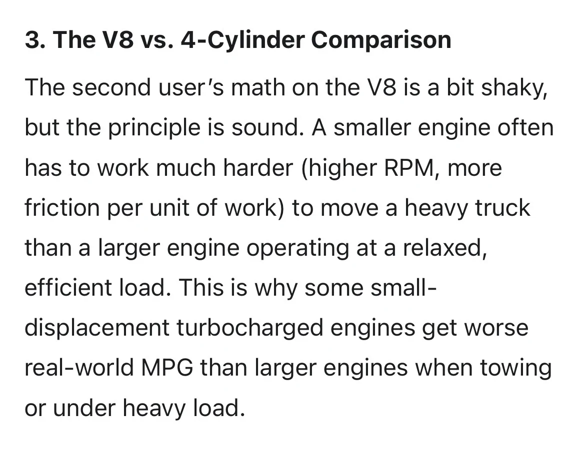

I imagine it would have to do with the efficiency of the engine under various loads vs time. Yes, you're using more fuel when accelerating quickly but accelerating slowly for a much longer period may not be as efficient as quickly for a short time. An example would be that V8 engines are far more efficient than a 4 cyl when you measure mpg vs hp. A 400 hp V8 may get 20 mpg while a 4 cyl engine half the size would not get 40 mpg, more like 30 mpg. So in this example the V8 is 50% more efficient than the 4 cyl. when comparing cubic inch or hp. vs mpg.

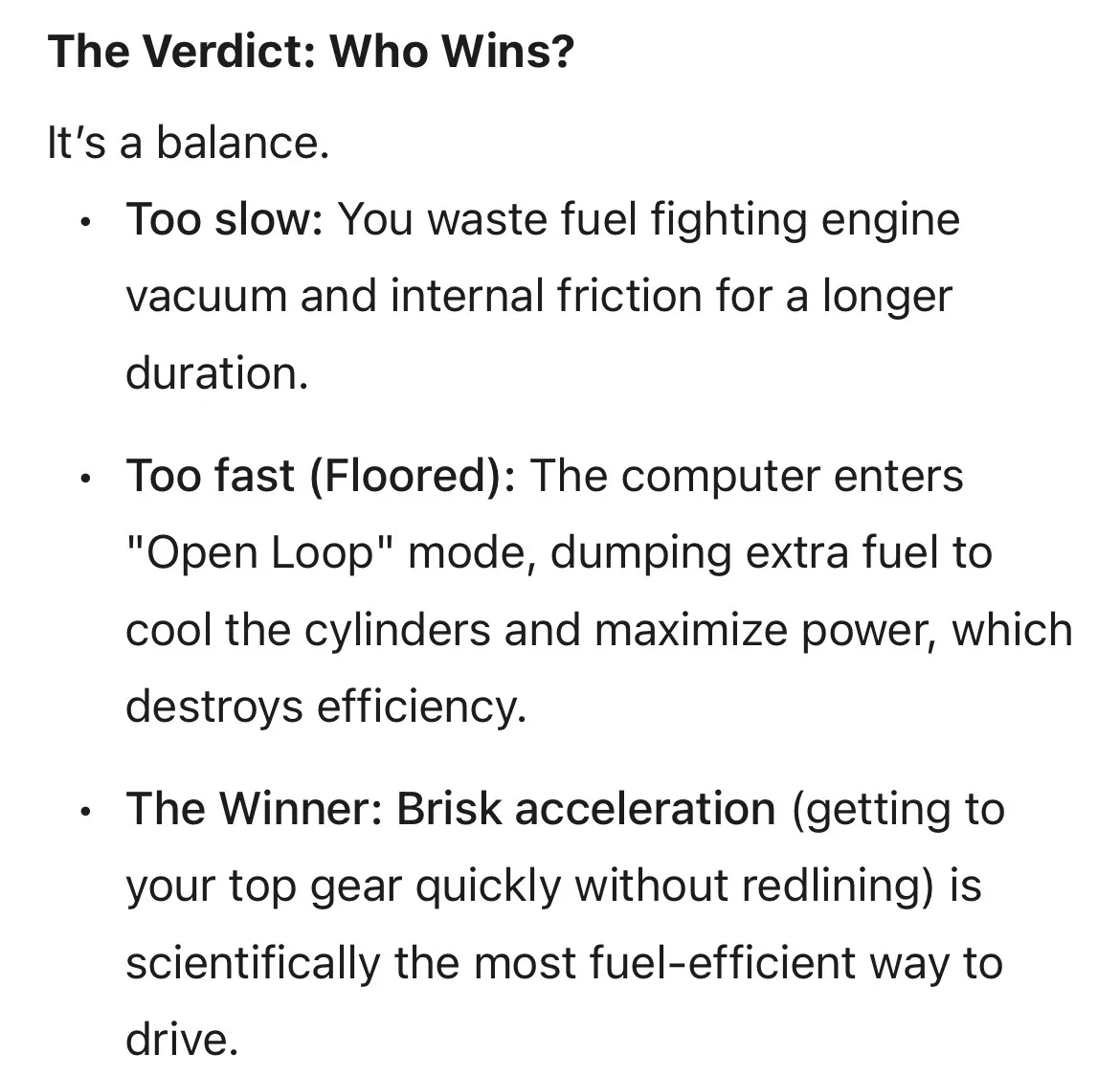

I stand corrected. After some deeper digging yes efficiency (internal friction) of the how the ICE behaves during acceleration can in fact affect MPGs
