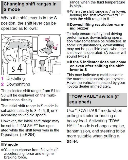

So are you saying that I should switch over to the manual transmission when I go to four low instead of the automatic
You can if you want to be able to shift into a higher gear and thus be able to go faster. In the manual it's called "S" mode or as it has been said earlier on this post "Sport". It just gives to a different level of control for what gear you are using.
I think that's my answer. I just hit the sand and gave it a shot. Works a lot better that way. If you're just in the normal drive it seems like it never wants to get out of first but the s works pretty good. Thank you!
