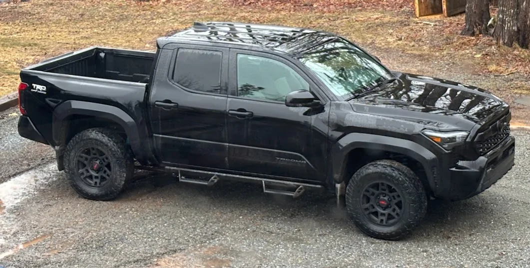

So, I got some 17" wheels from a 5th gen 4Runner and they have TPMS sensors (or TPWS like Toyota says, not sure why they felt the need to flip the M upside down), but I can't get them programmed. I followed the procedure in the manual, it shows that it will discover them while driving. I've gone on 3 different drives of 1 hour each and still detected.
I'm wondering if they are compatible at all? 5th Gen 4 Runner is like 3rd Gen Tacoma.
Anybody had luck with these wheels?
