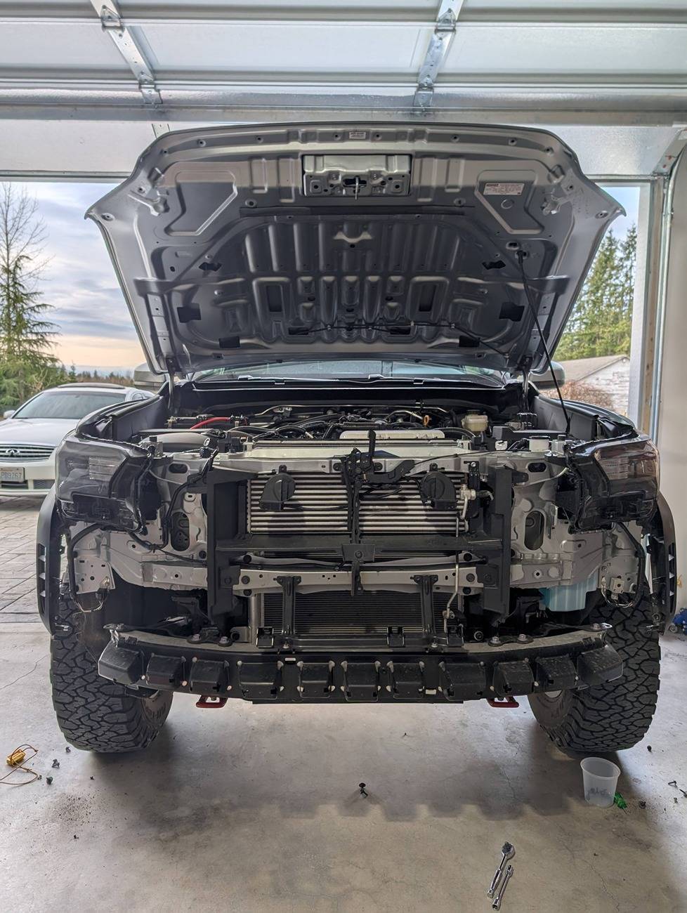

Front End off the truck.

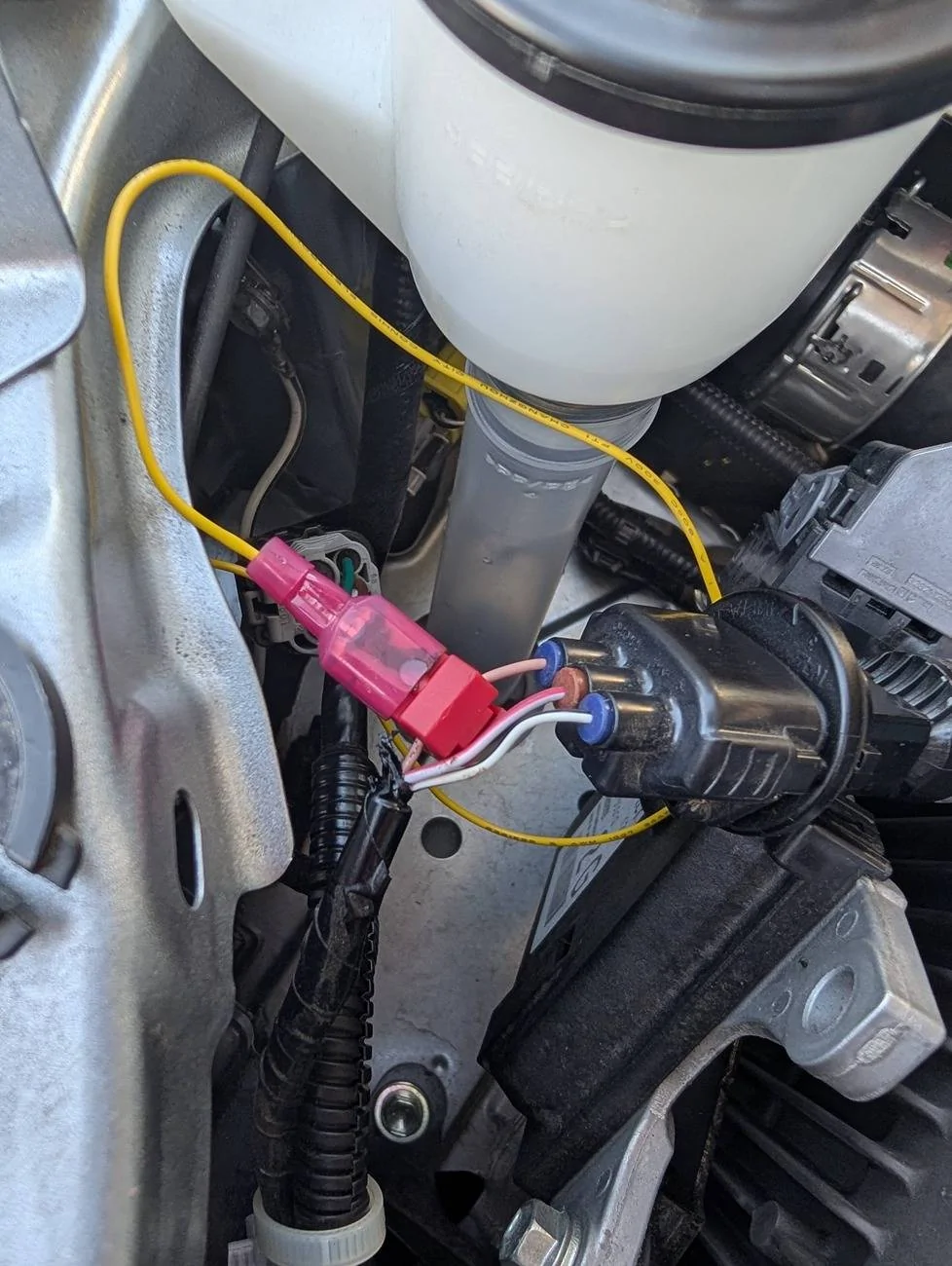

Wiring for the fang light turn signal, driver's side.

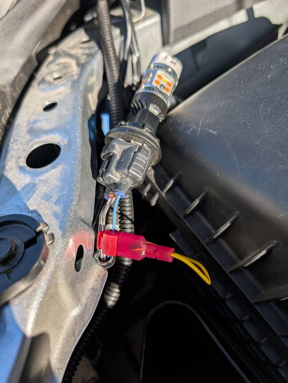

Wiring for the fang light turn signal, passenger's side. Note that the wiring is the same for both sides other than the fact that the wires are different colors on the driver vs. passenger side.

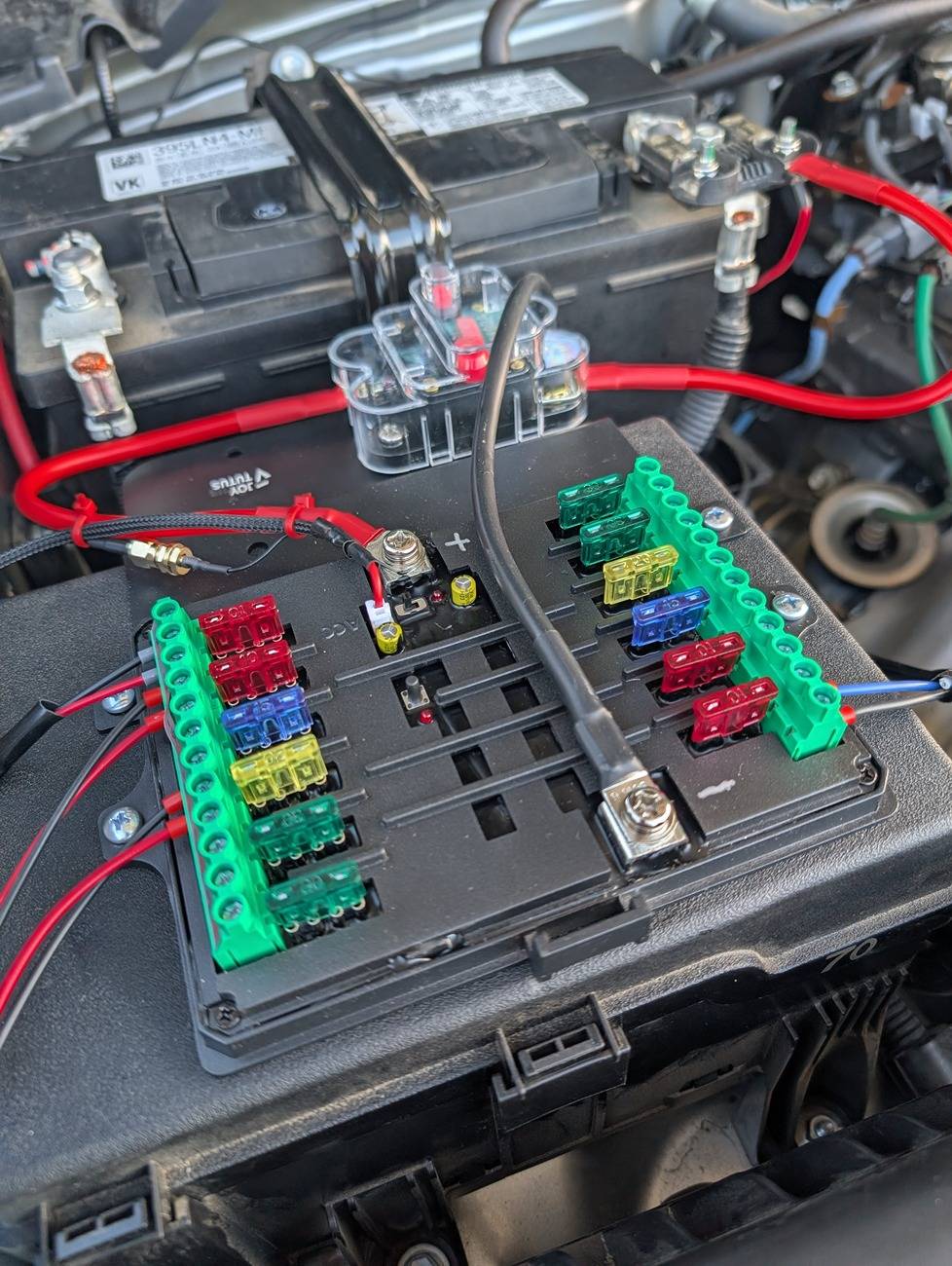

Ok, here's where I took a different path. With all the different lighting and whatnot that I have going on I decided I needed a better power distribution system than just trying to use the three factory aux switches. After a bunch of research I purchased this. It has 12 circuits supporting a total of 100 amps. Again, this unit appears identical (as near as I can tell) to a half dozen other products, including the MicTuning P1s. The only spin Joyutus (?) puts on their kit is that they seem to be marketing towards the Jeep crowd so they include an extra bracket that mounts to the fender of a JL and an included install page for the Jeep. Other than that there is no branding on it at all. The wireless controller is nice and eliminates having to run a wire through the firewall. I also haven't really found anywhere inside the truck that is ideal for mounting a controller, but with the wireless controller I don't really need it mounted. The wireless controller isn't perfect. For instance it's not full-duplex, meaning the controller is sending a signal to the wired panel but it doesn't know if the panel doesn't acknowledge the signal. Ideally when I turn the truck off I'd like the panel to get a signal sent to it that the wired panel had power removed and the controller should shut down and go into a low power mode, and then when the ignition is turned on the wired panel would send a signal to wake the wireless back up and restore the previous state. That doesn't happen so you have to remember to power off the controller when you shut the truck off and turn it back on after starting the truck. Realistically though, the wired panels from Auxbeam, MicTuning, etc... function the same way, they don't automatically turn on after ignition you have to power them manually. All that said, again, for the money I think this is an excellent solution.
Anyway, here's the install.

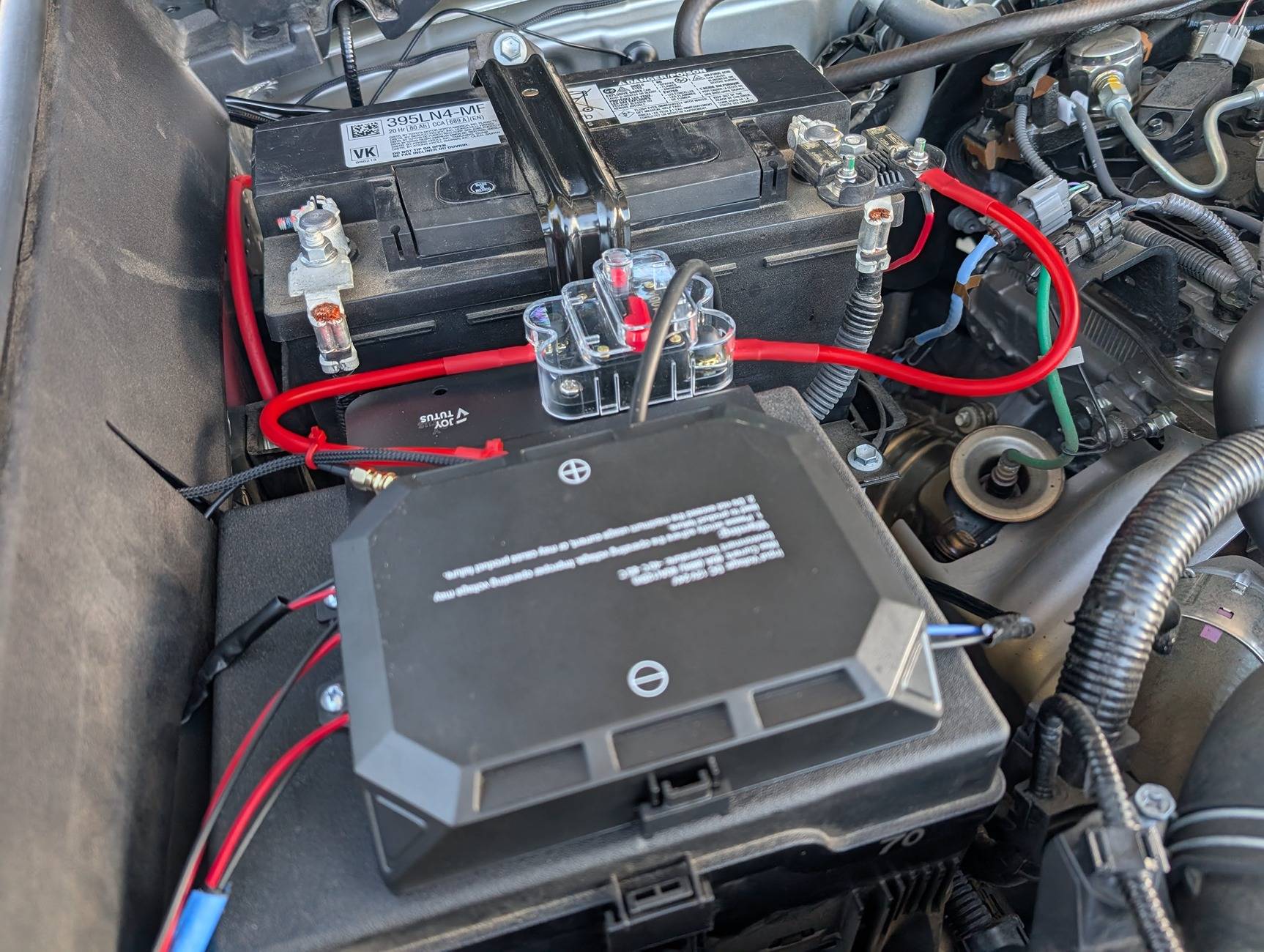

I chose to mount it on the passenger side fuse panel cover next to the battery.

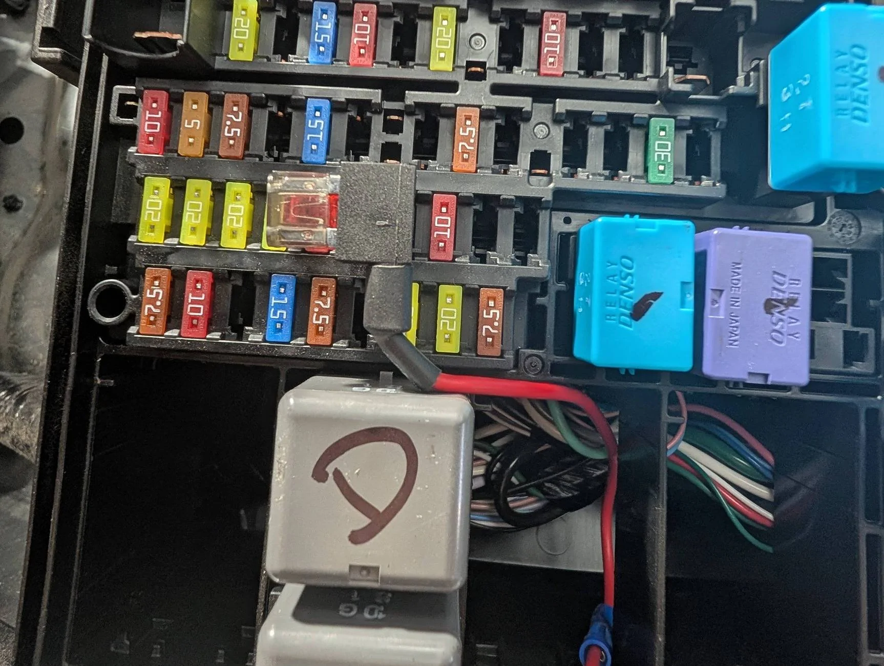

I used the IGN circuit on the driver's side fuse box to trigger the unit on and off. Note that you need to ensure the fuse tap is installed correctly. There was a picture in another thread of someone who installed the fuse tap the opposite of how I have it. That would be wrong. Installing the tap backwards doesn't protect anything. If the fuse blows power will still be flowing to whatever device is being powered and potentially cause big problems. When I read the other post at the time I didn't think anything of it but once I installed my own I realized the mistake. I've searched to find that post again and of course now I can't find it. Bottom line the easiest way to ensure the tap is installed correctly is to pull the fuse and ensure the feed loses power. If it doesn't then the tap need to be reversed.

Wiring inside the power distribution panel. I have lots of room for more circuits....

I'm not sure if it would affect anything with your distribution module, but I have seen a couple people that have wired their fang lights to the IGN say that it will randomly turn on when the truck is off. Just something to be aware of.

Yes, thanks. I saw that in a couple of different threads and tried to find a different fuse to tap but couldn't come up with anything. It would have been ideal to find a switched fuse in the passenger side fuse box but it seems like that whole box is constantly powered. Realistically though the intermittent power coming on doesn't affect the pdu, and if anything is a good reason to have it. The ignition tap doesn't actually power the pdu, the pdu just won't power on unless the tap is live. Once you have power from the ignition you still have to power the pdu on with the remote so I don't have to worry about the lights and whatnot randomly coming on like you do when you just have a relay straight to the battery.
Slightly different thought but the pdu also has an option to be constantly powered w/o the ignition on. There's a switch on the panel that disables the ignition tap and then it's always powered straight from the battery and you have to physically turn it on and off using the remote. That might work well in some applications but I chose not to go that route b/c knowing me it would only be a matter of time before I left something on and drained the battery.
