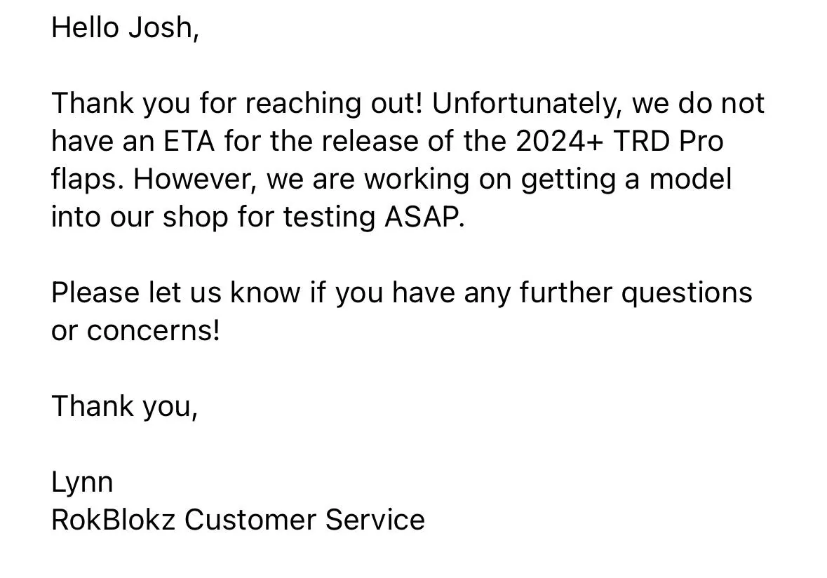

I agree on both points about the Canadian flaps. I hope when Rekgen releases their 4th gen sliders they'll fit the pro.

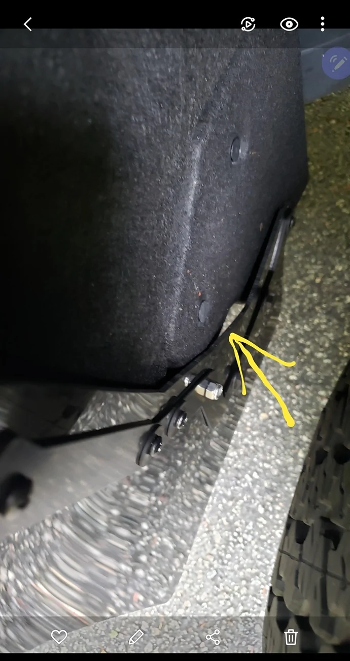

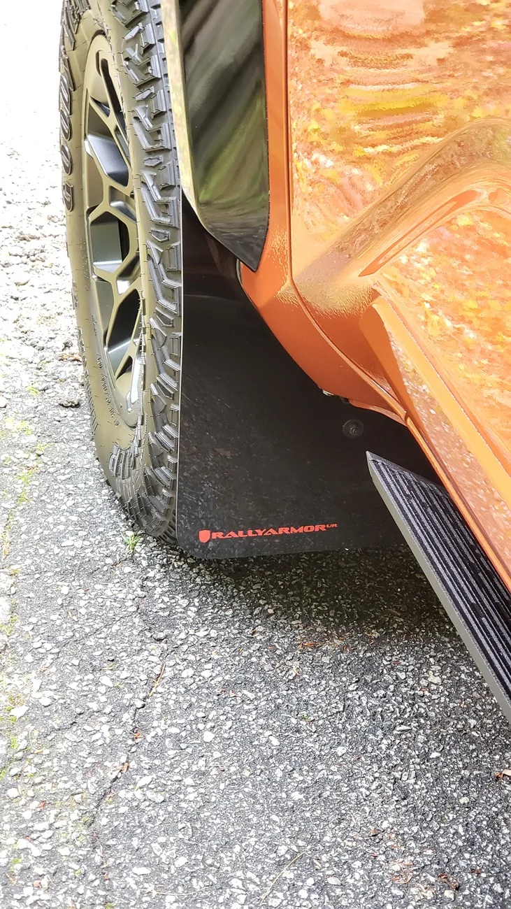

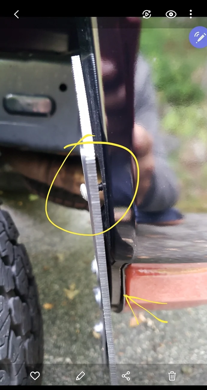

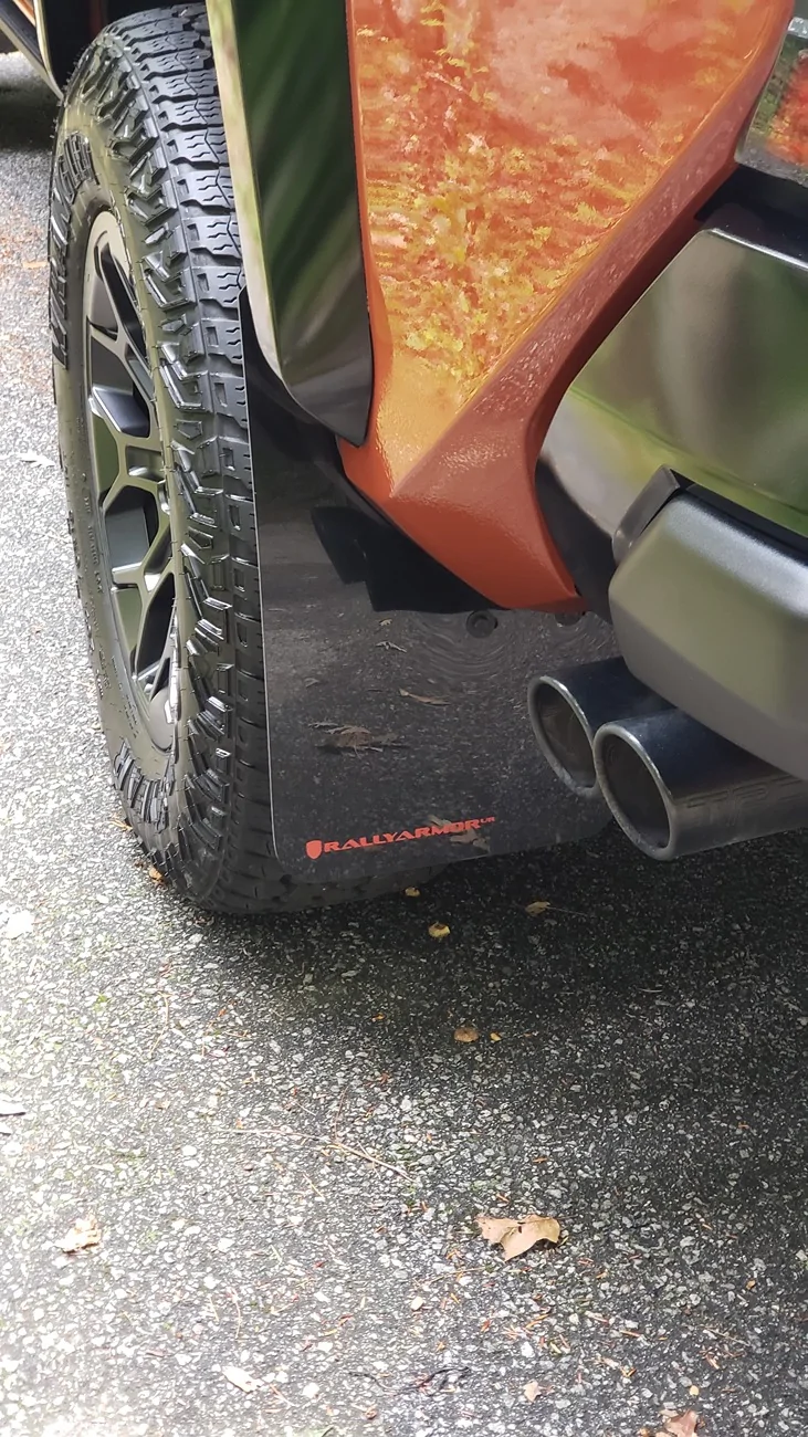

So I wanted to update this thread, I finally managed to get the rally armor flaps installed, though it was a pain and the rear drivers side still isn't perfect. Here's some pics. They look good, the black matches the fender flares and the red almost matches the paint.
2024 Tacoma Aftermarket mud flaps for TRD Pro? 20250910_141201
2024 Tacoma Aftermarket mud flaps for TRD Pro? 20250910_141151
The rear drivers side was the worst one. You can see how the top screw isn't really seated fully, and the foam spacer isn't sized properly IMO. Of course this was the one I originally started with and the one that gave the most trouble.
2024 Tacoma Aftermarket mud flaps for TRD Pro? Screenshot_20250910-192600_Gallery
The rear passenger went on easier though I still couldn't get the top screw to grab with the included washer, so I ditched it. Note the spacer, DO NOT over tighten the screws over the foam spacers, they're not gaskets, they are there simply to fill that space.

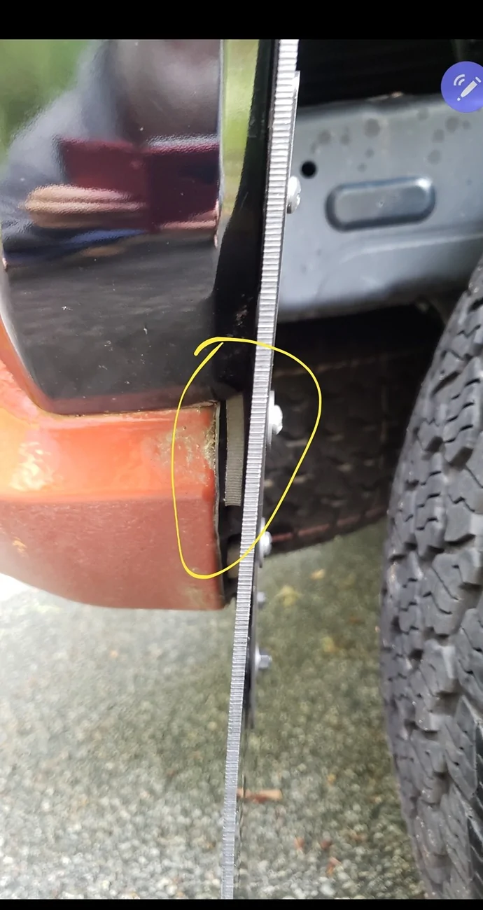

The fronts went on ok, though I found it easier to turn the wheels towards the opposite side of the truck for access. There's this space that bothers me in the front but I'm over it, just glad to finally have something on there.

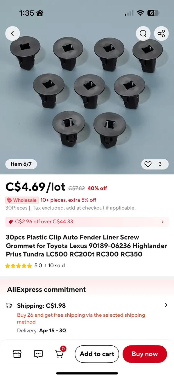

Did you find that the nylon threads easily strip / suck for seating the screws (toyota threads)

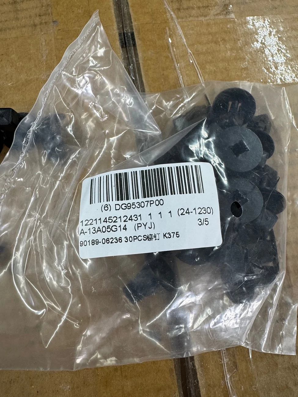

I’m not the person you replied to but yes, they are garbage, however I bought a bunch from AliExpress and keep swapping them out when they get chewed up if I need to remove my flaps for some reason, I’m on my 3rd set, I think next time I will buy longer ones, the Rokblokz screws came super long and for whatever reason the pro clips are shorter
Dude. So helpful. Running into the same issue with the arb bumper threads for the rigid lights. Why didn’t you go OEM? Are these essentially identical ?

I haven't had an issue with the ARB bumper inserts, and with the size of my hands I really hope I don't come up with an issue, I won't be able to fix it
Yes these are as good as OEM, no slop, my mudflaps sit tight, I didn't price OEM but they're probably $5 a piece like the Drain plug gasket, which I just bought in bulk from Amazon

I am replacing a rigid light this weekend bc of a warranty issue, and I just have a bad feeling it’s going to be stripped… at least it’s on the driver side. I have a glue gun I could use it it’s slightly stripper and that’ll likely be plenty.
I’m going to purchase these inserts so I can freely experiment with my mud flaps without being worried. I’ve got the OEM Canadian flaps I want to put on, but I’ve got to modify them to fit with my wider tires. Been putting it off solely bc of this stupid issue with the screw clips!
