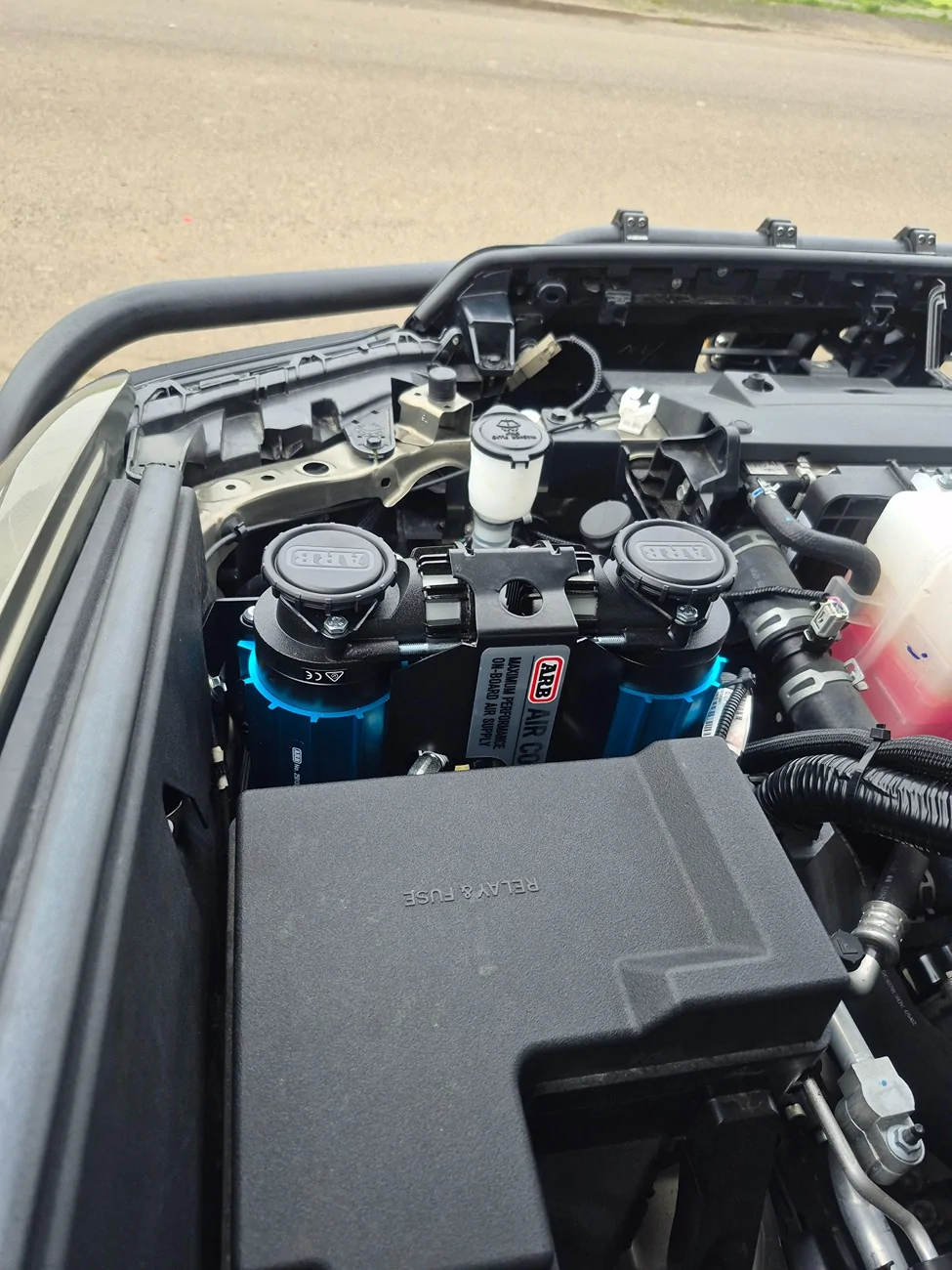

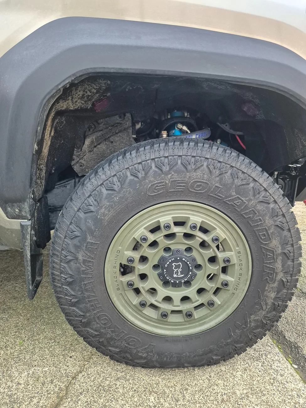

I run a 33x9.5, or in metric a 255 80 17 and have safely aired down to 15psi without beadlock rims in sandy and muddy conditions. In rocky conditions I air down to 20psi.
The reason I only go down to 20psi in the rock 🪨 is because my truck weighs roughly 2000 pounds over the stock weight. The weight makes up for the 5lbs difference.
I highly recommend buying a good air compressor, it makes life easier. I chose ARB twin with a zroadz bracket.

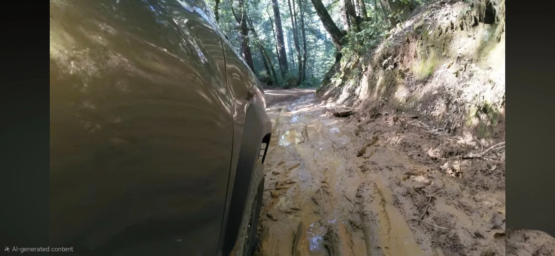

I slightly disagree here. We have been up and down the $$ on compressors and now we ended up on a Milwaukee 18v comp and it's works wonders.
As for psi this depends on load, GVW, terrain, and more. We have been down as low as 5psi but again it varies. There are some good YTs on this topic and rule of thumb is air down to get grip than up/down from that point to retain grip. Floattion is not a factor at this point.

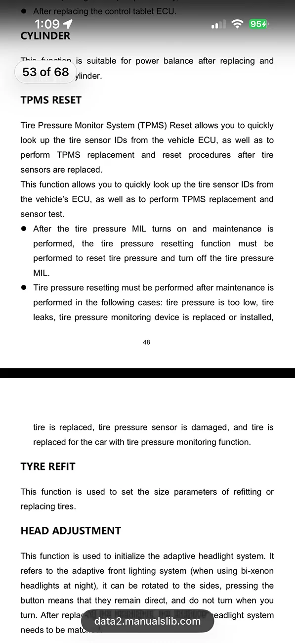

Do tell! I thought that the TPMS warning was something I had to live with, but what can you share about this? Go through the infotainment to find a setting use a scan tool? I don’t have a TPMS kit.

I slightly lied. Just looked at my XTool D8W manual. The tablet has TPMS test and reset functionality.
