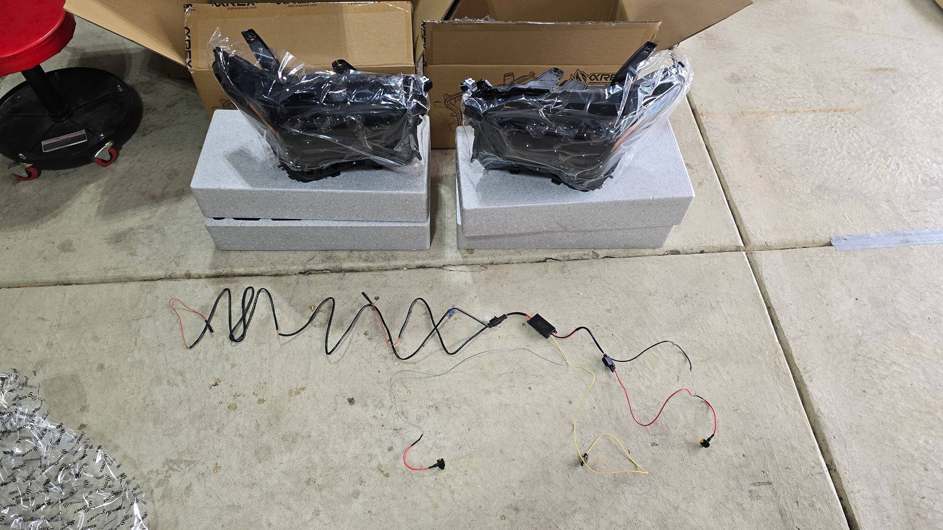

Anyone have what the OEM headlamp connectors are on an off road? Or a picture of the back of an OEM light or wiring schematic? I can set these up on the bench and year turn off I had such. If not will probably be Sunday info I can install

Got them installed. Love them. The lead tech at AlphaRex was super helpful. The full install info will be on the website soon according to him. Here’s a picture from AlphaRex on how the fuse box hookups should look like. After that everything else is pretty straightforward.
Did they give u the reason why the front led doesn't light up like they promoted ? I heard someone else say someone at alpharex said the manufacturer changed that functionality and they didn't even know. Just seems like a concerning mess for a company that size.
Those look like the IGR and horn fuse. Guessing ones constant powered and ones switched (ignition)
Nope. They just made sure that I was aware of that before I bought them.
Those are them ?
Those are them ?

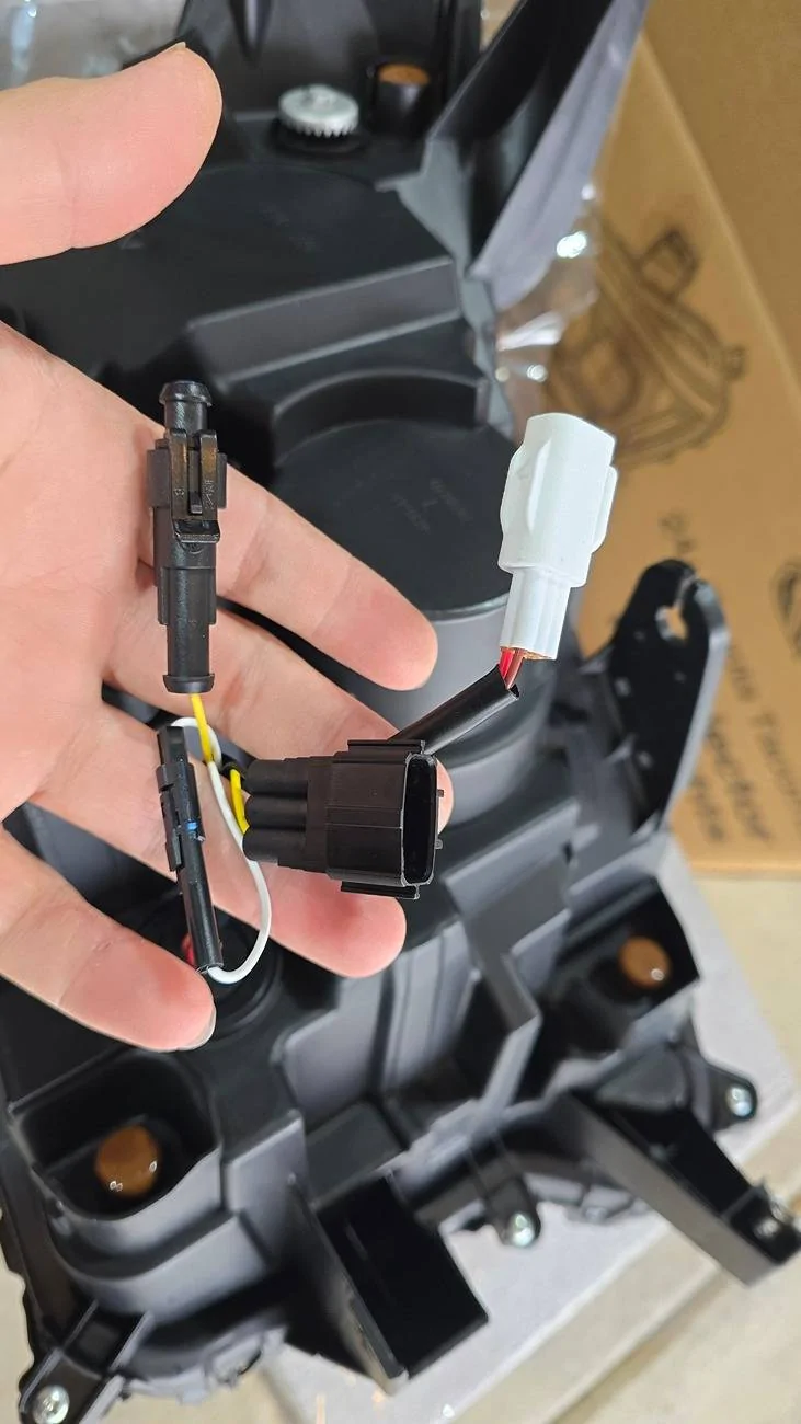

Can u describe how the harness hooks up? Fuses are explanatory.
There's two things singular tube connectors. Obviously one goes to each light. Guessing you need to disconnect the tube connectors that plug into itself on the light and plug the one from the harness into it? And lastly that singular AMP style connector that's yellow goes to one of the headlights?

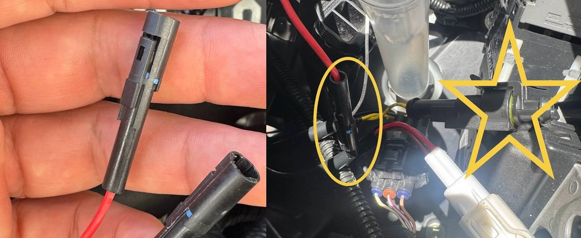

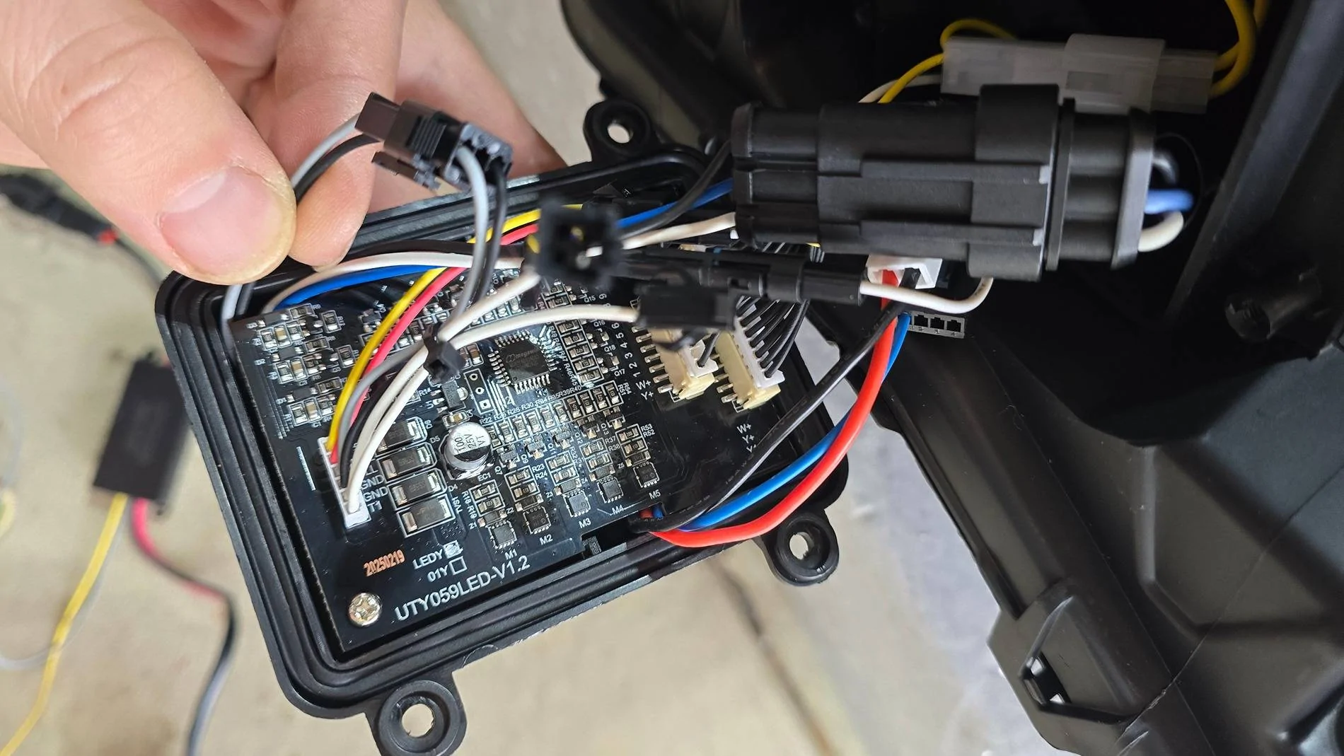

Everything has a place except the plug with the star (see photo) Per AlphaRex that plug is for connection to the AlphaRex Fog Lights which double as turn signals. The small white plugs on the headlights connect to the red plugs on the harness (see photo/circled red)
2024 Tacoma Alpharex Nova LED Projector Headlights IMG_0676
Also, to run the amber drls you have to open two small boxes on each light and swap a couple wires (see video)
