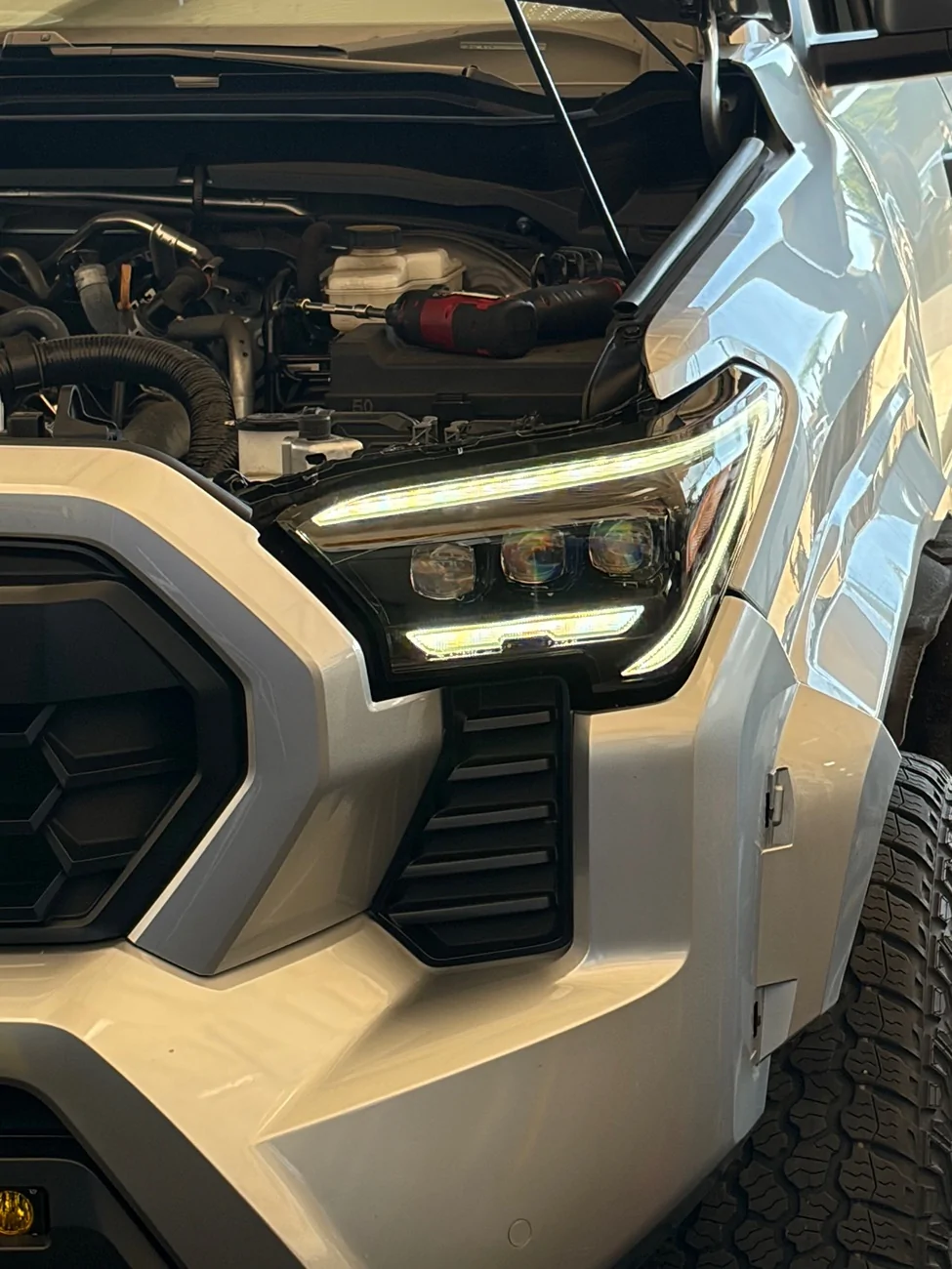

FWIW I purchased mine on 10/15/25 and had it installed by them at their location in Irwindale.
I initially selected Amber drl and was told by the sales specialist on site if I selected white the bottom bar does not light up as there are no white leds in there. After a few days I swapped to white drl myself and guess what, the guy was wrong as the bottom bar lights up white together with the surrounding leds. I was actually hoping he was right and the bottom bar wouldn’t light up with white drl.
Also, on mine if I pull the fuse for the tap I do not get DRL or any start up animation. I assume mine is the current version as he was positive when he told me there were no white LEDs in the bottom bar and they were working on adding them. They must have added it without updating their sales guys. 🤷🏻‍♂️

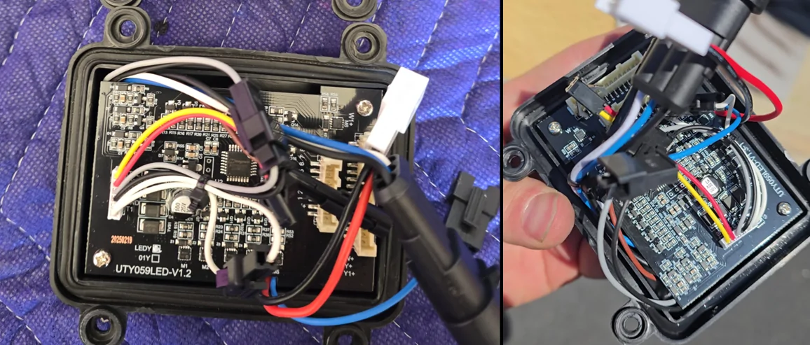

Yea, they're a little bit of a mess for a company as a whole. Focus too much on being first to market IMO.
Anyway, although I wasn't a influencer or special ambassador receipiment to of gotten the early batches. I got mine right when they went live for order on their site. I received the board where manufacturing apparently changed the design on them and stopped lighting up the button LED strip.
I basically said ill be returning them since its not what was advertised and what i received. They sent me new boards to replace them with the bottom lit up. As you can see here revision 1.2 vs 1.3.1

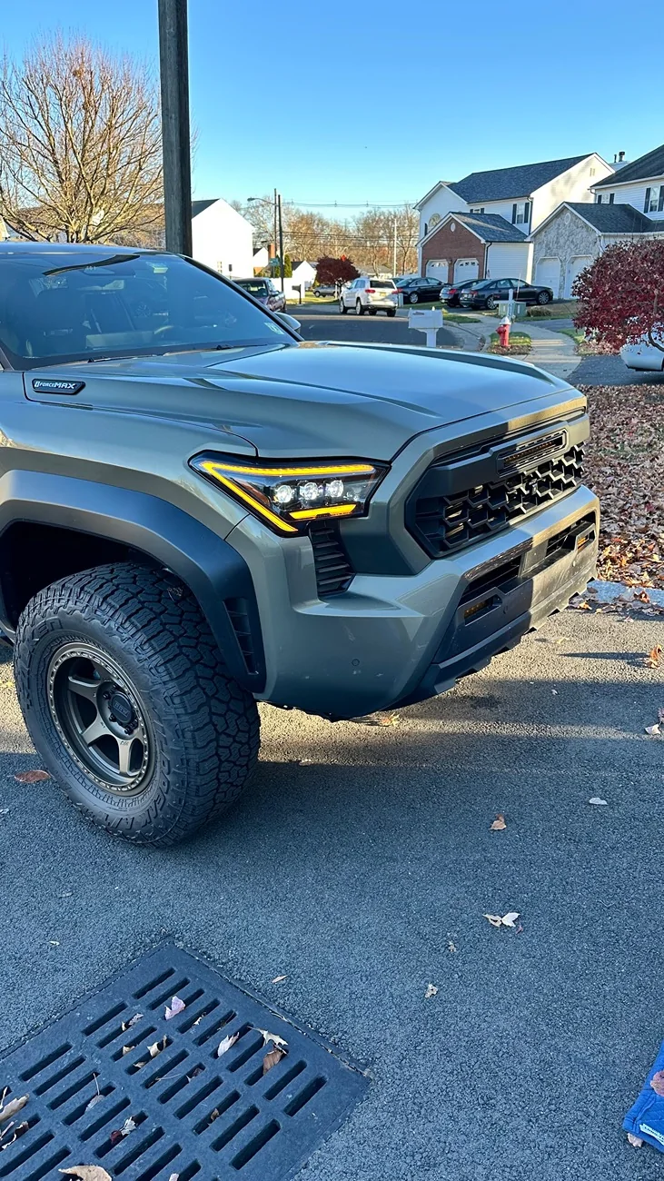

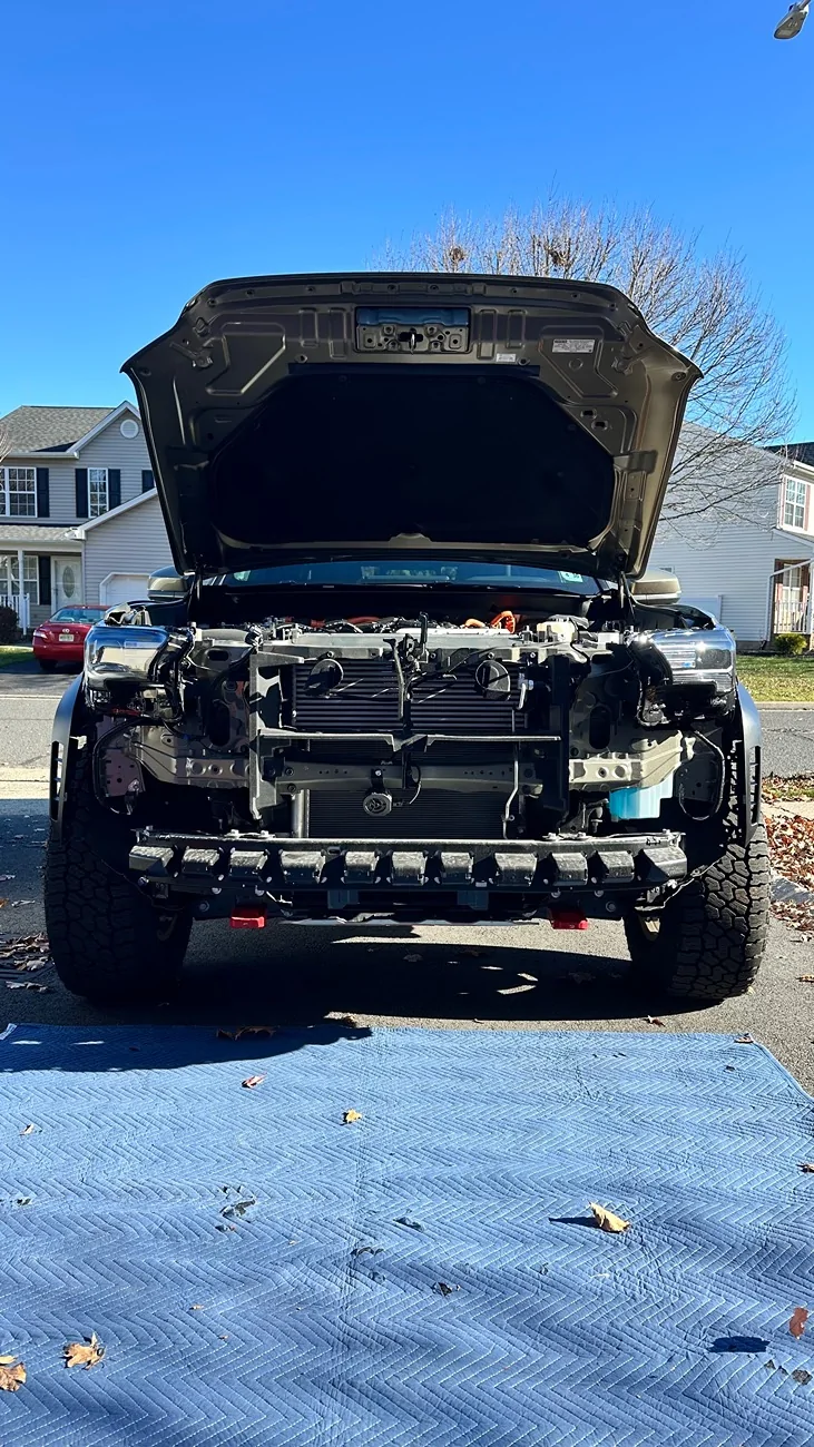

Alpharex is very inconsistent with their information to me. I installed the lights without the DRL harness and I was able to activate the lights without sequence upon unlocking via remote. See my IG clip

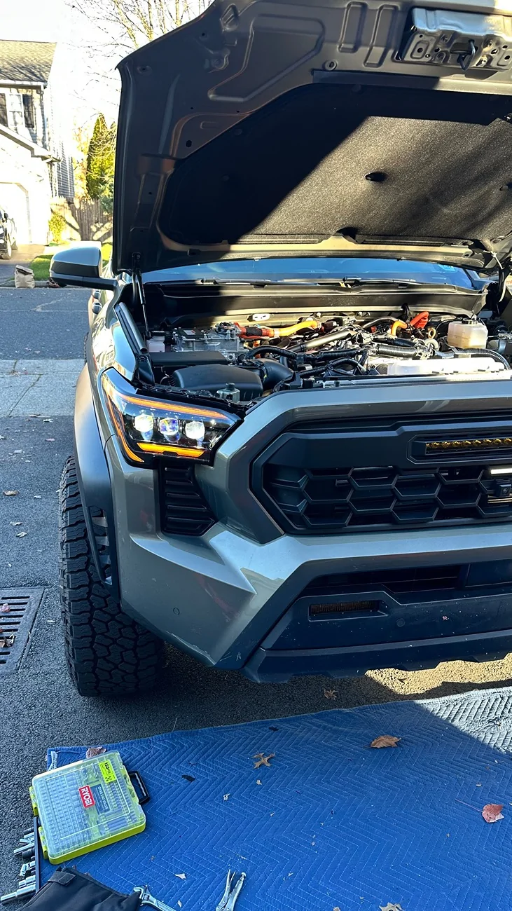

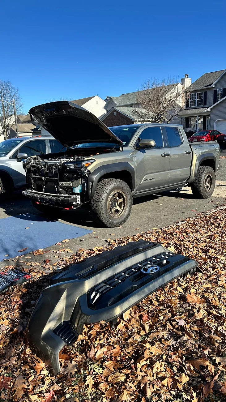

this morning I removed the bumpers and unplugged all the harness to the lights to take off the aftermarket fogs that didn’t work and when I reinstalled everything the unlocking sequence stopped working. However when I turn on the truck the light sequence activates.
So I disconnected the negative terminal from my backseat (hybrid ) battery for 30 minutes and reinstalled them and now my lights don’t turn at all. Any suggestions before contacting their tech support tomorrow? @emerica243 @dvrgz @rijc99 ? Thanks.
Thanks.
rijc99
Oct 1, 2024
412
207
Just to clarify your issue, headlights don’t work at all? Even when switched on manually?
