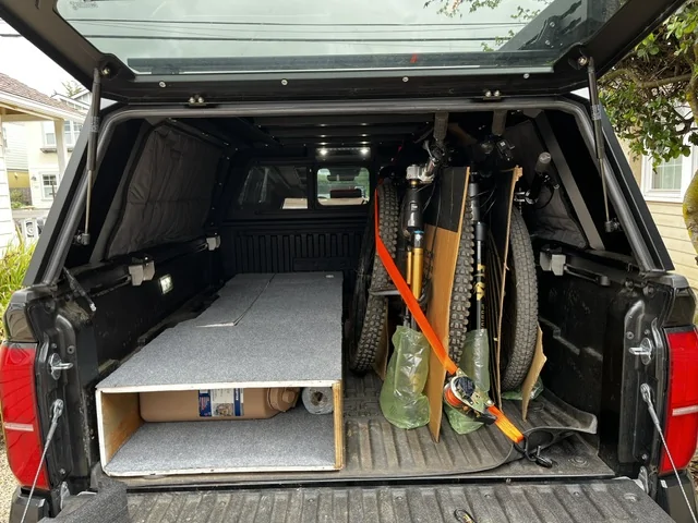

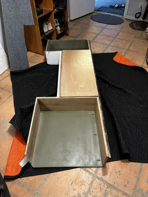

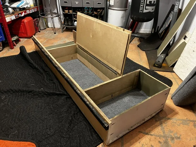

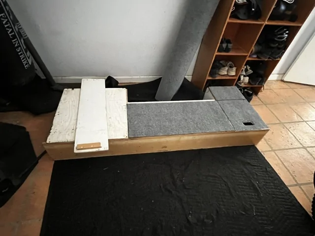

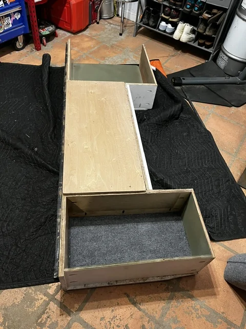

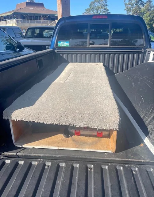

You shouold check FB Marketplace - people sell them all the time. I got one for free that someone had made for a 3rd gen and it fits perfectly. It was super ratty and gross, but I cleaned it up and it's great now.
2024 Tacoma Anybody done a DIY sleeping platform ? IMG_0973
2024 Tacoma Anybody done a DIY sleeping platform ? IMG_0974
2024 Tacoma Anybody done a DIY sleeping platform ? IMG_0942
2024 Tacoma Anybody done a DIY sleeping platform ? IMG_0971
2024 Tacoma Anybody done a DIY sleeping platform ? IMG_0970
2024 Tacoma Anybody done a DIY sleeping platform ? IMG_0977
2024 Tacoma Anybody done a DIY sleeping platform ? IMG_0969
2024 Tacoma Anybody done a DIY sleeping platform ? IMG_1191

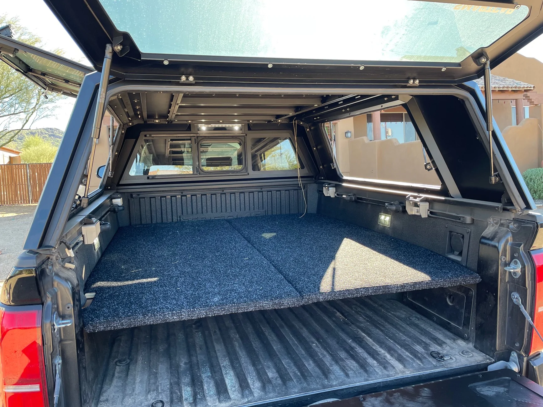

I built this as a two piece across three 2x6 (maybe 2x8) planks. I used the biggest that fits. Two 3/4” plywood sheets. Measure out the shape of the bed and cut with a skill saw and multi tool. Wrapped with indoor/outdoor carpet from Home Depot. Really easy and cost only $170.
if I did it again I’d lay down adhesive to better secure the carpet and I’d use real marine grade carpet. But it works great for right now and I’ll redo the carpet

in a couple years.
in a couple years.
Nice! This looks like a good option. Thank you

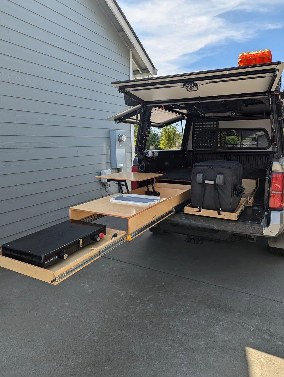

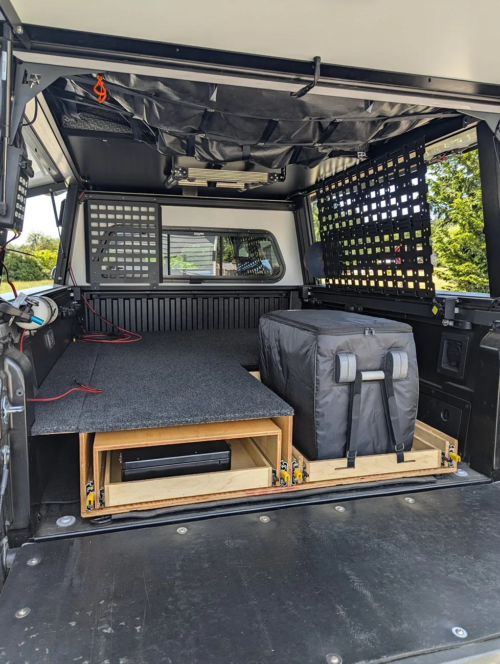

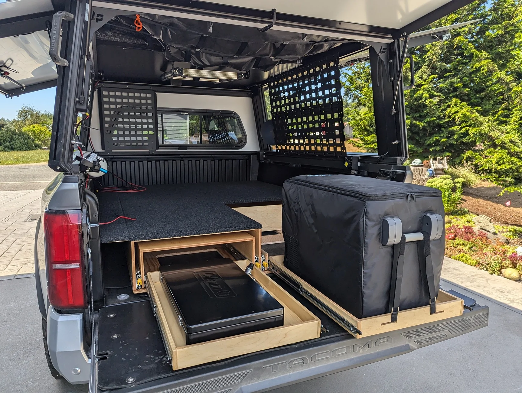

My set up is more involved but if you have some woodworking skills it might give you some ideas. Having drawers under the bed allows you to store quite a bit of stuff and you can customize it any way you like to fit your needs. I have maybe $500 in this whole thing and that includes the slides and everything.
2024 Tacoma Anybody done a DIY sleeping platform ? PXL_20240803_204854748
2024 Tacoma Anybody done a DIY sleeping platform ? PXL_20240803_204811450
2024 Tacoma Anybody done a DIY sleeping platform ? PXL_20240803_205038806
That's awesome ! Nice work man. I have some coworkers who have some good wood working skills, so I'm gonna get together with some guys and bring some ideas

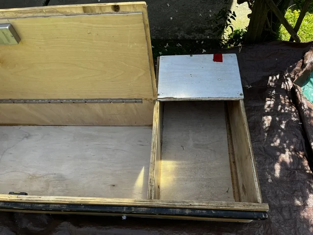

Thanks for the kind words. If you're interested, here are some photos of the build-out (along with a bunch of other photos I've shared w/the forum).
