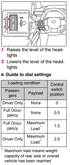

Do you guys have any idea what the recommended setting is? I don’t have my truck yet but I’ve watched a ton of videos and that was the question I had about the adjustable low beams.
I’m assuming the highbeams have a fixed setting.

From the owners manual:
