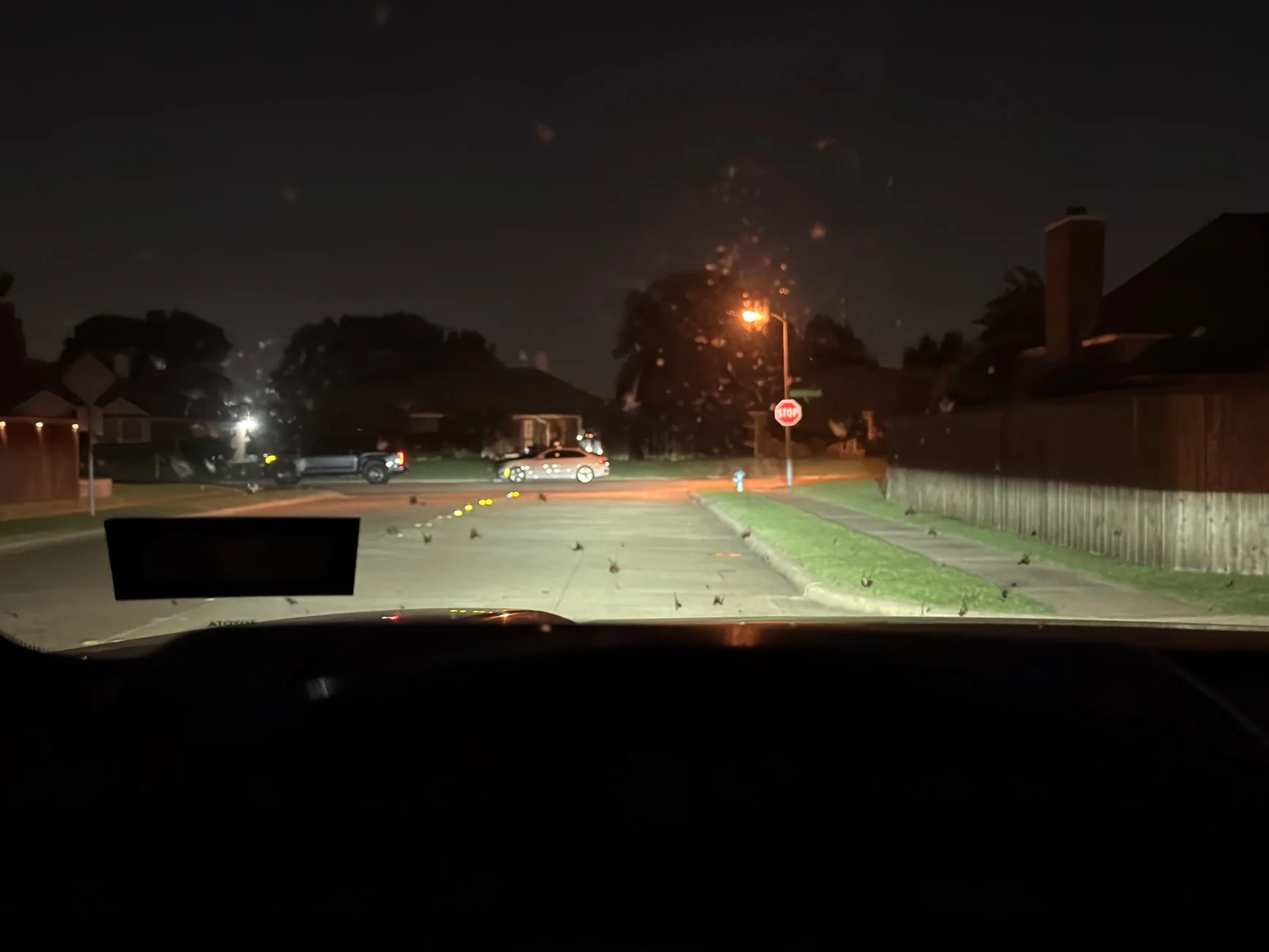

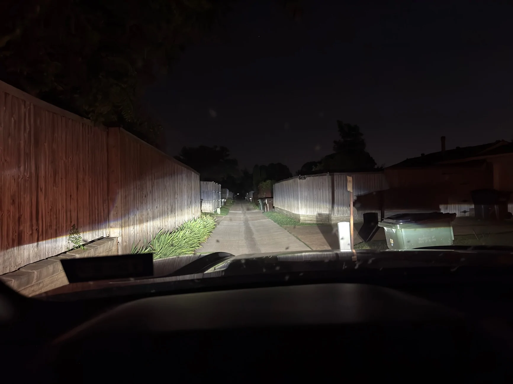

Finally installed my TRD Pro lights today. I absolutely had to mechanically adjust the aim after install because on level 5 they were way low still. Got them to the following results in the photo which based on Google is about 250 ft to the brick of the house from where my truck was. That’s on level 5 and leaves some room to aim them down as the truck squats under load. I’ll probably drive on 4.5 most of the time.
Anyways, love the way they turned out. Both low beam and high beam are definitely significantly better than stock. And the amber DRL/turn is just awesome. It’s super bright and way nicer than the stock amber bulb or any aftermarket LED bulb.

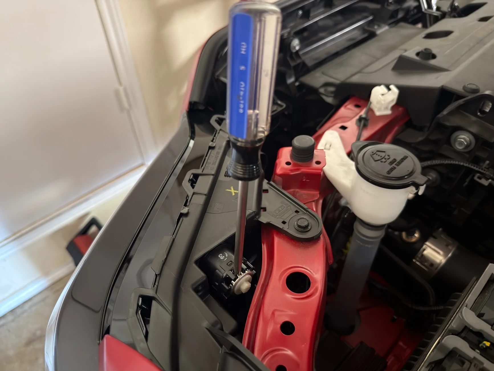

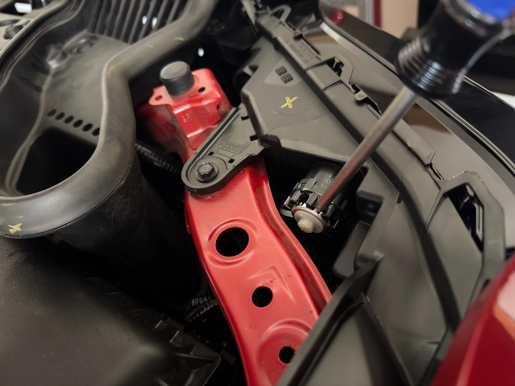

I set the leveler on 5, aimed the truck at my garage door from about 15-20 feet away so I could actually see the pattern move, then just stuck a screwdriver down in the spot it goes in and turned until the beam went up some. Then matched the other side and went for a test drive. Decided where I had them was good enough for 5 and that I wouldn’t want them any higher any other time, and left them alone.
My assumption is that a factory TRD Pro is both taller and has less rake, needing the lights to naturally be projected lower. Then they go on my truck that is stock besides taller tires and can’t see much of anything with them.
