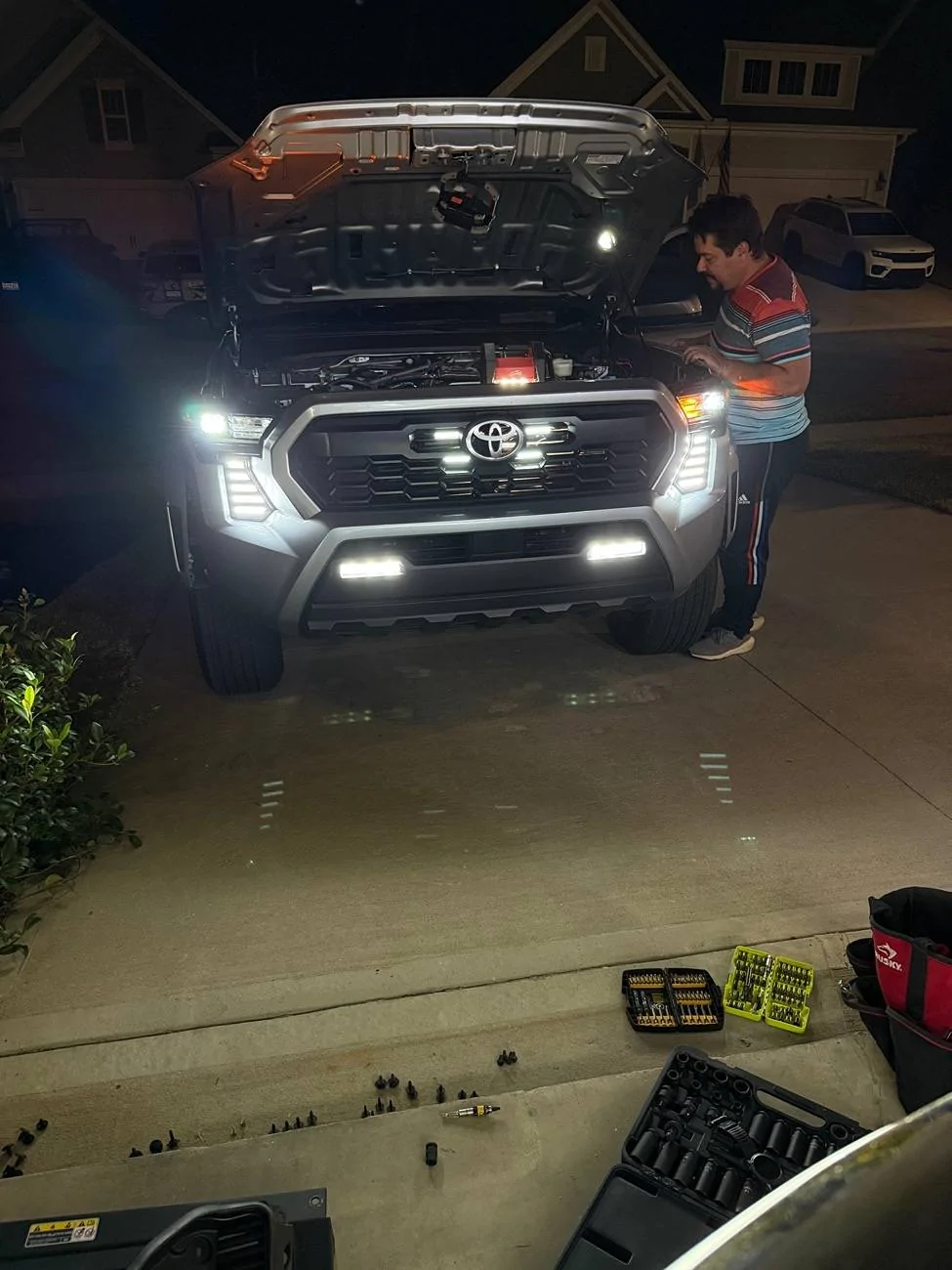

I installed the fang fog lights using the Tundra’s video
