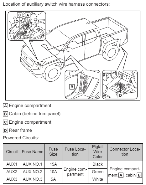

The instructions for the aux pig tails is god awful. It took me a few hours to figure out what was going on. Bear with me here and let me know if I need to re-explain some things...
You can have as many taps into your negative wire as needed.
2024 Tacoma Aux wires not getting power 1717203920032
In the 2 bags, you have 3 pigtails. One is a 4-pin with 4 wires, another is a 4-pin with 4 wires and the black wire is connected to a 2-pin, and the other is a 2-pin.

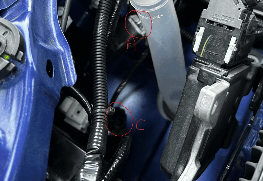

No matter what, you will use one of the 4-pin pigtails. You can either plug the 4-pin into the image above harness A (engine bay) or harness B (kick panel). If you want to use harness D, you must use use both the 4-pin pigtail connected to the 2-pin. If you want to use D, you have to plug the 4-pin into harness A and the 2-pin into harness C, that will provide power so you can use the 2-pin pigtail for harness D. For some stupid reason, Toyota used the pinout for the 15amp to the rear, so you may have to rewire the connector if you don't need a 15 amp circuit.
For Aux 1 (15amp) you use the black wire as your positive (+), black/white as your ground (-)
For Aux 2 (10amp) you use the green wire as your positive (+), black/white as your ground (-)
For Aux 3 (5amp) you use the white wire as your positive (+), black/white as your ground (-)

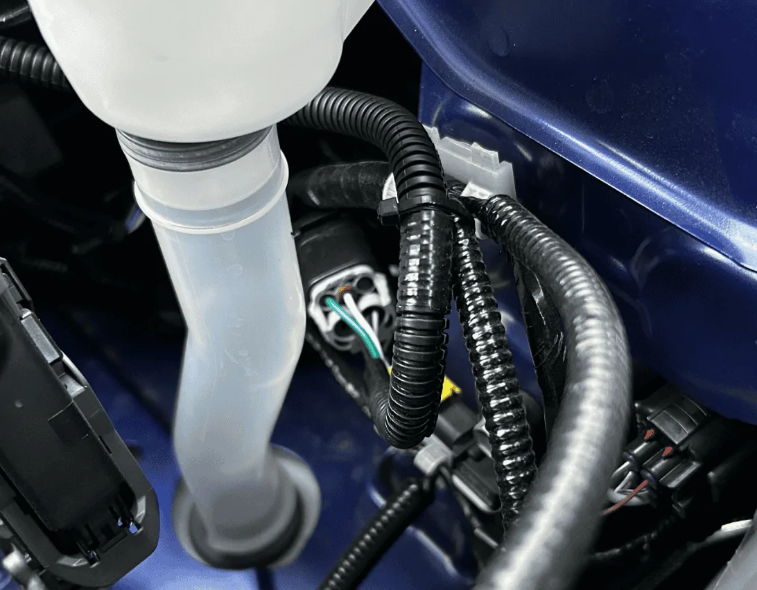

Here is the 4-pin pigtail plugged into A. The only wire I'm using is the black 15amp circuit and the black/white ground.

If you want to send voltage to D, plug your 4-pin-to-2-pin harness (be sure to remove the cover first):
