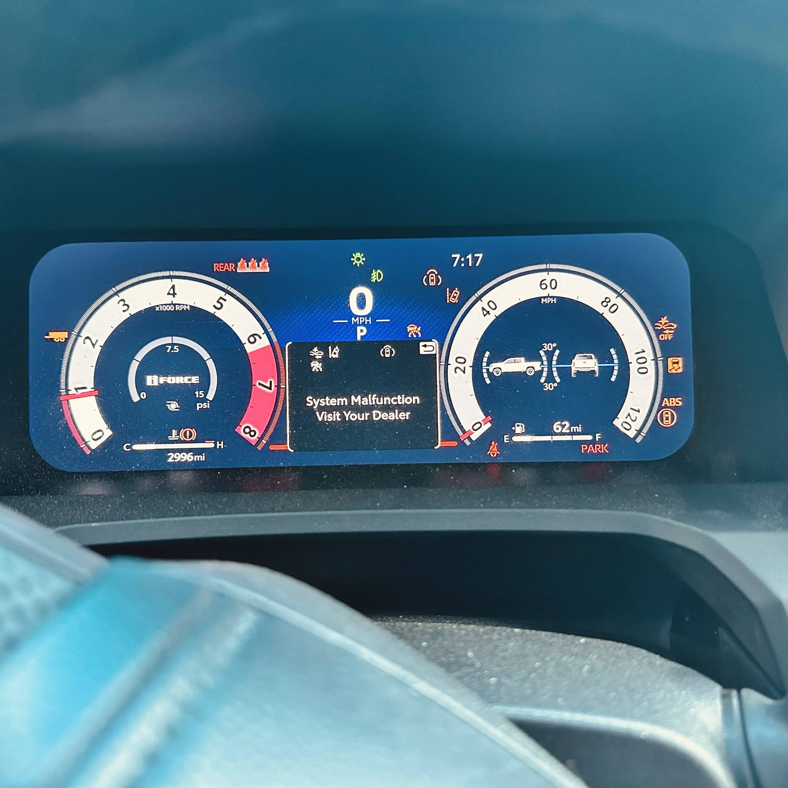

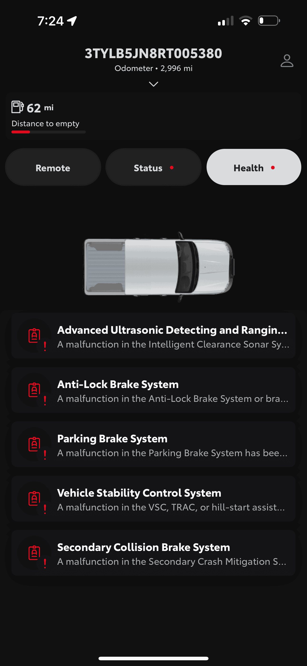

yes sir, checked and double checked before I turned the power on. I didn’t have the engine lights before I wasn’t getting power to the head unit. I checked the fuses and then I got those .initially I just didn’t get power to the radio.
Yeah do you have an update?
