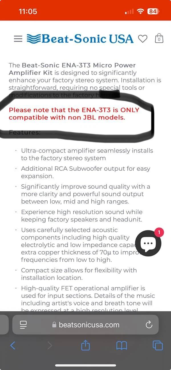

3T3 would work as well for the JBL folks. BeatSonic is waiting to install at 3T3 onto my OR premium w/ JBL. They didn't mention it wouldn't work. I believe primary difference is it has a port for a sub connection.
Yes we can ship to Canada.
-Josh
Following as I have the JBL but wanted to add an external amp for a sub in addition to the factory setup w/BeatSonic but thought this wasn’t an option according to BeatSonics website.
Yes confirmed with them it will work on the JBL systems as well!
