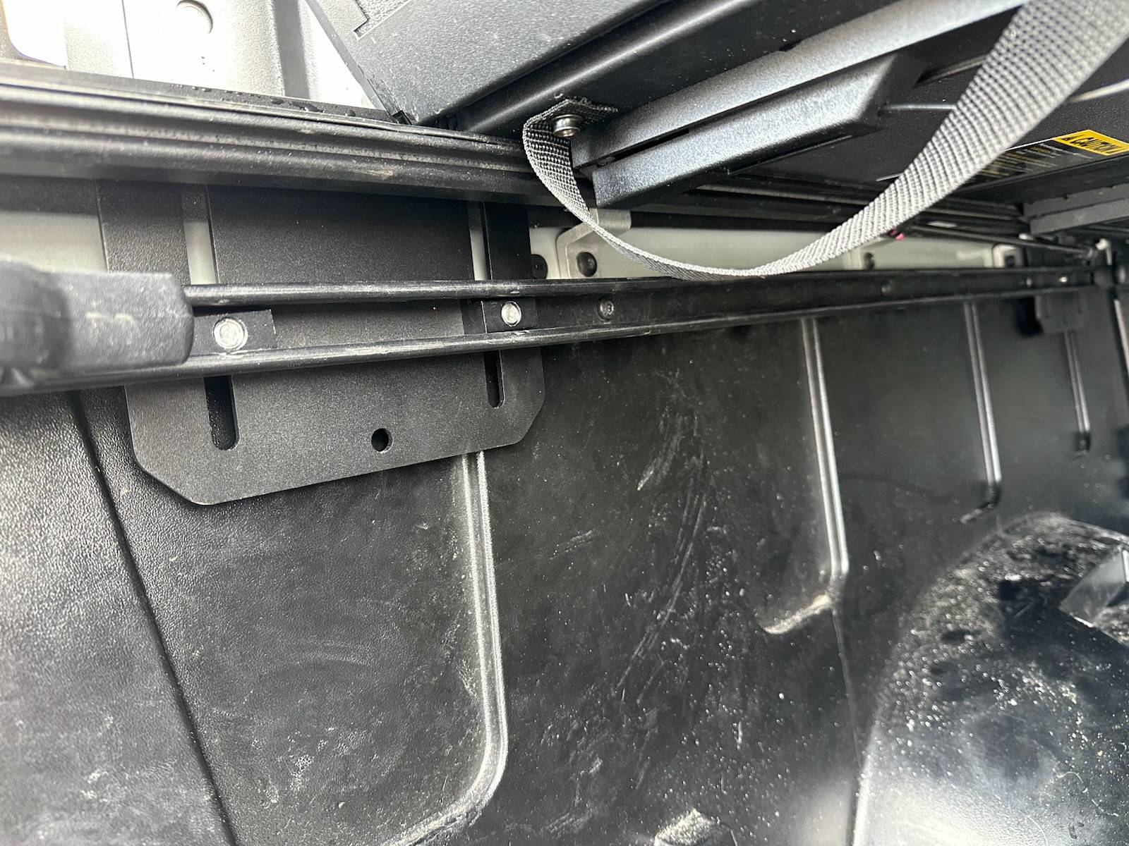

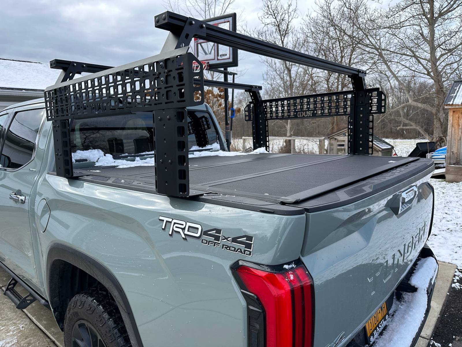

We have had a customer or two pull off our T-Series racks with the Factory Bed Cover.
Sorry I don't have much to contribute regarding roof racks, but thought I would pass this along.

Did they have to do any modifications or just straight from factory? I know would most likely add a gap and be less water tight but I’d be fine with that
Two holes drilled in the utility rail per upright was all this customer needed to do.

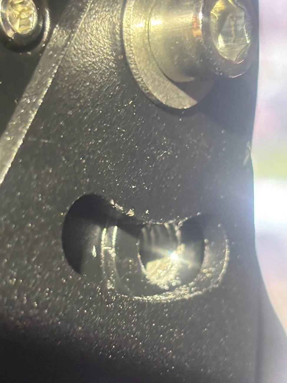

That’s a lot of hardware. All the black washers and screws are all regular steel. Since the washers are the wrong size they really should be replaced anyway. Or at least for people with OCD.
I like how on their installation video they tell you where the roof screws go that you “can use silicone if you want to”.
I also had to drill out the holes on the light bar because they were too close together and you couldn’t fit the second screw in
