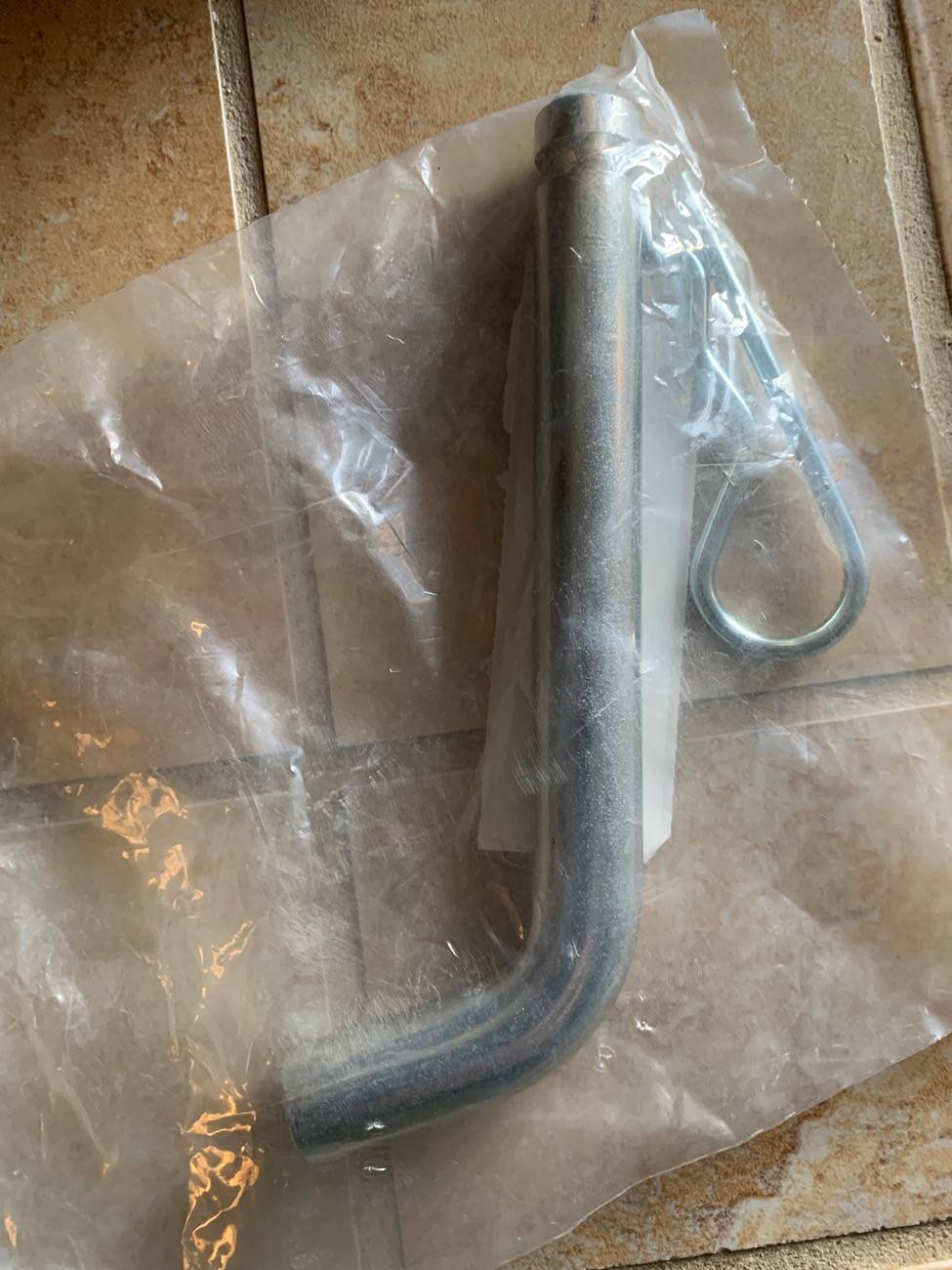

I had something similar on my 24’ OR. It was a part the dealer had left on the glove compartment. It was loose, and would roll over and thump against the side.
In addition to the rear seats, glove compartment and center console you have a storage in the bed side.
2024 Tacoma Braking- stopping at intersections, red lights IMG_7283
