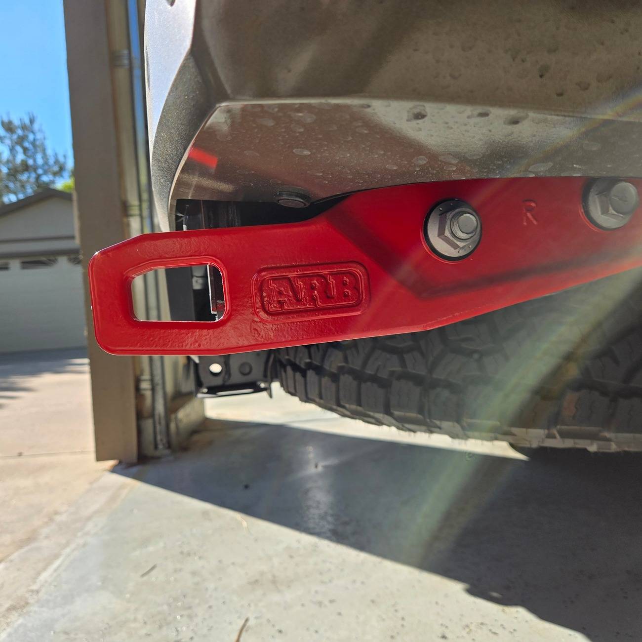

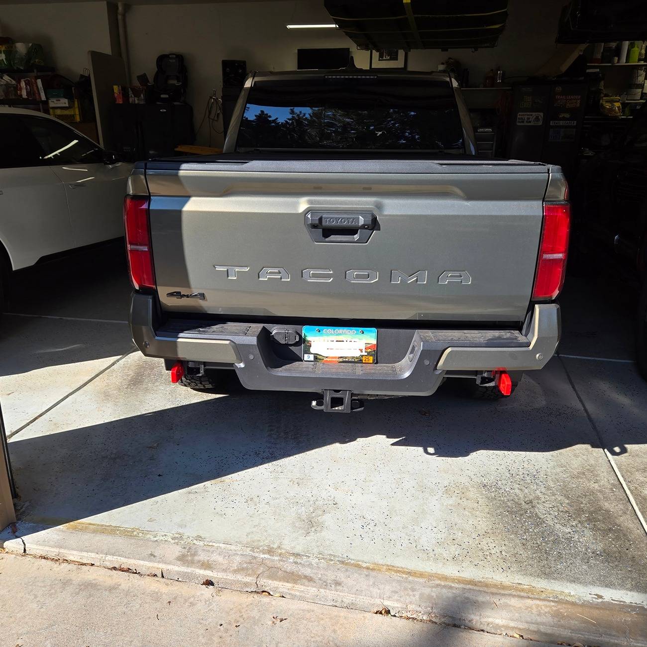

Completed what I had in mind for my build, not to say more won't be coming. The last two items were the easiest installs.

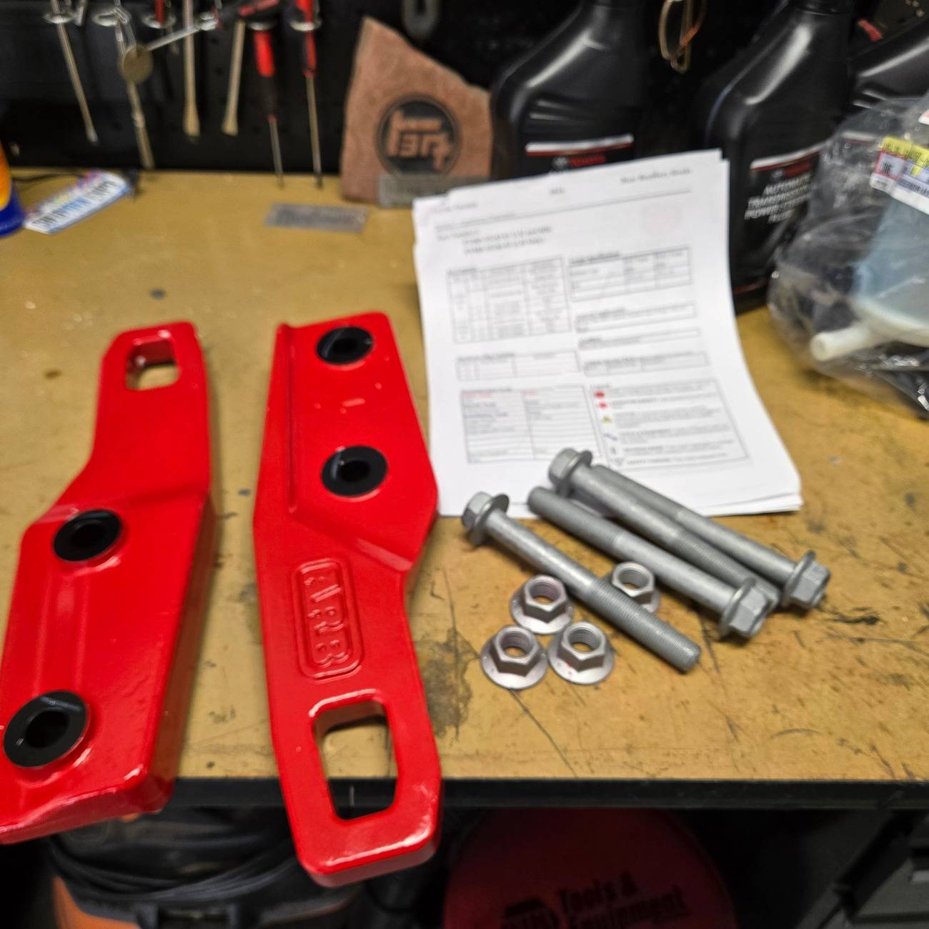

I bought the ARB Rear Tow hooks from Toyota during a 25% off sale (They happen a lot)
Thinking this will also provide some rear bumper protection. I did say some. Very easy install with 4 bolts

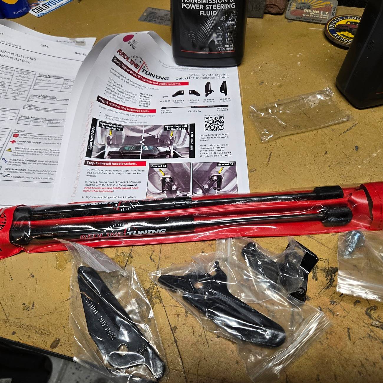

Then the hood prop seemed like a bad choice by Toyota. My 200 has props and this is a newer vehicle
Several struts out there, this one was a simple install and I believe at least on other wanted to drill a hole. I may be wrong
I bought this set https://www.redlinetuning.com/2024-Toyota-Tacoma-Hood-QuickLIFT-PLUS-p/21-27022-02.htm

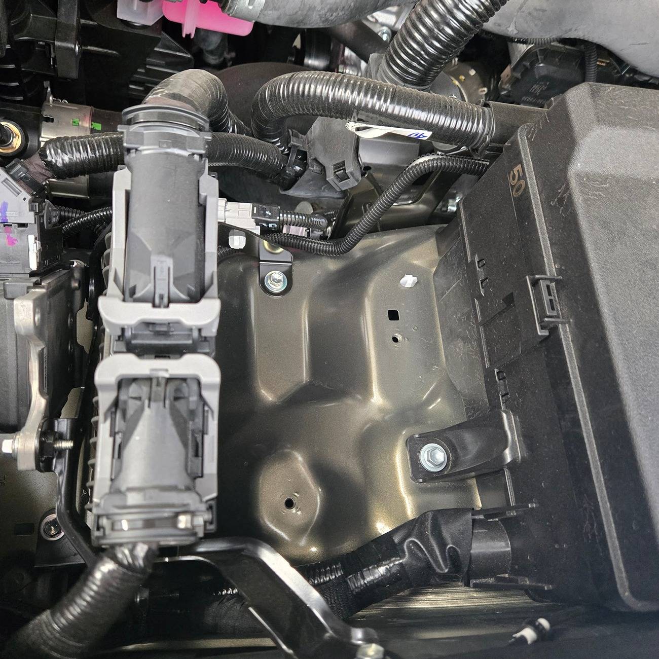

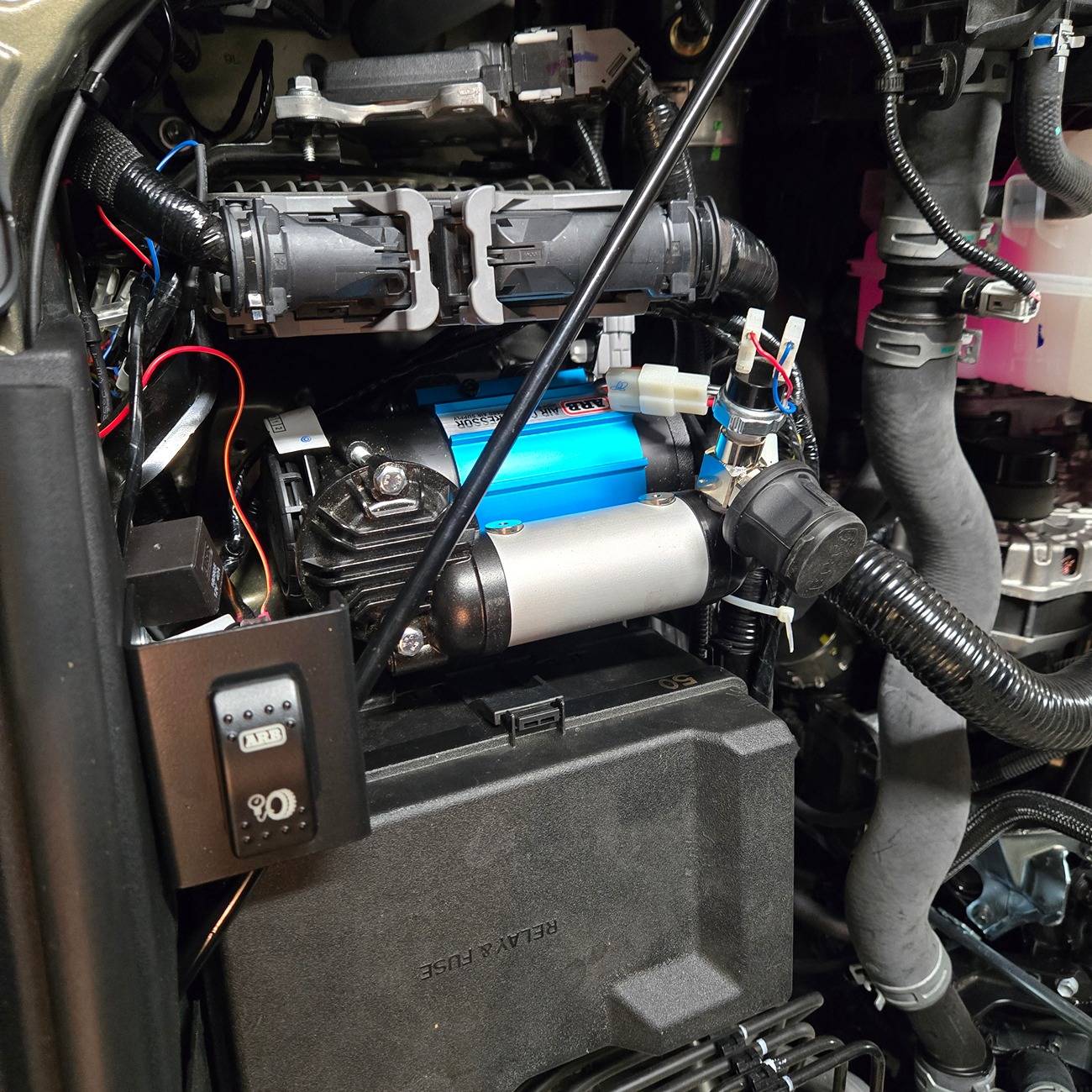

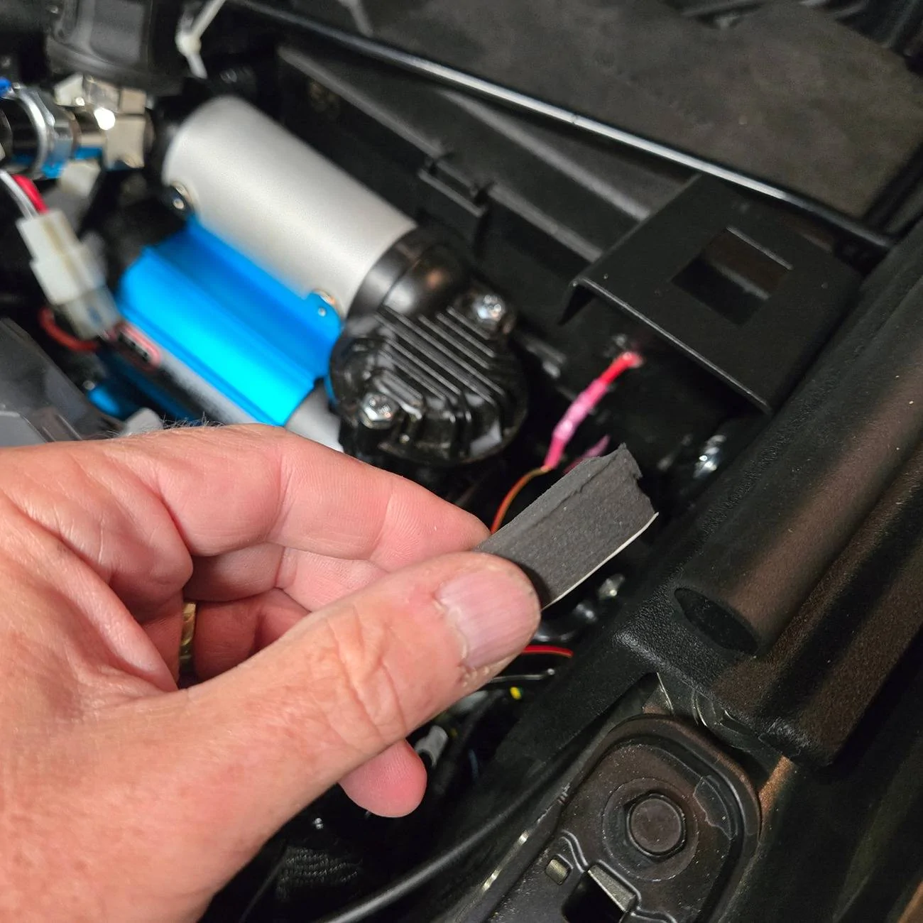

I went over the options on the air compressor. I have always liked the twin ARB as it is fast. I looked at portable units and ended up going with the single ARB compressor as it would fit in the engine bay. I prefered mounted giving one less thing to carry. I didn't want to move the ECU to fit the twin as I have concerns about long term reliability with the ECU and warranty due to no long term testing. ECUs are pretty key components.
I installed the ARB in an open space on the drivers side of the engine bay. I used the mount discussed in this thread https://www.tacoma4g.com/forum/thre...ing-custom-bracket-3d-print-file-inside.6050/ . I really appreciated his innovation. It was a one off design so I needed to drill out some of the compressor mounting holes to get them to line up. Just a slight modification likely due to tolerances among components. The mounting to the fender wall fit perfectly.

I used a fuse tap to tie into the IGN Fuse to make sure it only activates when the engine is on. Drilled a small hole in the fuse box to run the wire and then sealed it with plumbers goop
2024 Tacoma Build Thread Romer's 2024 Tacoma Off Road Bronze Oxide 20241018_113342
I used a single rocker holder I got from Amazon to hold the switch and and also put a peice of thick foam behind it.
2024 Tacoma Build Thread Romer's 2024 Tacoma Off Road Bronze Oxide 20241018_130059
2024 Tacoma Build Thread Romer's 2024 Tacoma Off Road Bronze Oxide 20241018_130339

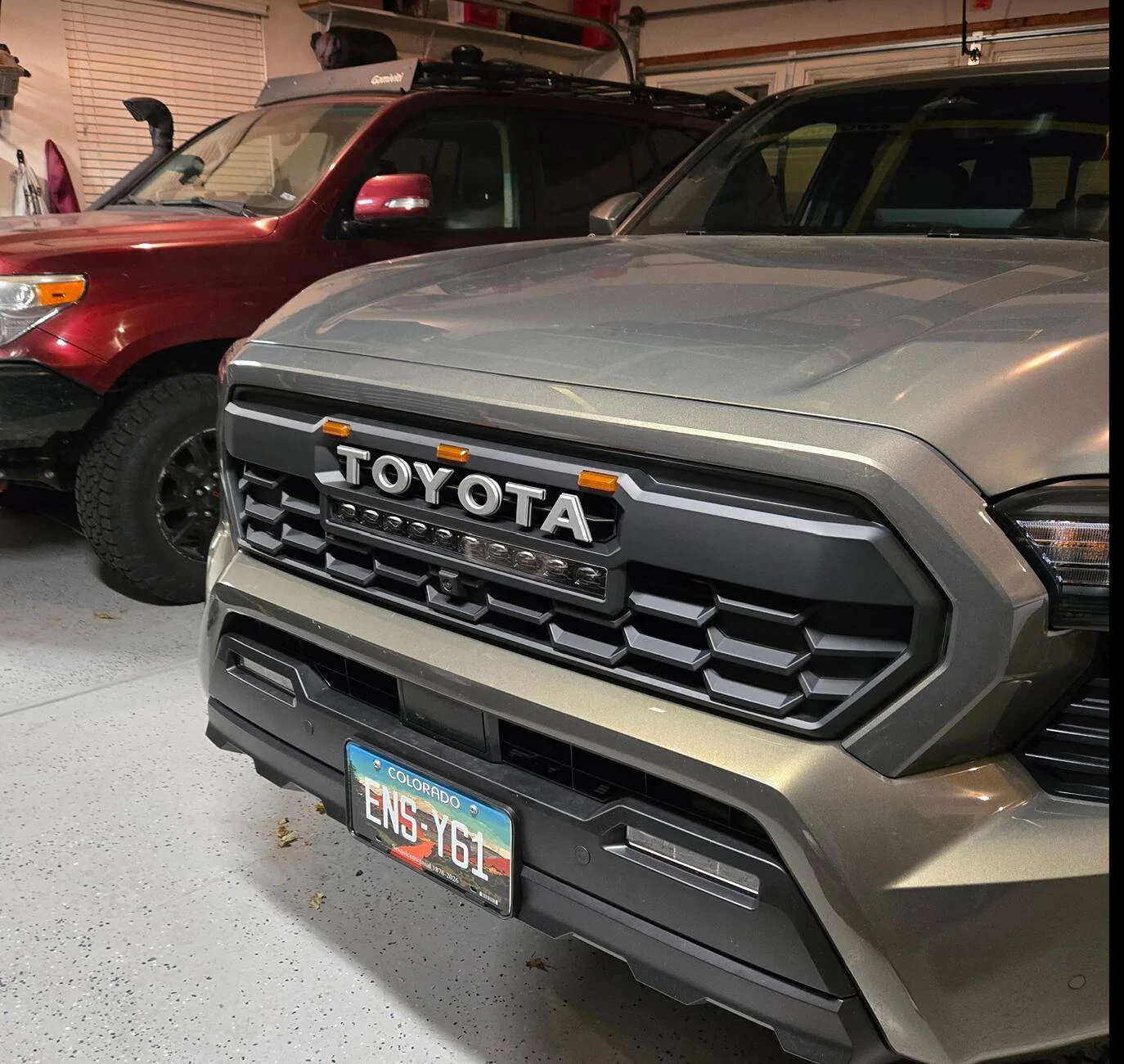

I swapped out the Grill for a lower cost TRD Pro Grill per this video
Only issue was the Rave camera bracket didnt fit and I spent an hour heavily modifying it. If you do this, make sure its corect or get one from somewhere else
Edit: turns out the link in the video is the wrong bracket. Rave responded and said I should have used this one https://raveoffroad.com/products/camera-bracket-for-aftermarket-tacoma-grille-2024
The light bar puts out a tremendous amount of light. Well worth the cost on its own

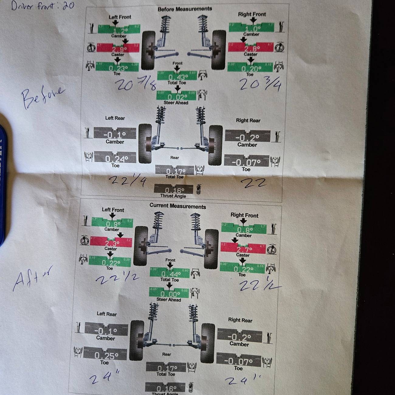

I just had the Allgogsoffroad springs installed on my 2024 Offroad Tacoma today at R4T and am very pleased with them. I also appreciated the responsive answer to my questions from Alldogsoffroad.
I did not want to spend thousands of dollars on a new lift. I liked these because they allowed me to lift my truck without changing control arms or shocks.
Very happy with the product.

Before/After Alignment and lift changes
