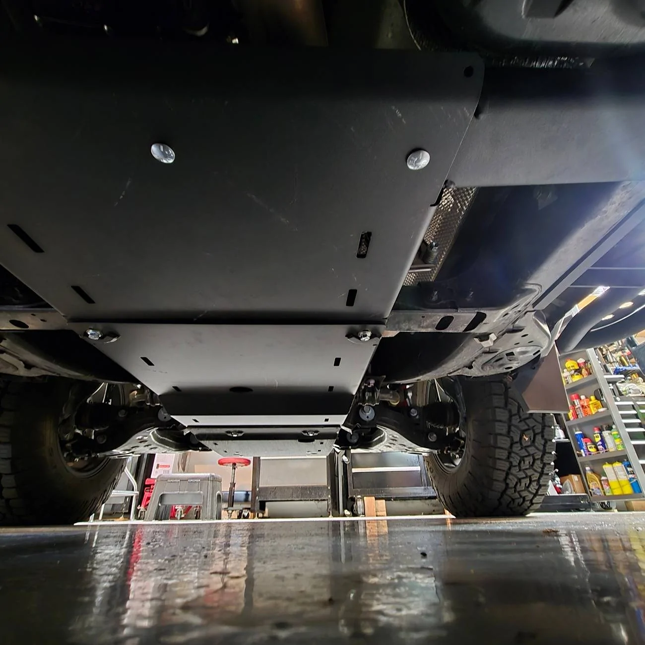

Today I completed my Skids plates
RCI Engine, Tranny and Tcase

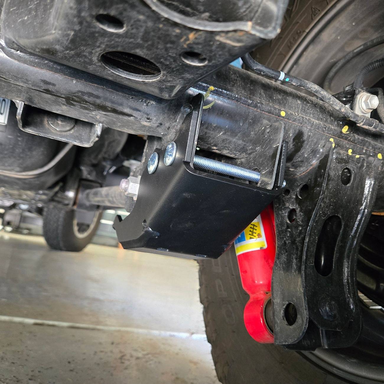

RCI Rear Link Rear
2024 Tacoma Build Thread Romer's 2024 Tacoma Off Road Bronze Oxide 20250531_135538

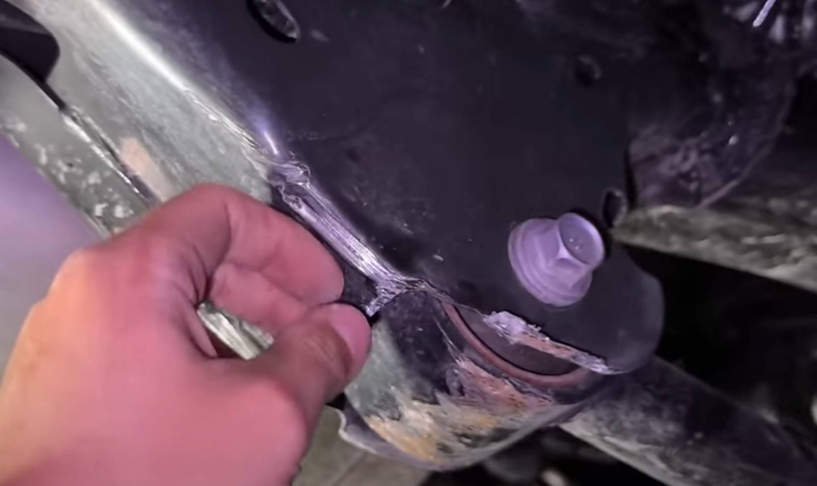

This is a known weak spot. From Tinkers Video
2024 Tacoma Build Thread Romer's 2024 Tacoma Off Road Bronze Oxide Screenshot 2025-06-17 144921

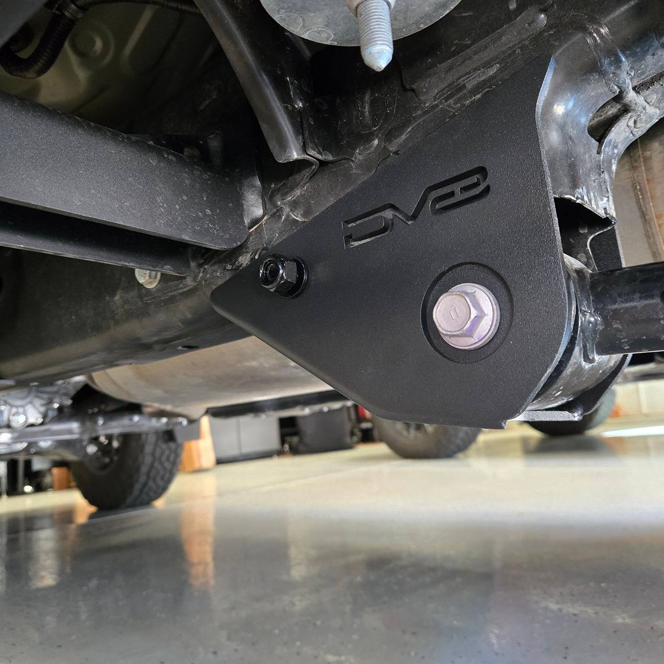

o I tried the RCI Rear Link Front Skid but it didnt work since the top bolt was used by the CBI Slider. I ended up with a DV8 skid there
2024 Tacoma Build Thread Romer's 2024 Tacoma Off Road Bronze Oxide 20250609_105541
Very Happy with it.
I saw this same video, can you post a link to the part you got to protect it? I can't tell between which of the two parts you showed, thanks!

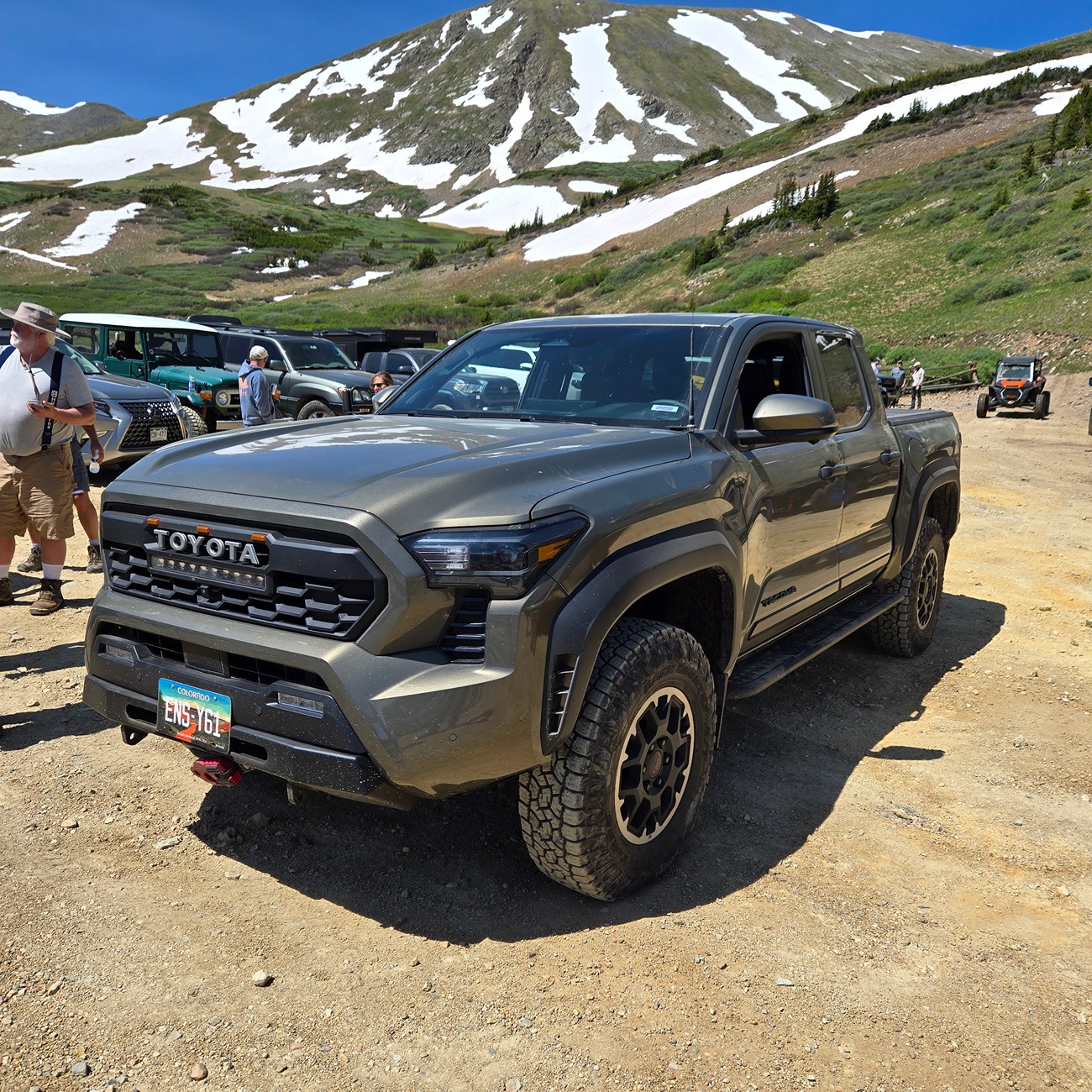

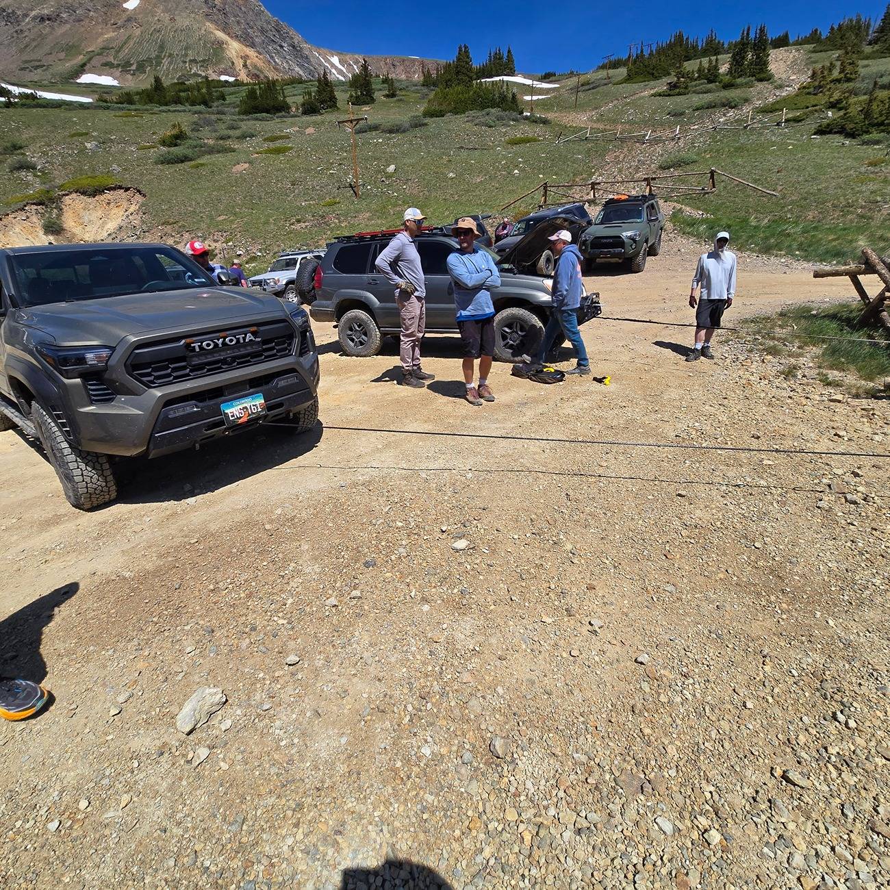

Took my Tacoma on its first off road run today. I took it up Argentine as part of our off road clubs volunteer cleanup day with the forest service.
Understand my comparison point is to my Land Cruiser.
I was very pleased with how it performed
It did not shift from 2H to 4LO. It beeped at me. It shifted from 2H to 4H. Then it shifted into 4LO. Looking at the manual, looks like that is the way it works, although it isn’t clear.

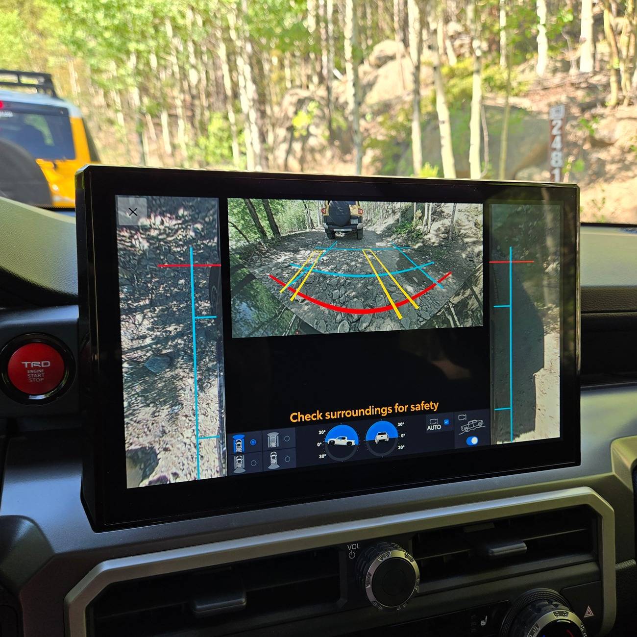

The cameras were nice, but pressing on the front view made it larger than the other two and that was a lot better. The rear camera works well. We hit a snow drift on a narrow shelf road and we had to backup quite a bit to find a spot to turn around. Sometimes the view from the side mirrors made it seem like I was on the very edge when I had a bit more room. They are extended out a bit from the body.
The gears are much lower than my 200 series Land Cruiser in 4LO even with a 8 speed Tranny. This is great for descending on the trail in not needing brakes and making slow climbs over obstacles. The not so good is when you get to wide open mostly flat trail and the RPMs go above 3000 at 12 MPH. This isn’t a big deal, just an observation.
The long wheel base made it harder to turn (Obviously) and it seemed like the full lock steering wasn’t as much as I am use to. Although, this could be a false impression due to my difficulties turning around on the narrow shelf road.
My HAM and GMRS radios worked perfectly and I had great range on both. Much farther on the HAM of course.
My winch worked awesome as we used 4 trucks with winches to bring upright a fence that had fallen over.
I went down an obstacle and I could feel one tire in the air. Likely wouldn’t have happened if I had the detachable stabilizer bar. That contributed to my feeling as it doesn’t have as much articulation as my Land Cruiser. I expected that since the Land Cruiser has KDSS (really cool system)
I was very pleased on how it performed and it did better than I expected. The offroad electronics and smart system are newer version of what I have in my Land Cruiser and it worked perfectly. Very point and shoot as long as you pay attention to your line. I had no issues today on its first run.
My truck is a non-Hybrid and I was very pleased at how it did driving the mountain roads. No lack of pep and made the steep climbs at high speed with no issues. The low torque allowed me to quickly pass the several yo-yo’s driving slow in the left lane when the right opened up.
These are great trucks and if this was the only vehicle I have, I wouldn’t hesitate to take it off road on any of the trails we do.

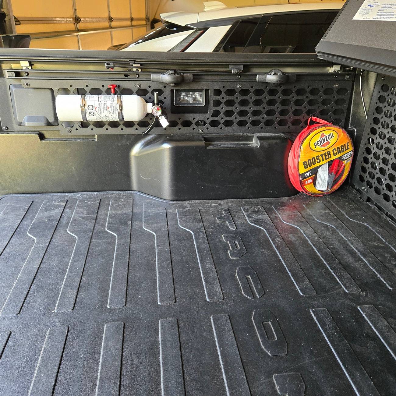

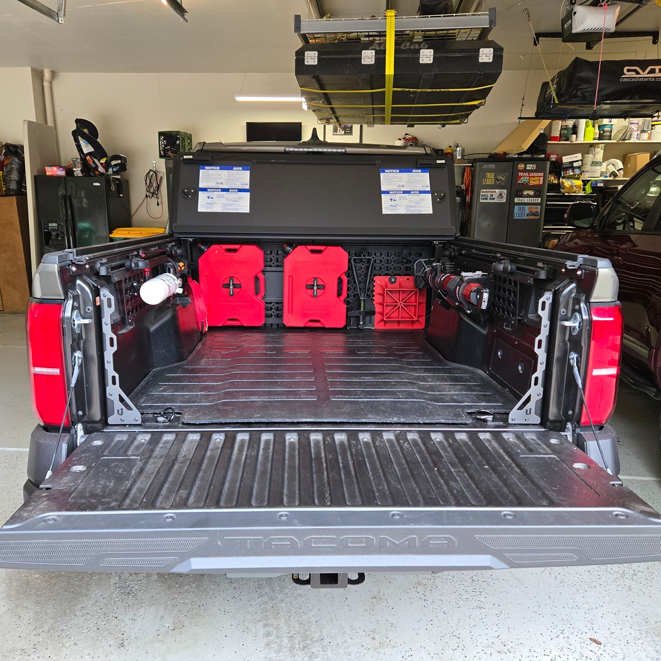

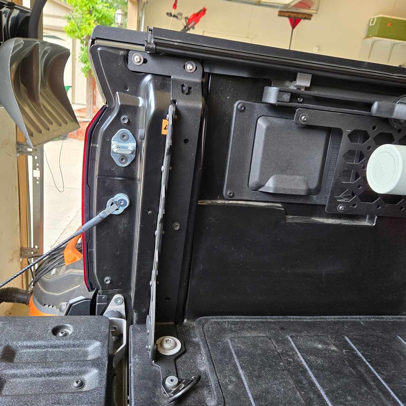

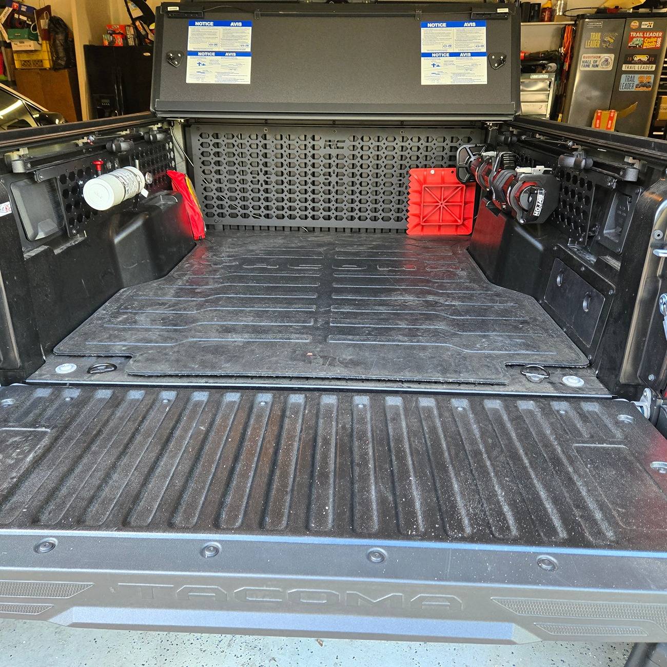

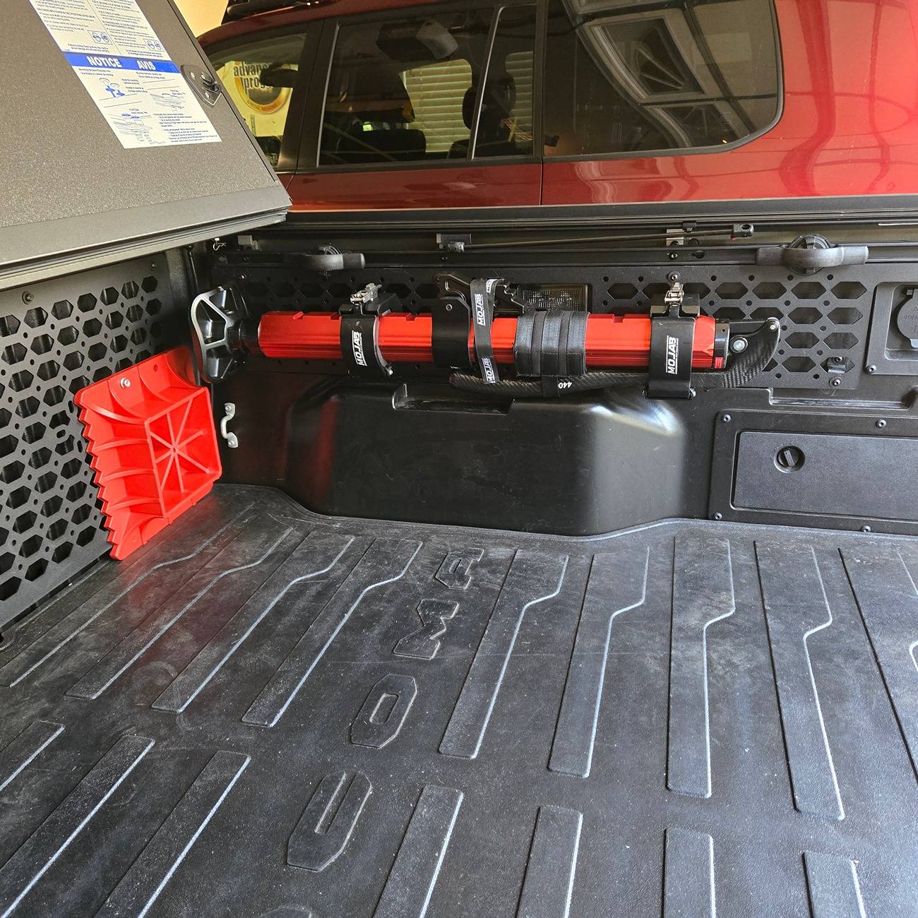

And the final Mod . . . . . . Well, I am sure it isn't the final mod, but it is the end of the build plan I had.

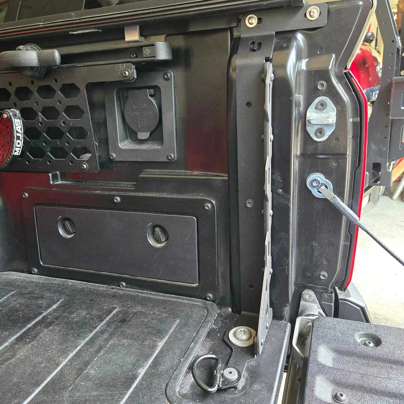

Bed stiffners from Uptop Overland. These are the no drill that also have 3 holes in case you want to drill later on as you add more stuff. I have been pretty good at nutserts so I added one 6M nutsert which fit the bolts that get removed and not reused at the top. I put it right in the middle
2024 Tacoma Build Thread Romer's 2024 Tacoma Off Road Bronze Oxide 20250724_152442
2024 Tacoma Build Thread Romer's 2024 Tacoma Off Road Bronze Oxide 20250724_152455
2024 Tacoma Build Thread Romer's 2024 Tacoma Off Road Bronze Oxide 20250724_152502
Another entry for the Ken Done Gallary, for now :)

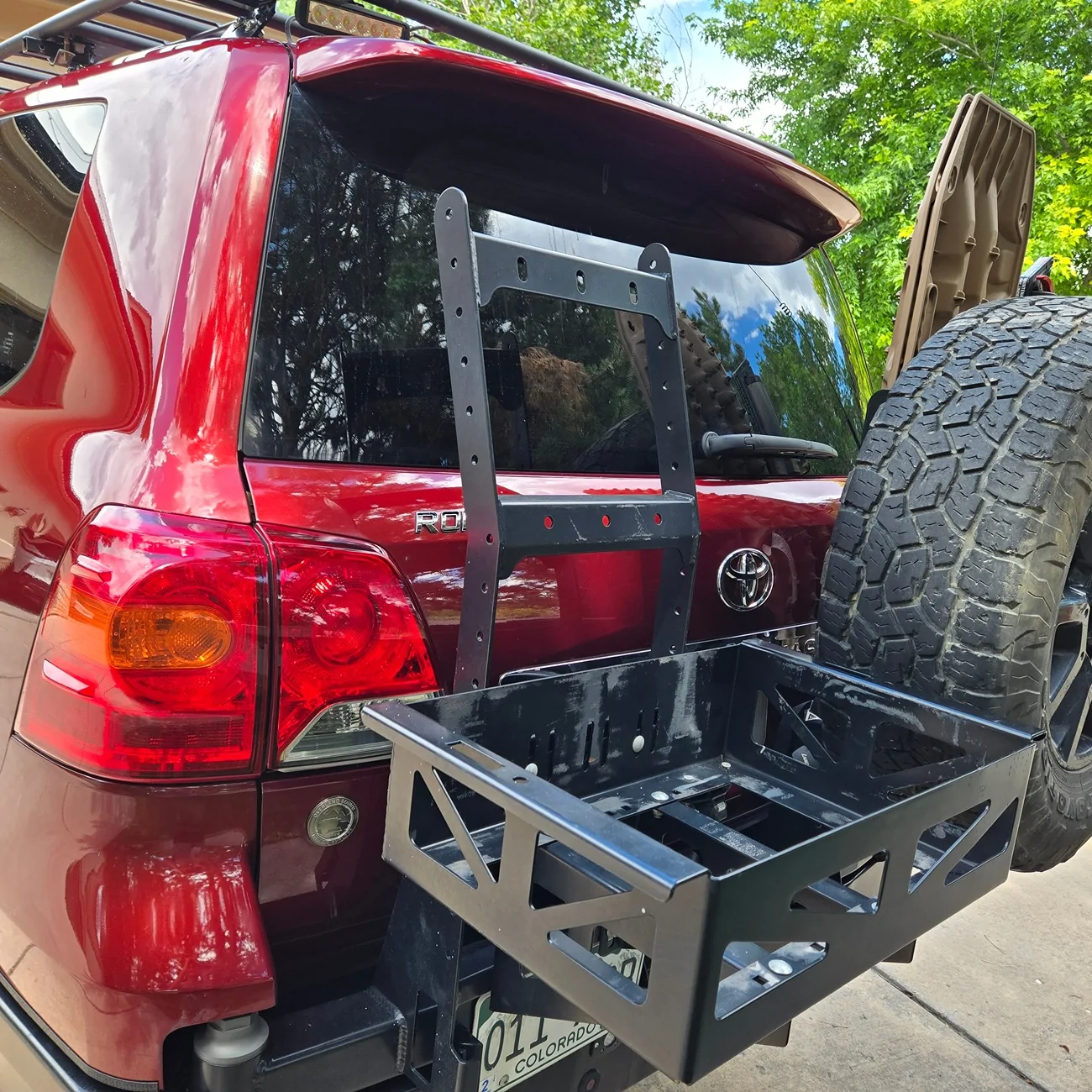

The Tacoma is a great vehicle and a good wheeler. The Land Cruiser 200 seriees is a much better built vehicle and a great wheeler.

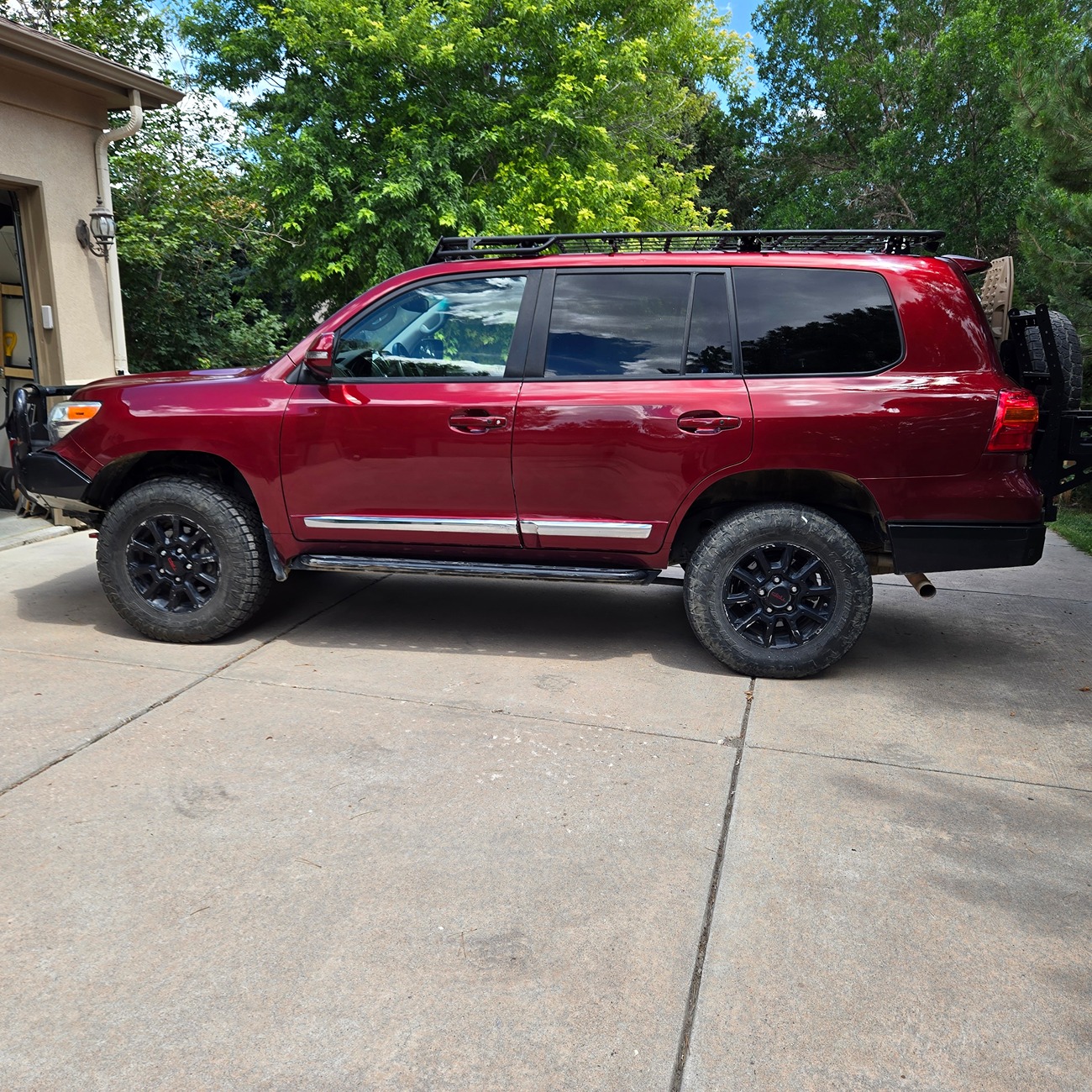

My 200 series land Cruiser after cleaning up from Silverton. I used the Griots Orbital Polisher to get out 10 years of pin stripes and discussed that in this thread on a different forum
2024 Tacoma Build Thread Romer's 2024 Tacoma Off Road Bronze Oxide 20250726_140345
2024 Tacoma Build Thread Romer's 2024 Tacoma Off Road Bronze Oxide 20250726_140406
2024 Tacoma Build Thread Romer's 2024 Tacoma Off Road Bronze Oxide 20250726_140418
I really like have both the Land Cruiser and the Tacoma. They are a great pair and both fun to drive

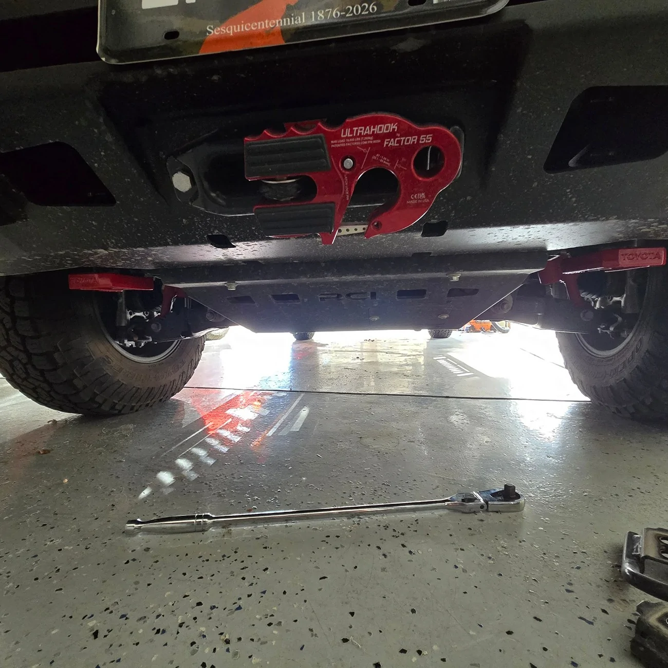

Bought these Toyota Front Recovery hooks on Black Friday. Finally installed them today
took 5 minutes
17mm Socket, power driver and torque wrench set to 75 ft-lbs
