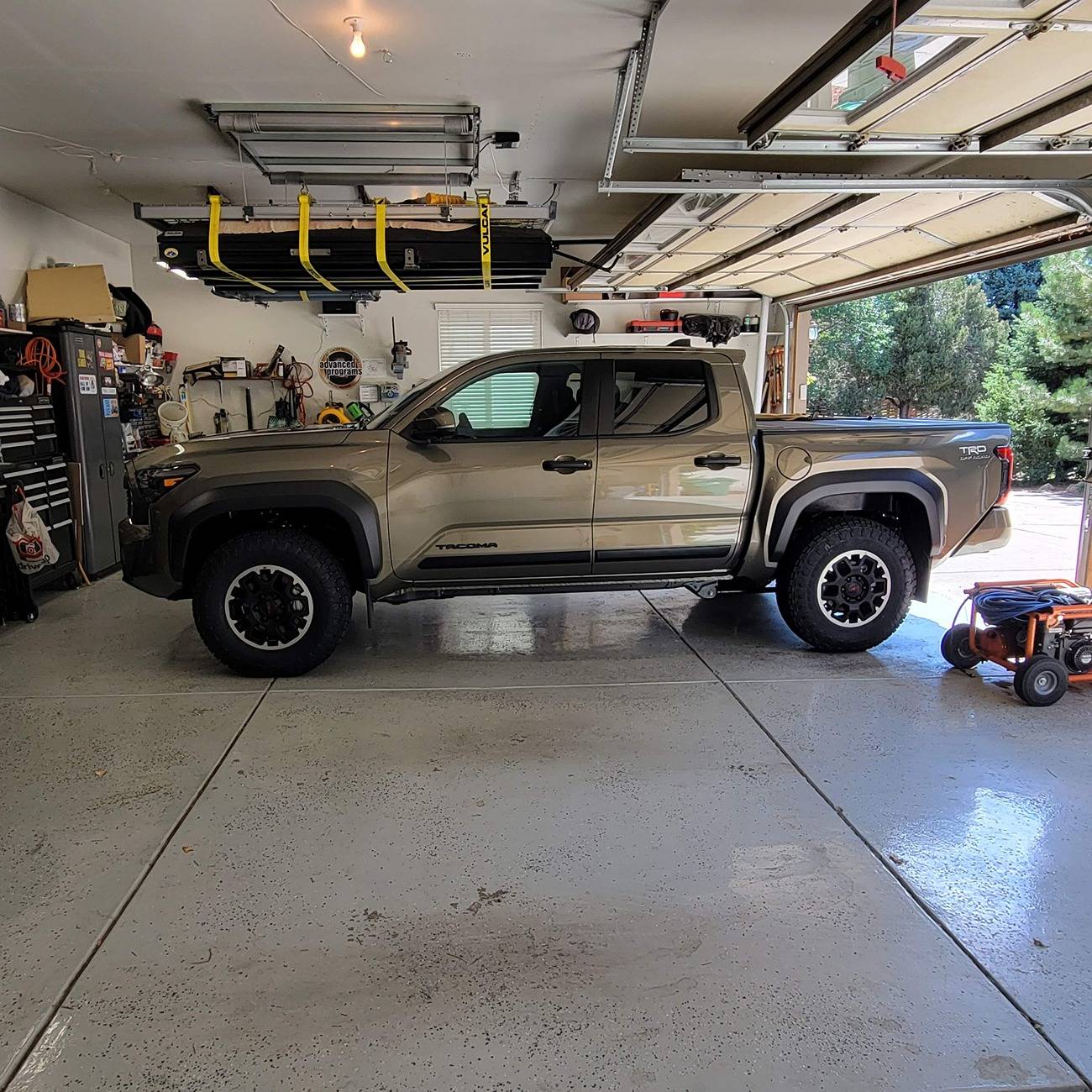

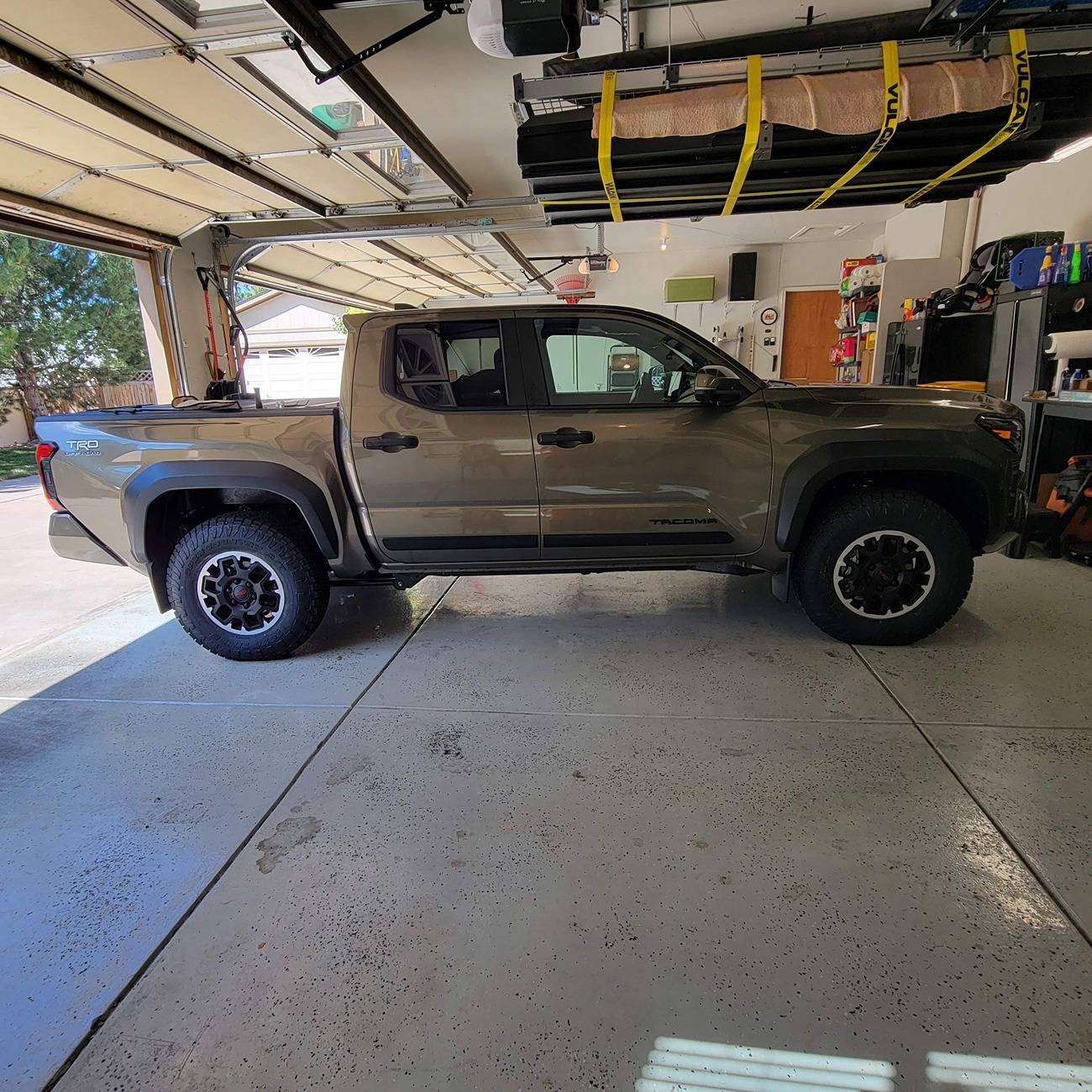

Have any direct side shots with the new tires?
What I took so far is in Post #10. Ill see if I have time before I head out to Ouray. Taking the Land Cruiser.

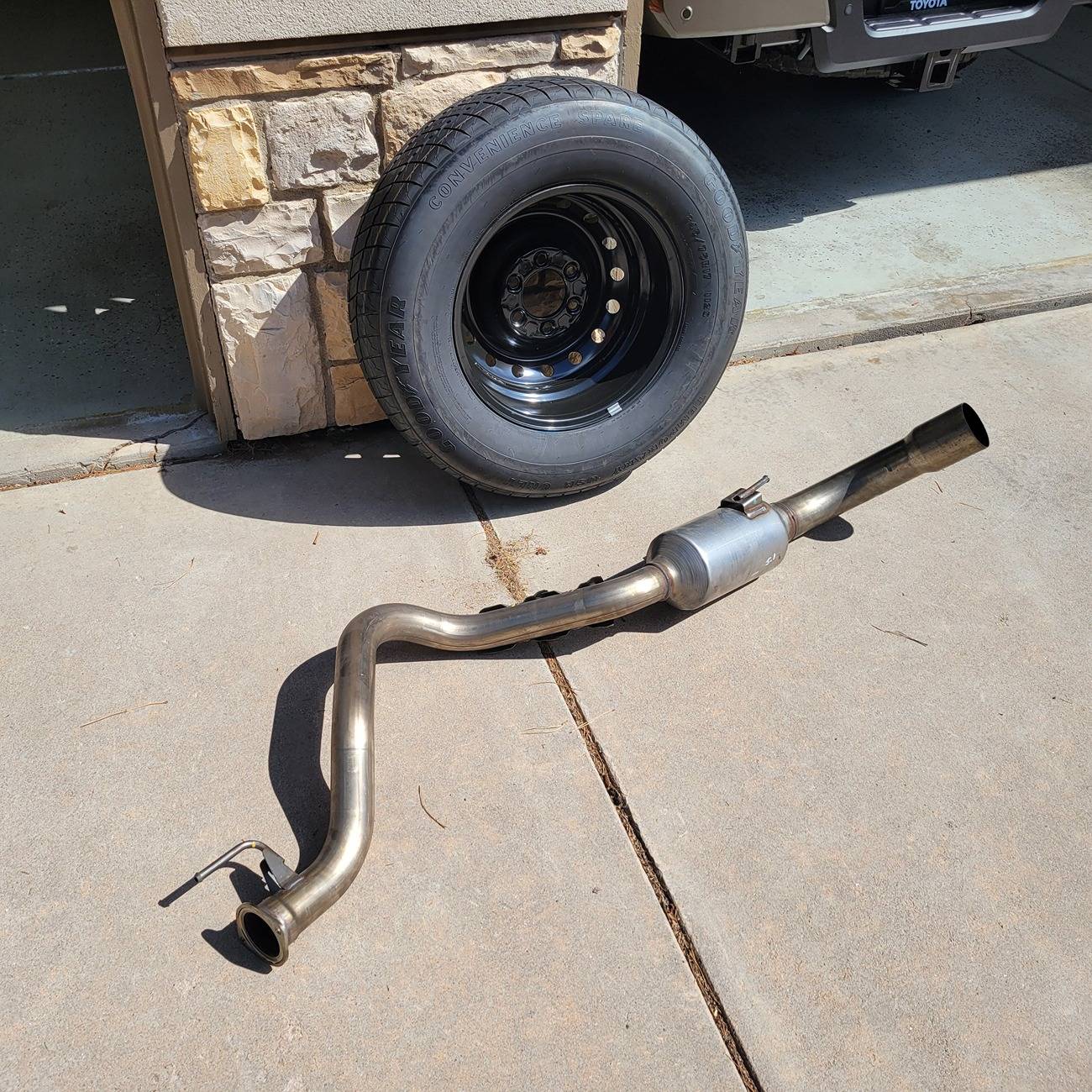

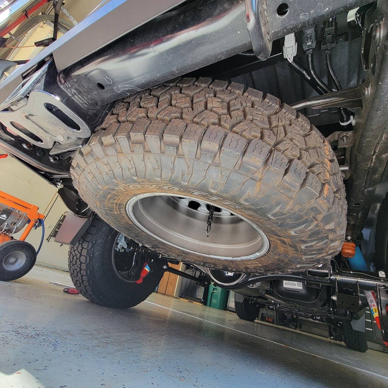

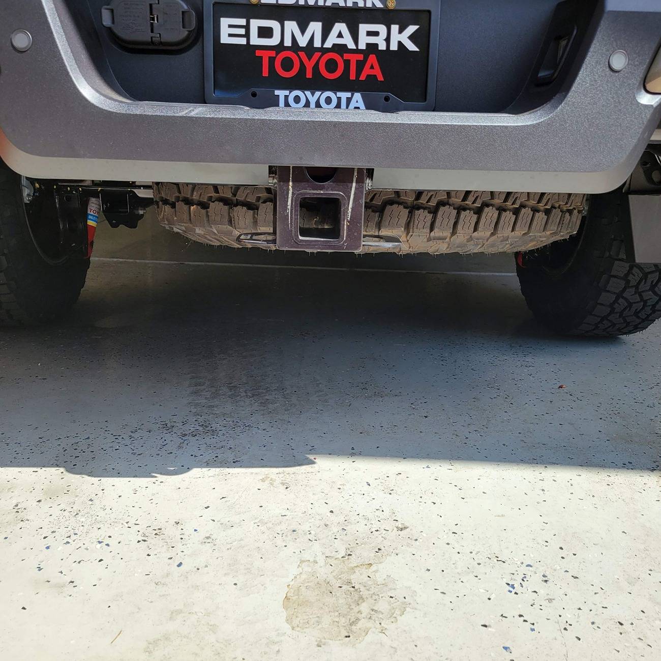

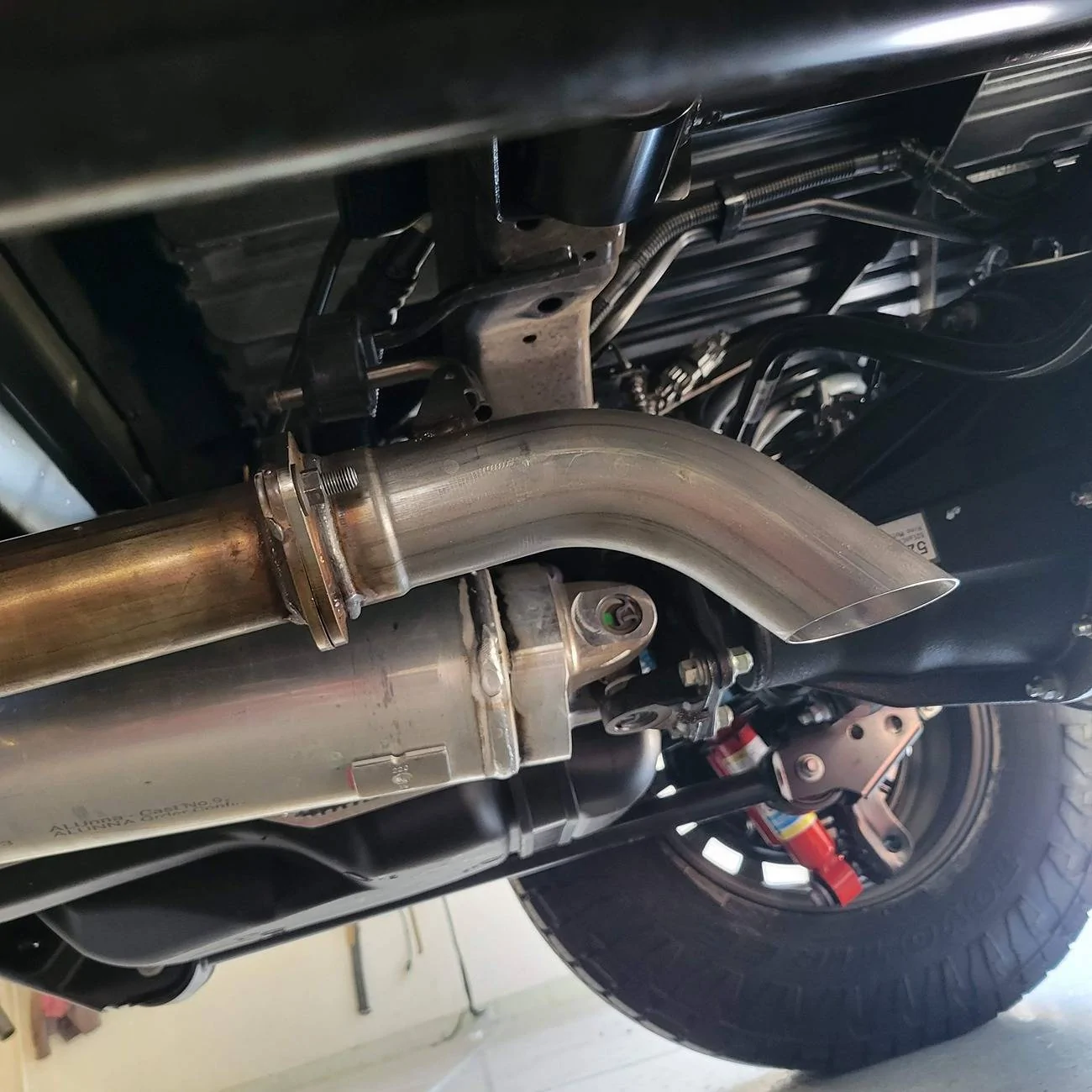

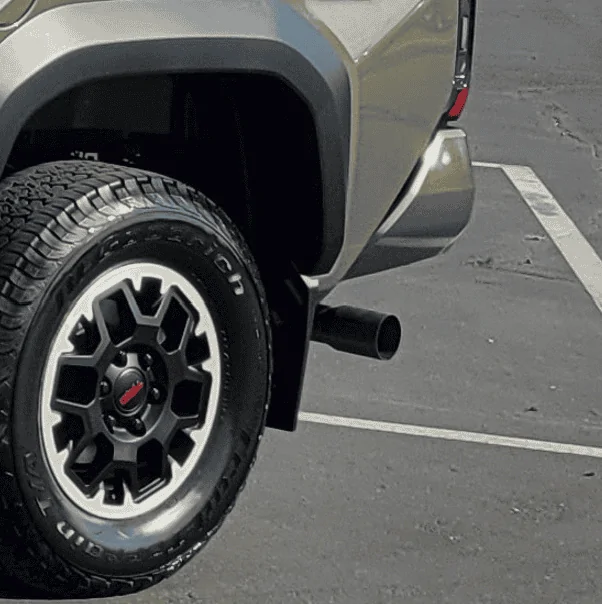

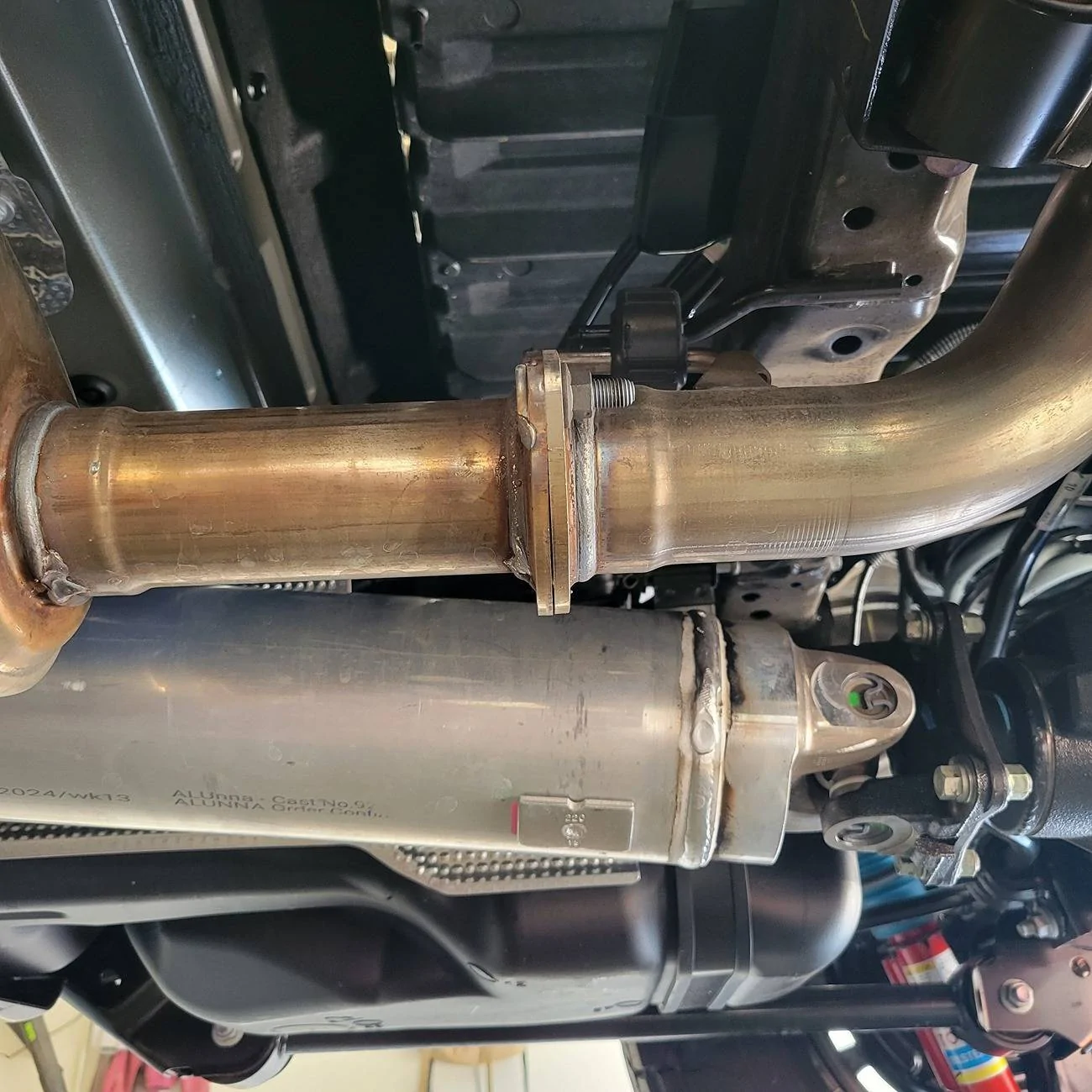

There were two things I didn't like. The short exhaust and the lack of a full size spare. I wouldn't feel comfortable offroad with the smaller temp spare. The exhaust would get smacked and damaged the way it sits
So I removed the back end of the exhaust and installed Toyota part #PT226-35241-AA, offroad tail pipe. It did remove the resonator and I will have to see how the exhaust sounds

I bought a stock TRD Off Road RIM even though the tire would fit on the steel rim. I also bought the same tire I replaced the stock ones with, a 33.1" tire 255 80 r17
2024 Tacoma Build Thread Romer's 2024 Tacoma Off Road Bronze Oxide 20240806_103905
2024 Tacoma Build Thread Romer's 2024 Tacoma Off Road Bronze Oxide 20240806_103233
2024 Tacoma Build Thread Romer's 2024 Tacoma Off Road Bronze Oxide 20240806_103254
Looking at it now, it does seem to sit a bit to the right side. It is in there tight with no movement so that is OK. I haven't tried to adjust it.
The other benefit is the exhaust does not run near the spare tire. I will put these away until I am fully satisfied before getting rid of them

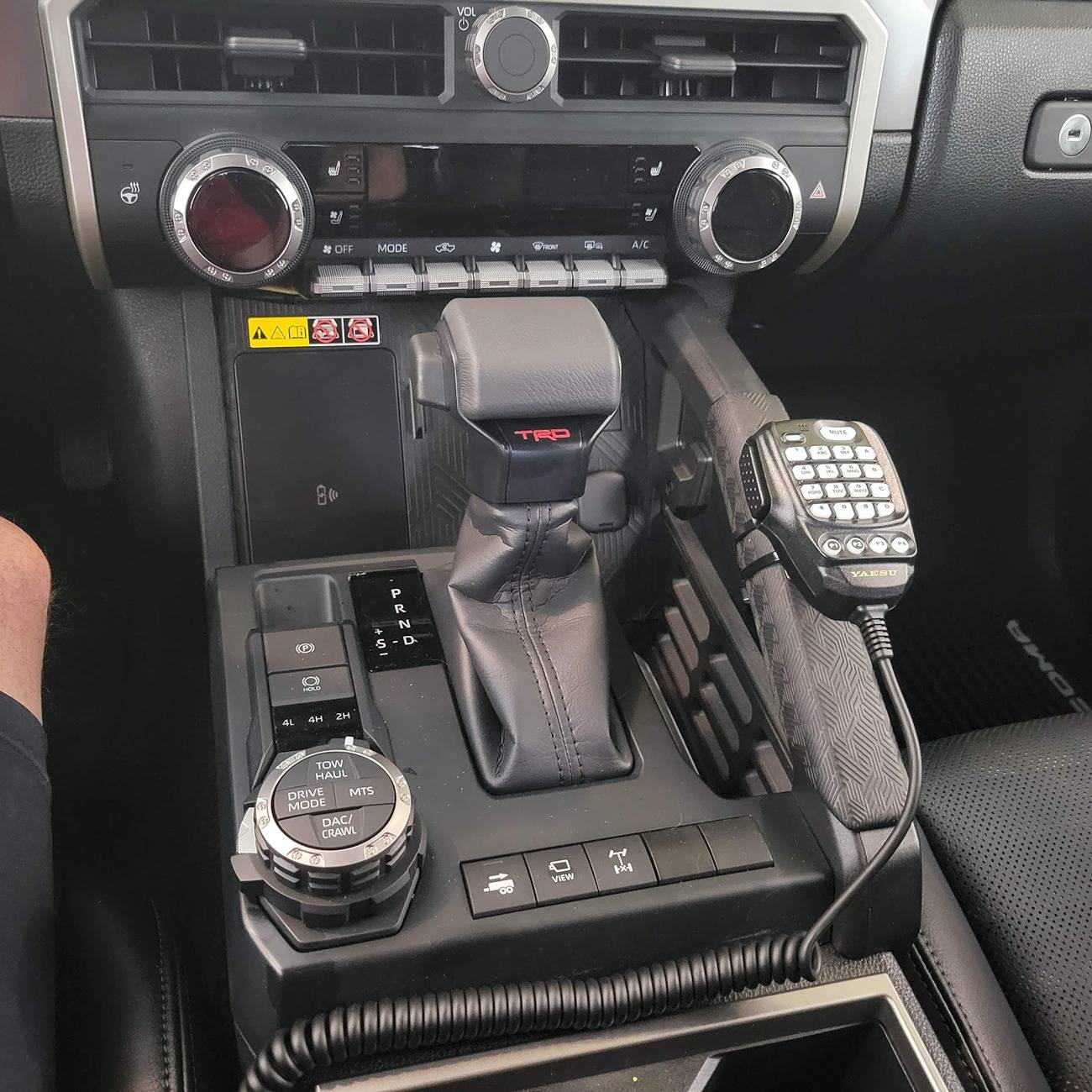

I installed the faceplate and also the microphone using zip ties for the microphone holder
Thinking of running the main unit under the rear seat. Still pondering.
I ran the wires from the engine bay back to the rear cab, but haven't hooked them up yet. Left the fuse out of the fuse holder for safety

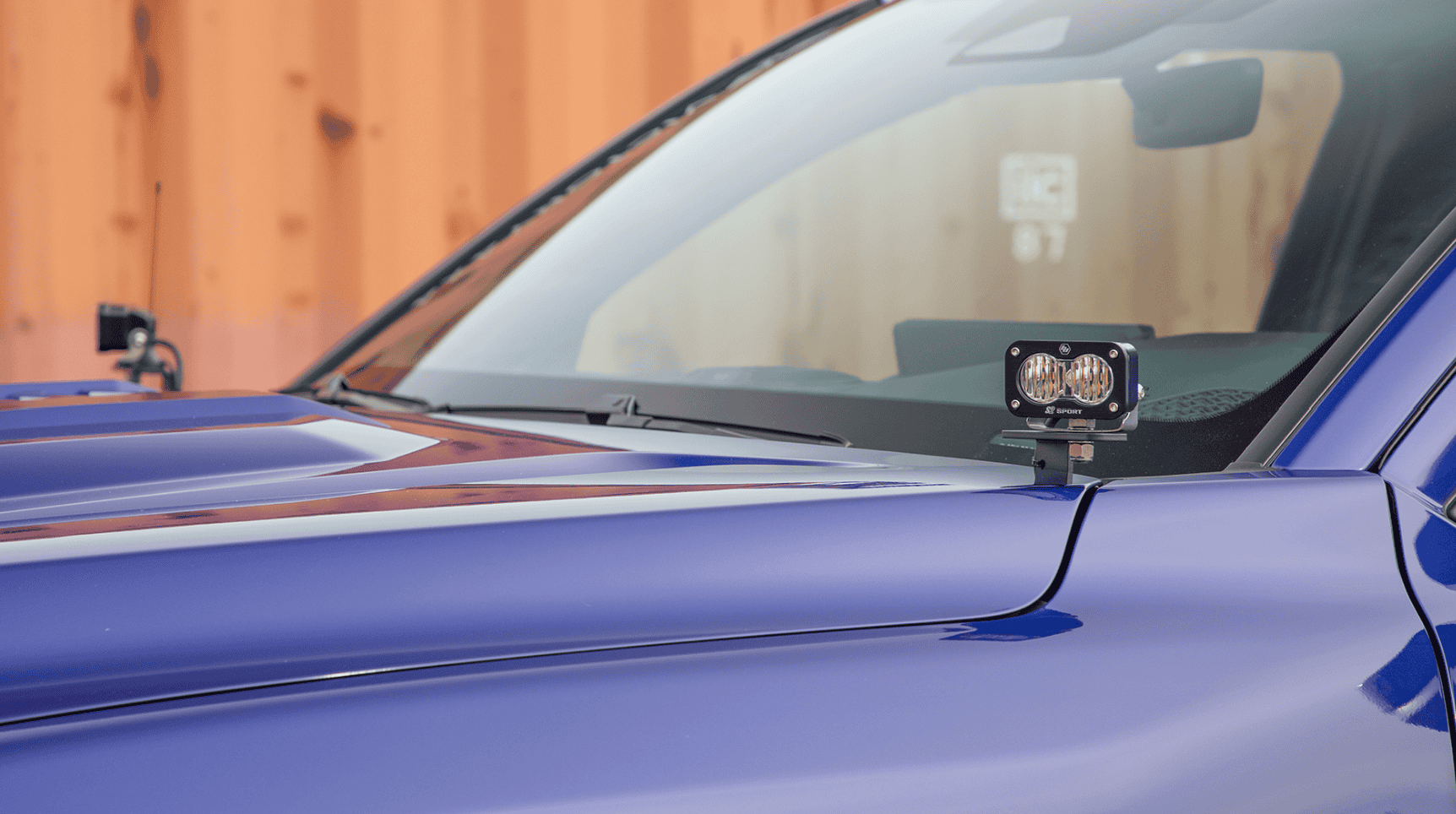

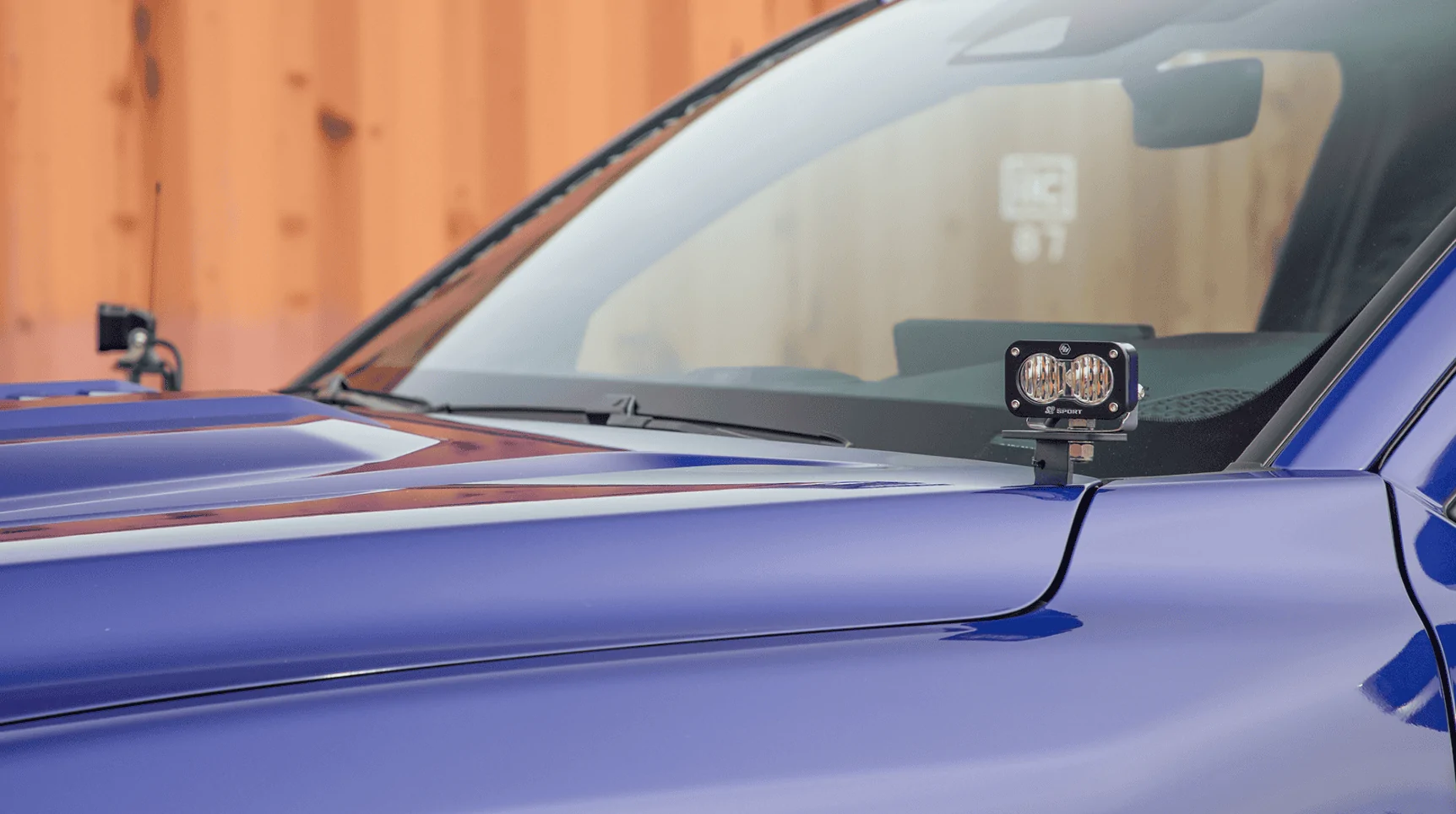

I ordered the ditch light brackets from Victory offroad for the antenna mount

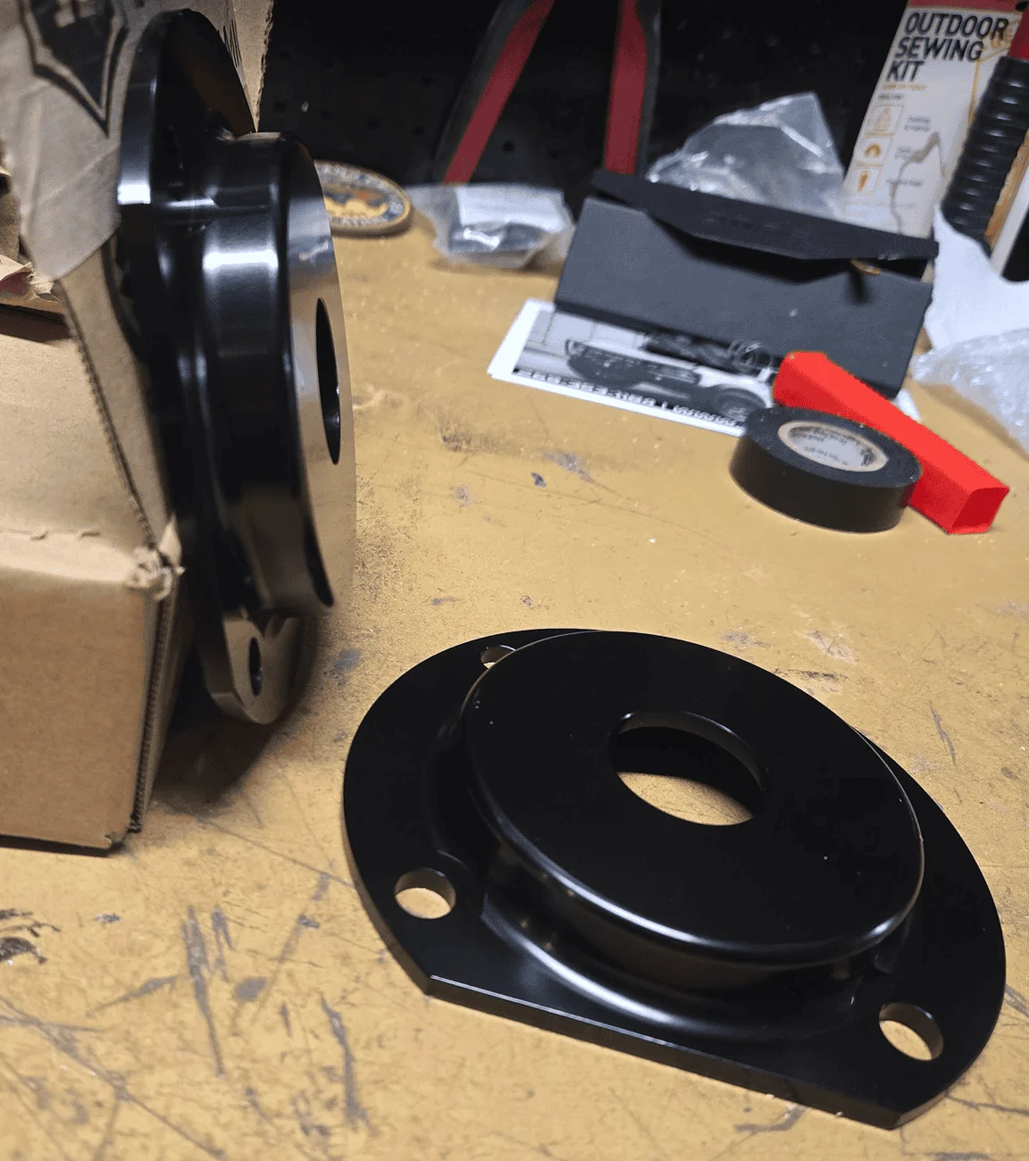

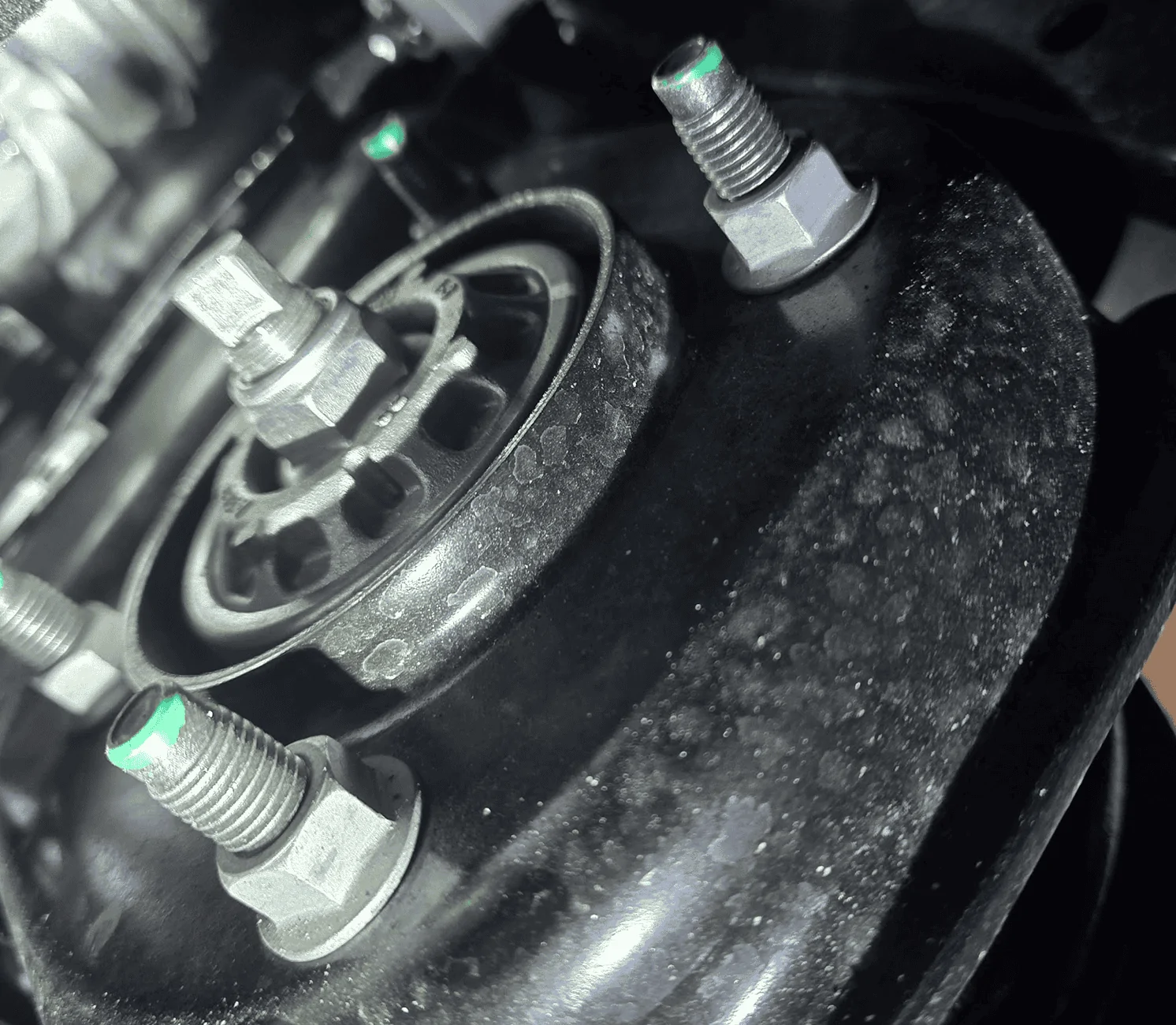

There have been a few Tacomas that have broke the shock top. ICON had one and did some testing and came up with a fix. This is all documented in other threads and I am just repeating here for completness
View: https://www.youtube.com/watch?v=gn2Be4jAj_w
I ordered a set as looks like cheap insurance and they do look robust and easy to install.
The video shows the problem and how to install the fix. I wonder if the 250 has a similar design

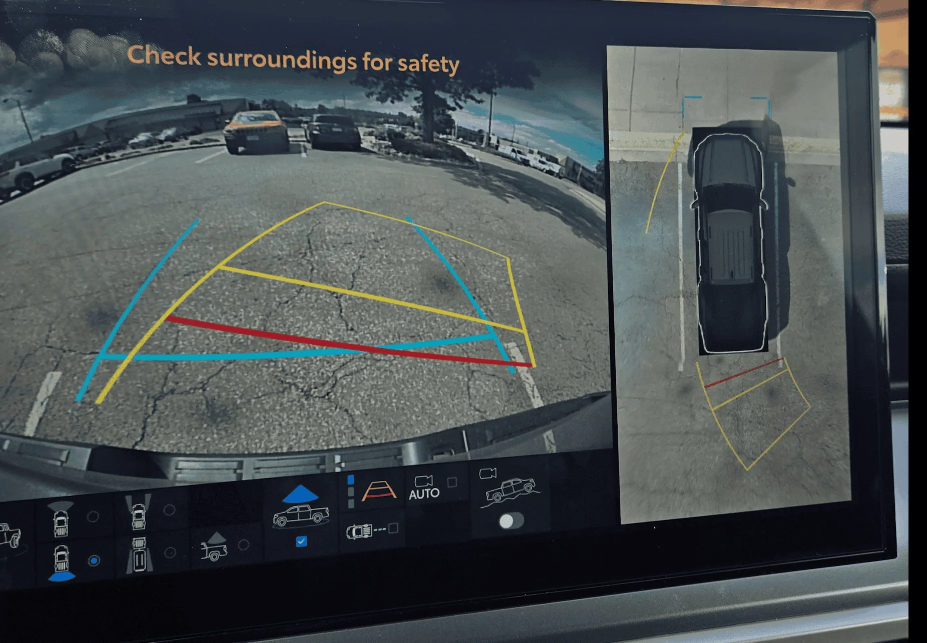

On a separate topic. I am used to parking Land Cruisers with Bull bars and a bit shorter wheel base. With the shape of the hood, it is a guess where the actual edge of the fender is, but I will get use to it. Takes time to become one with the vehicle :)
I am glad I got the premium as the birds eye view can engage any time with the push of a button and it lets me know when I am good between the parking lines. All the cameras and algorithms are pretty cool
The safety sensors are real good at letting me know when I am close to something and automatically turns on the camera view.
The rear cameras look for traffic on the sides in a parking lot and pedestrians and display the item and direction with arrows. They will even brake if it thinks you won't in time backing out with a car coming up the lane :)

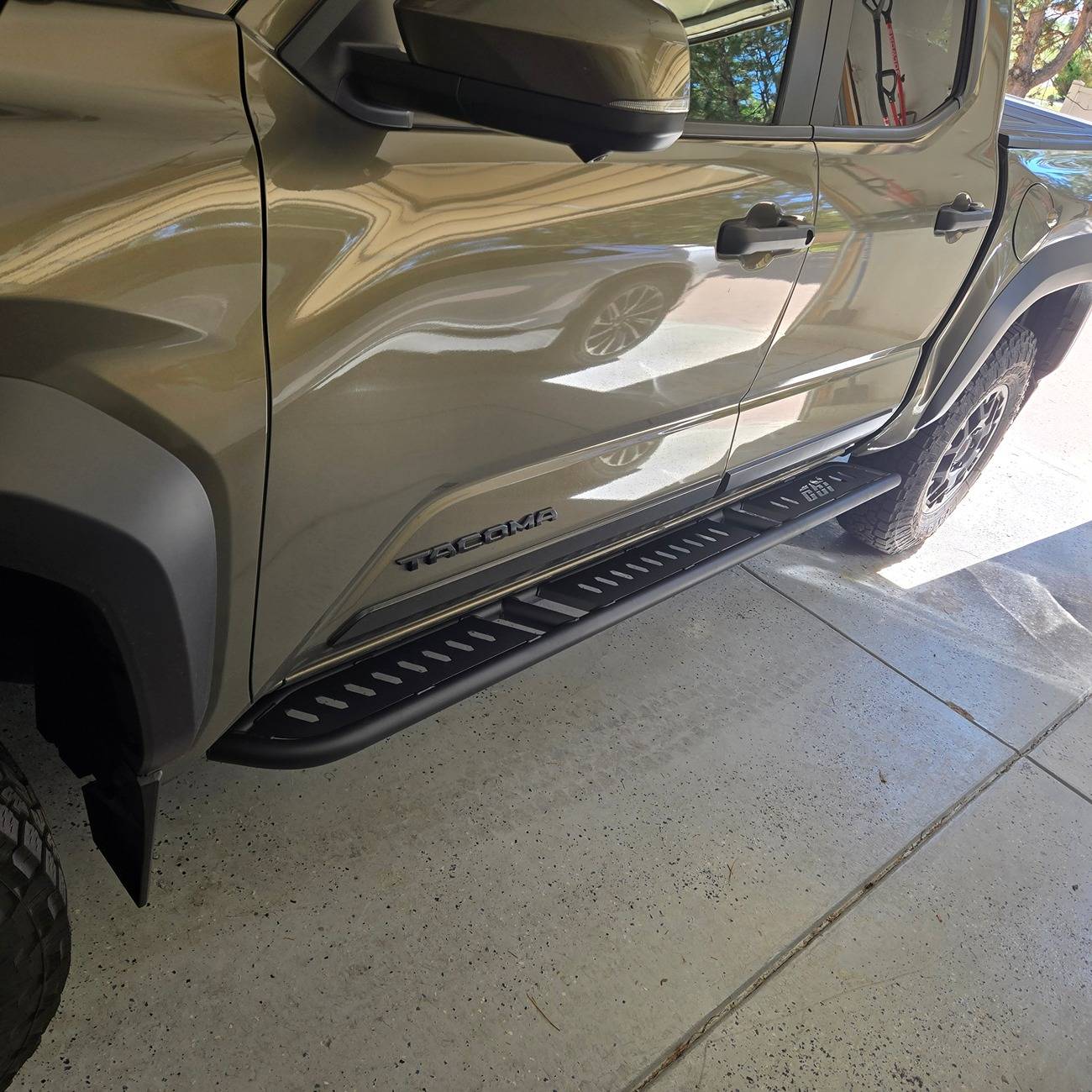

I researched the Various Taco Slider products for the 2024 and there were quite a few. I settled on the CBI Step Sliders

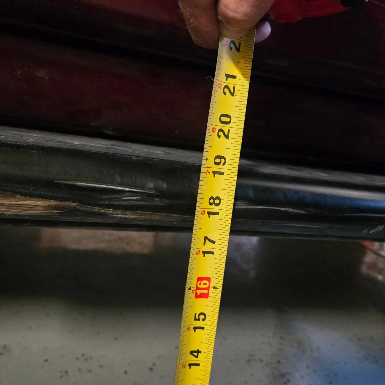

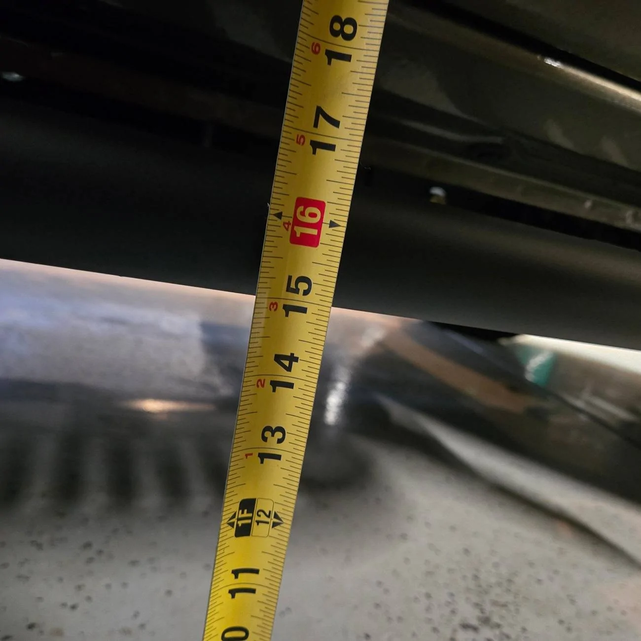

I compared the clearance height to my 200
Taco- Stock offroad suspension
2024 Tacoma Build Thread Romer's 2024 Tacoma Off Road Bronze Oxide Taco Slider Height
200 Land Cruiser at 17.5" Similar Step sliders
2024 Tacoma Build Thread Romer's 2024 Tacoma Off Road Bronze Oxide LC Slider Height
If I want to even it up, a 2" lift will likely do the trick. No plans to do that now as the Land Cruiser is my primary wheeling rig and this for the short term at least will be for light wheeling

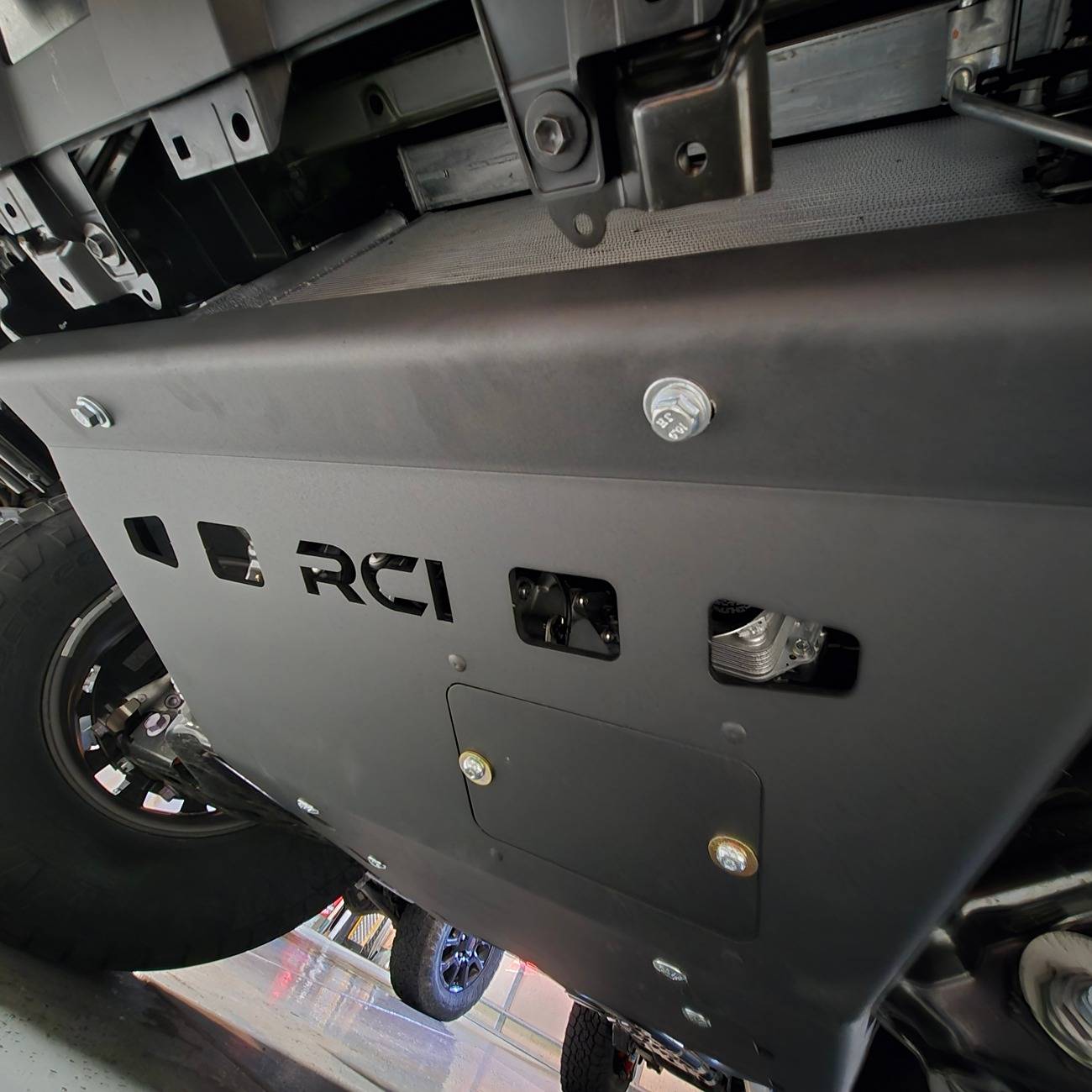

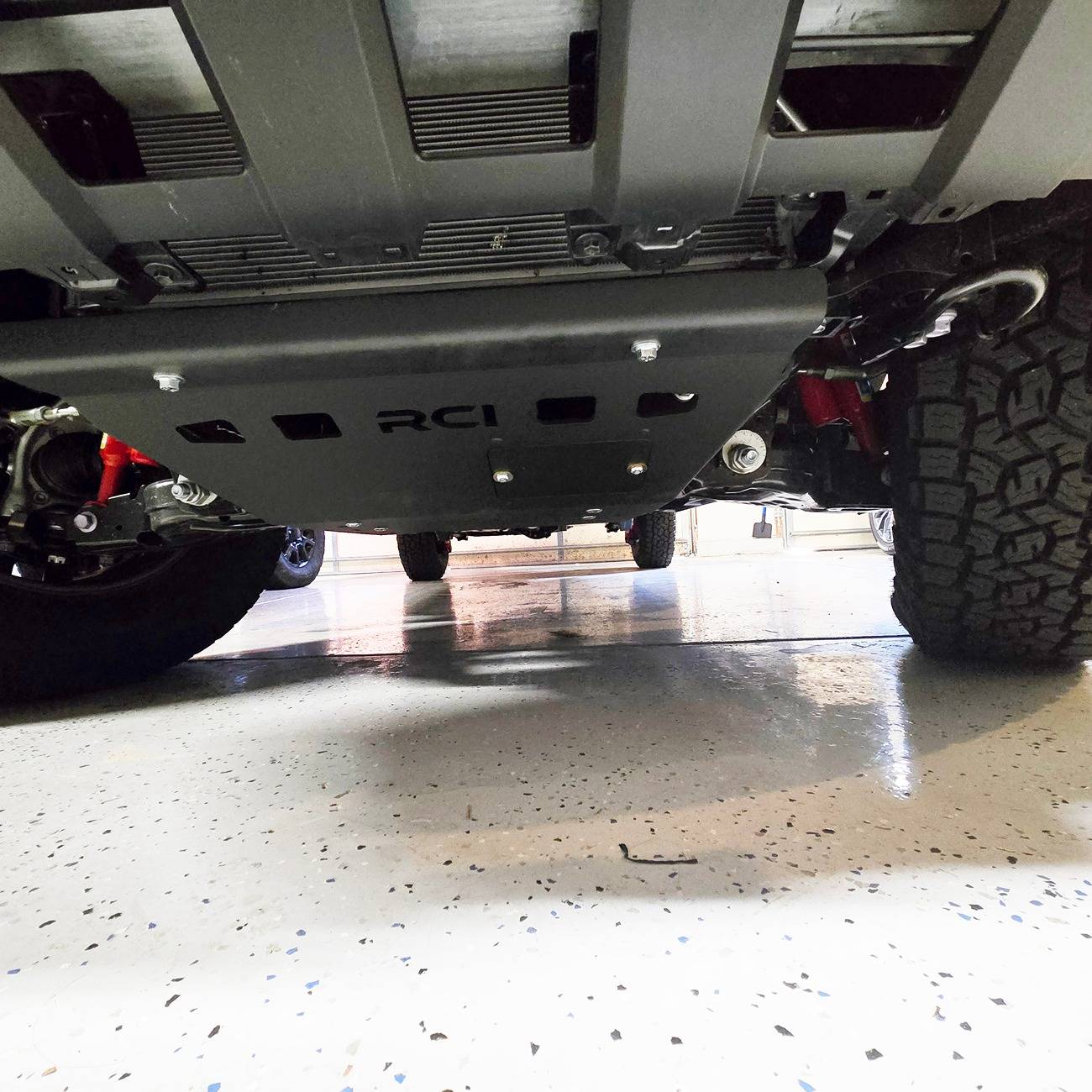

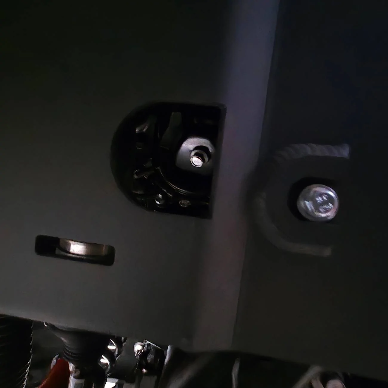

I also got the RCI Skid plate. My two requirements were access to the filter and oil drain without having to remove the skid plate. Interesting that you have to remove a TRD skid plate on the Trailhunter for oil; changes. Although, after installing it it is obvious the oil will hit the top of the plate when the oil first starts coming out so I ordered a Fomuto valve. Thinking the next time I change it, I can wrap a foil cone around to direct the flow and then install the valve. It is a well built plate and I am happy with it. I got the Aluminum one and considering the rest of the set. The Taco is nice that after the engine the componets are more recessed higher into the frame reducing the possibility of damage.

I like those sliders @Romer - I bought the RCI sliders, but these look a bit nicer to me. Really like the RCI skid plate, although I will most likely keep the TRD one on my Pro. I might have to consider the rest of the RCI set one of these days. I agree about liking how they tucked things up, making the mechanical bits safer, but you can never have too much protection.
