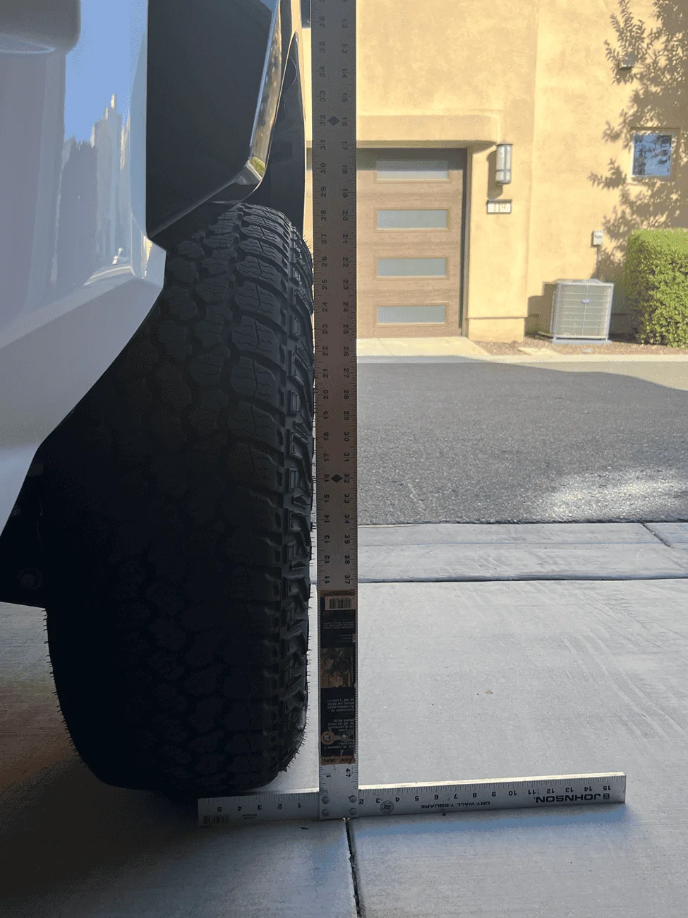

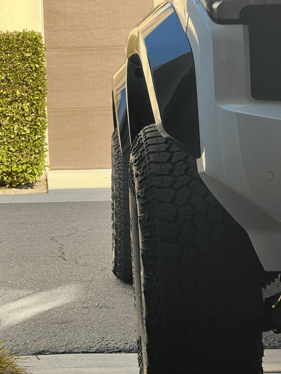

I have a little over 1000 miles on my Pro. Yesterday, I noticed my front wheels are now canted inward. I'm assuming this has to do with the break in with the suspension and it just needs to be adjusted. Can anyone with suspension knowledge confirm? I have an appointment on Monday. Anyone else with a Pro noticed this on yours?

Still waiting on my Pro but most of the pictures that I have seen show positive camber like yours. I assumed that was on purpose, but maybe they all need an alignment.

I know the Tundra Pros had similar issues with the alignment where the tires were wearing on outside edge.

I can't find camber specs for a 2024 TRD Pro. The best I could do was find the specs for a 2023. The front camber range was between -0.3 and +0.8 degrees. So some positive camber is allowed but I am also guessing that @Wighty's truck is more than that.
In a couple of threads on 2023 Pros owners often found various specs from different Toyota dealer and many had excessive outside tire wear. Toyota must know what the camber should be, but I don't know how you find that information. Some people had better luck taking their trucks to independent alignment shops.
I would love to find the real specs so we can sort this out before we start wearing out the OEM tires on our new trucks.

@Wighty So it was definitely way too much positive camber in the front, as it appeared. That will save you some front tire wear.
Another good thing to know about and check on a new TRD Pro.
