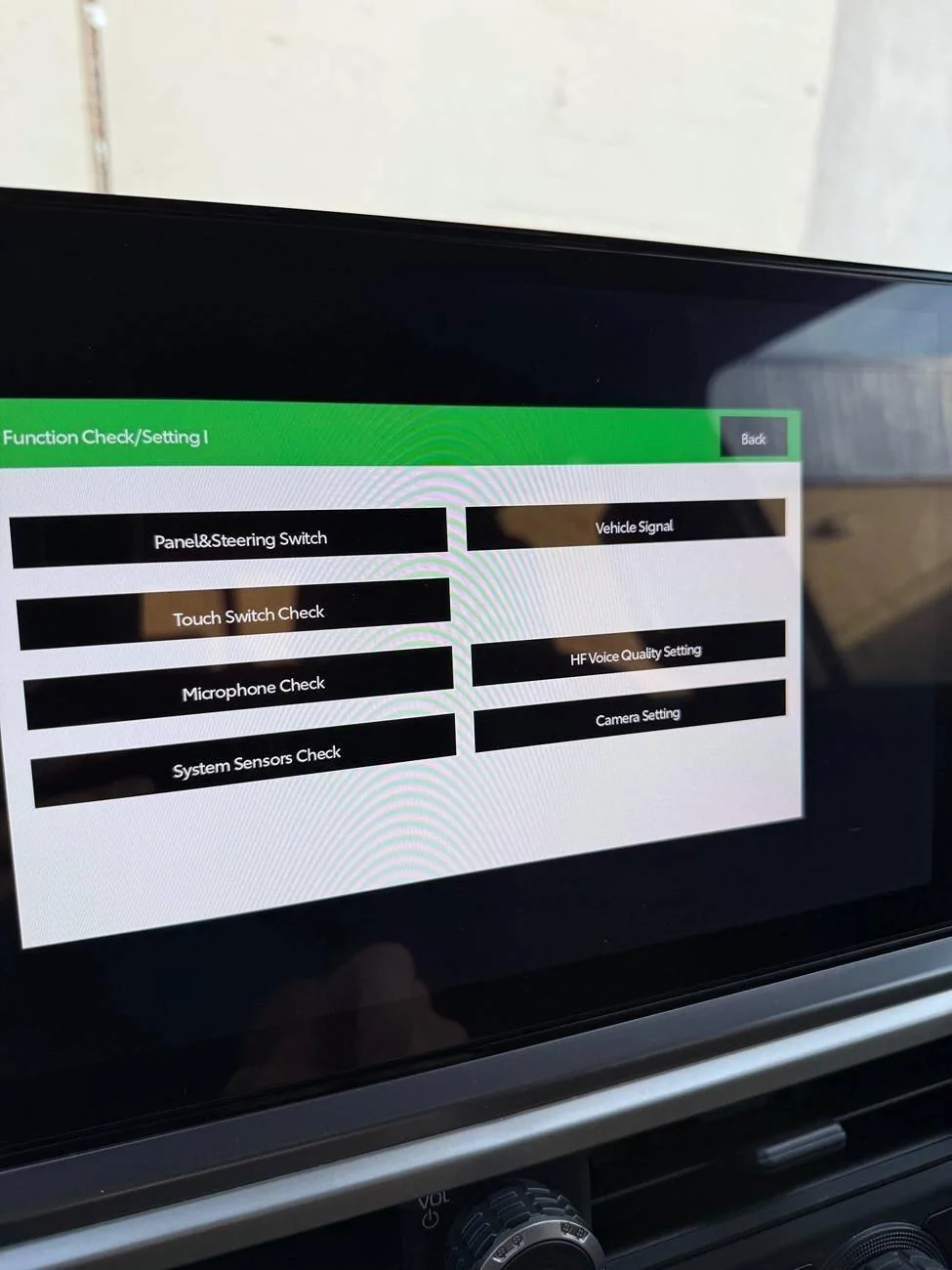

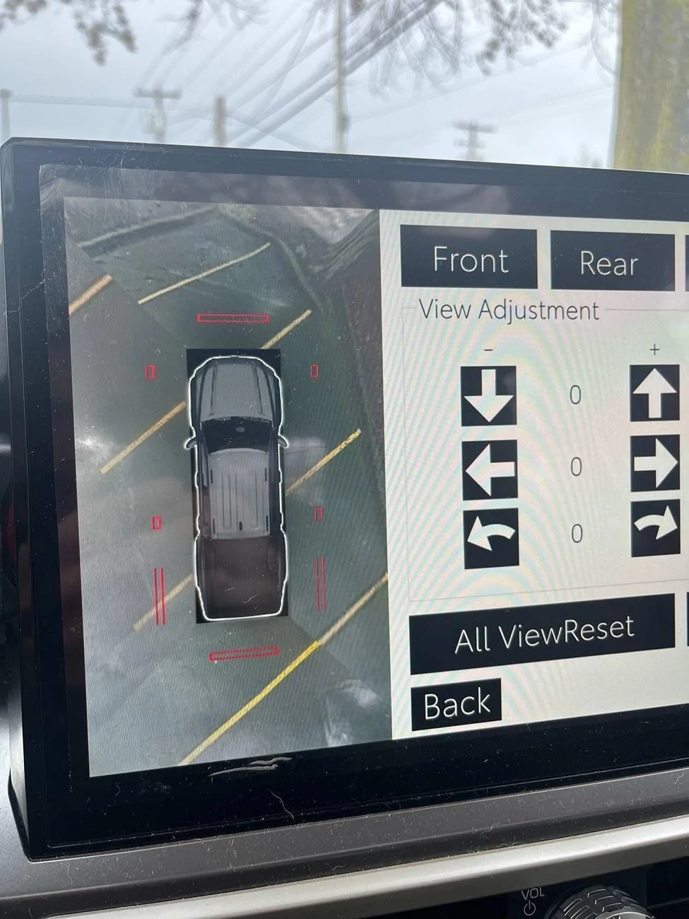

So on another thread, there was talk about how you can adjust and calibrate your 360 cameras so they line up seamlessly. You access this hidden menu on your infotainment screen. But to my understanding, once you save your adjustments, you can't readjust them again.
Does anyone know if it’s possible to access this readjustment menu again? Do I need to use Techstream or another software tool to reset this adjustment menu? Or is there an easy way to reset it without having to take it in for service and paying a absurd fee?
If you are curious, you access this Service Menu by
Put your truck in accessory mode (double tap engine start button without pressing brake pedal)
- On your infotainment screen, go to Display and turn your display off
- Swipe left to right on the (now turned off) screen 5 times
- Swipe right to left 5 times
(You have to swipe pretty fast, I would say you need to complete all 10 swipes in under 2 seconds for it to work).
WARNING: Apparently you can only adjust your cameras one time.
Screenshots taken from this thread

the caveat is that it’s greyed out after the first time you apply your settings.
I am asking if there is a way around this.
Yotota
Oct 10, 2024
292
289
SW WA
24 TRD
Negative, that's not a caveat. That's a sign that you can't access the function again. ?
(Just giving you some flak)
The caveats are that you need to recalibrate the Circumference Monitoring System in order to access the Diagnostic Menu camera adjustment again, or do everything through Global Techstream Plus.
The Circumference Monitoring System is being discussed in the other thread. I'm waiting to hear what another menu has to offer for those with the greyed out camera button.

So what exactly is the Circumference Monitoring System? Is that a fancy term for the 360 camera? If so, and I understand this correctly, to adjust the front grill cam, you will need to re-adjust all the cameras and only get 1 shot at this?

That's what we're trying to figure out.
Originally, the Circumference Monitoring System was just the Sonar parking sensors. Now it also includes the cameras (for things like Pedestrian detection), which is why the systems are linked.
