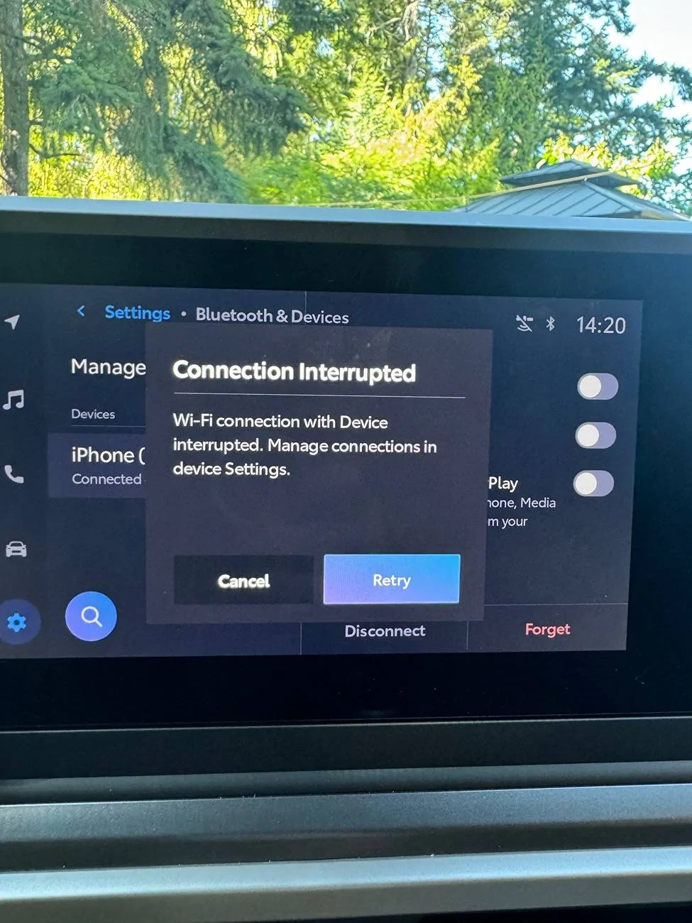

suddenly after working fine previously my apple car play will not connect wirelessly at all. All that shows on screen for issues is this photo I added. Tried forgetting device on phone and truck. And I have Bluetooth on. Whenever I go to connect to car play wifi automatically turns off.

I have my WiFi and my Bluetooth turned on my cellphone it connects if not make sure the vehicle is stopped and connect it with the phone icon on the screen.

Wi-fi and Bluetooth both on? I had the same problem once but was fine after I turned on wi-fi..

I have both on but when CarPlay goes to connect wifi will turn itself off every time

That’s what mine does as well.. but in 2 months I’ve only had the problem one.. Obviously yours is more problematic? Did you shut down your IPhone? Sometimes it fixes a multitude of problems?

I’ve reset my phone and will update when I try again. Not to worried as I know the new vehicle will have its bugs. If it keeps going I will contact the dealership

Try updating everything. I had to update my Google maps because android auto kept saying "oops something went wrong loading maps"

Issue fixed. Resetting your network settings on iPhone seems to fix the issue for now

It's very finicky for me as well, even with wifi and bluetooth on sometimes it won't connect. What I do to fix it is I got into settings in the media console, select devices, and then select my phone (it'll say "passive"), then the option for use for android auto will be deselected for some reason, so I enable it. Once i enable it android auto connects

I would in the future have your phone and vehicle both forget each other and reestablish your connection ground up.

You cannot have the truck WiFi on at the same time using CarPlay - I don’t know why but I know you can’t use both simultaneously.
