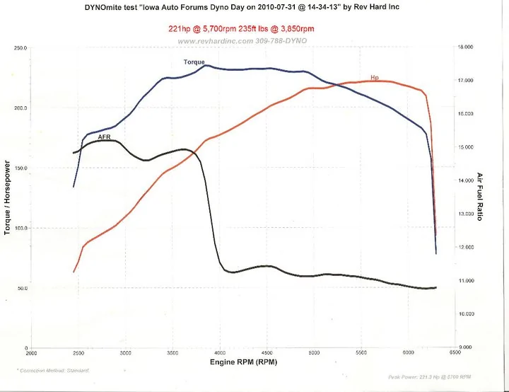

This is exciting. Id been missing my turbo cars. I like what Im seeing from both Cobb and OTT. Now I want to share a dyno that will make every tuner squirm. Ive had my fair share of DSMs, subarus, bmws all that I will ofcourse build and tune. This graph is of a stock 04 forester XT with downpipe, and intercooler upgrade. The ecu was locked on this 04 for some reason, so it went back to stock as soon as we saw these AFRs! Id like to add I never lost an engine in my subarus either, fxt, sti.

I've done literally tens of thousands of Subaru dyno pulls and they all do this on the stock calibrations. The closed loop to open loop delay on the USDM cars is there to lower emissions. If you pull a stock file from a JDM car, the delay is 0.
You're correct that this is no good at all, and a huge reason why a tune is needed after a downpipe because the car will come into boost sooner, and stay lean in boost longer.
Thanks for sharing the graph!
