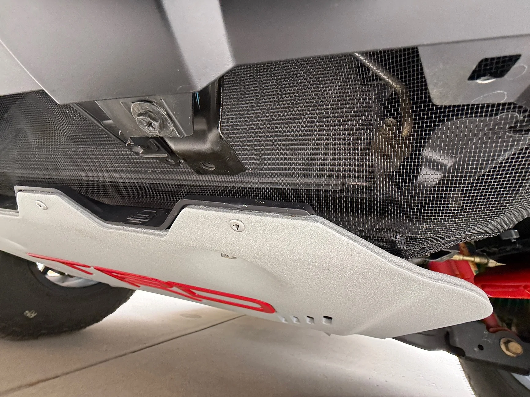

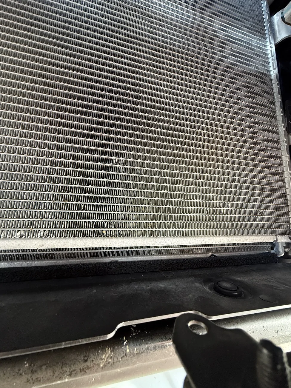

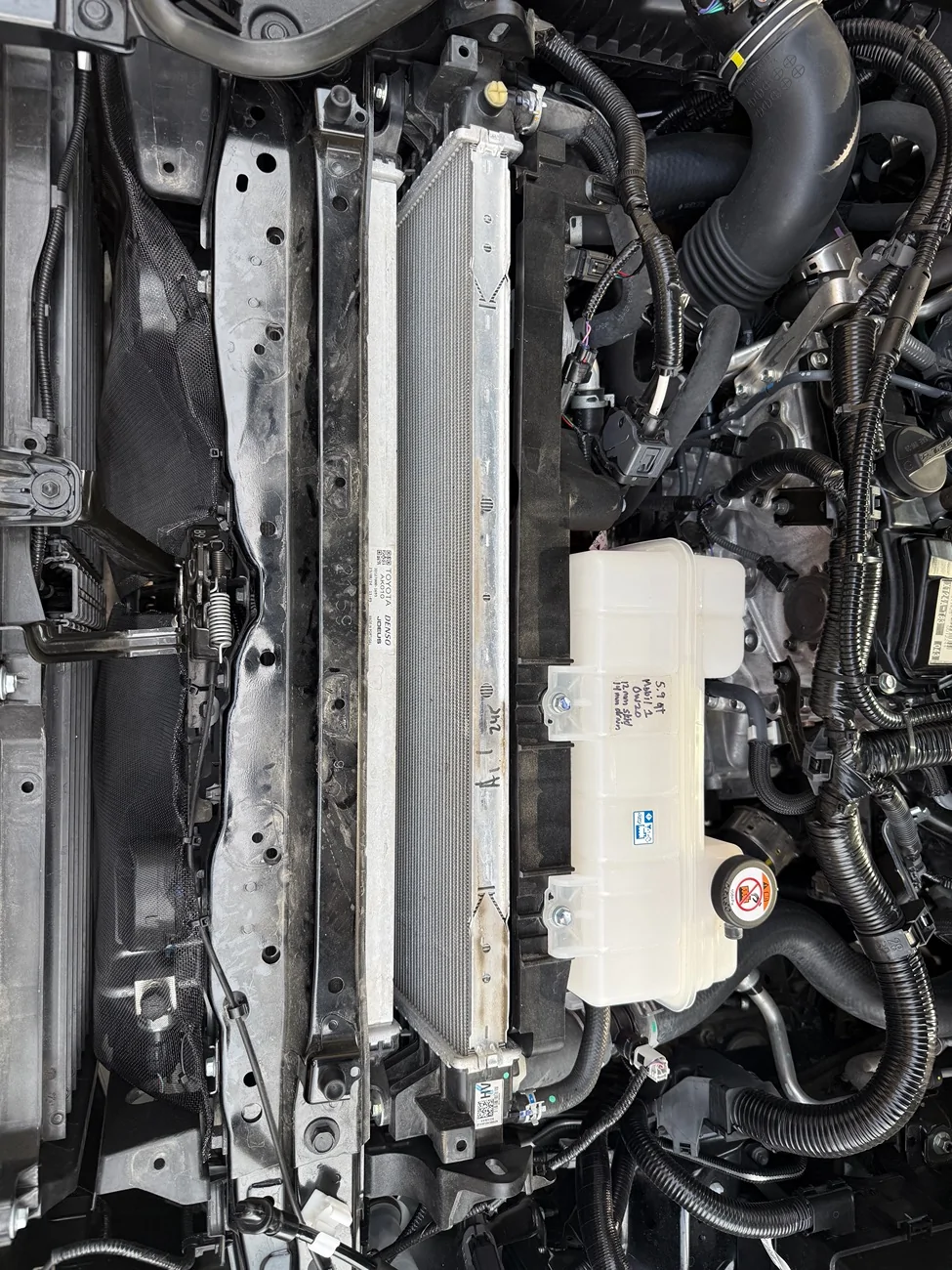

Screened mine today. For only 6,200 miles driven….mostly in the city, and I never tailgate…the condenser has way more dings than I’d like to see. It really is paper thin!

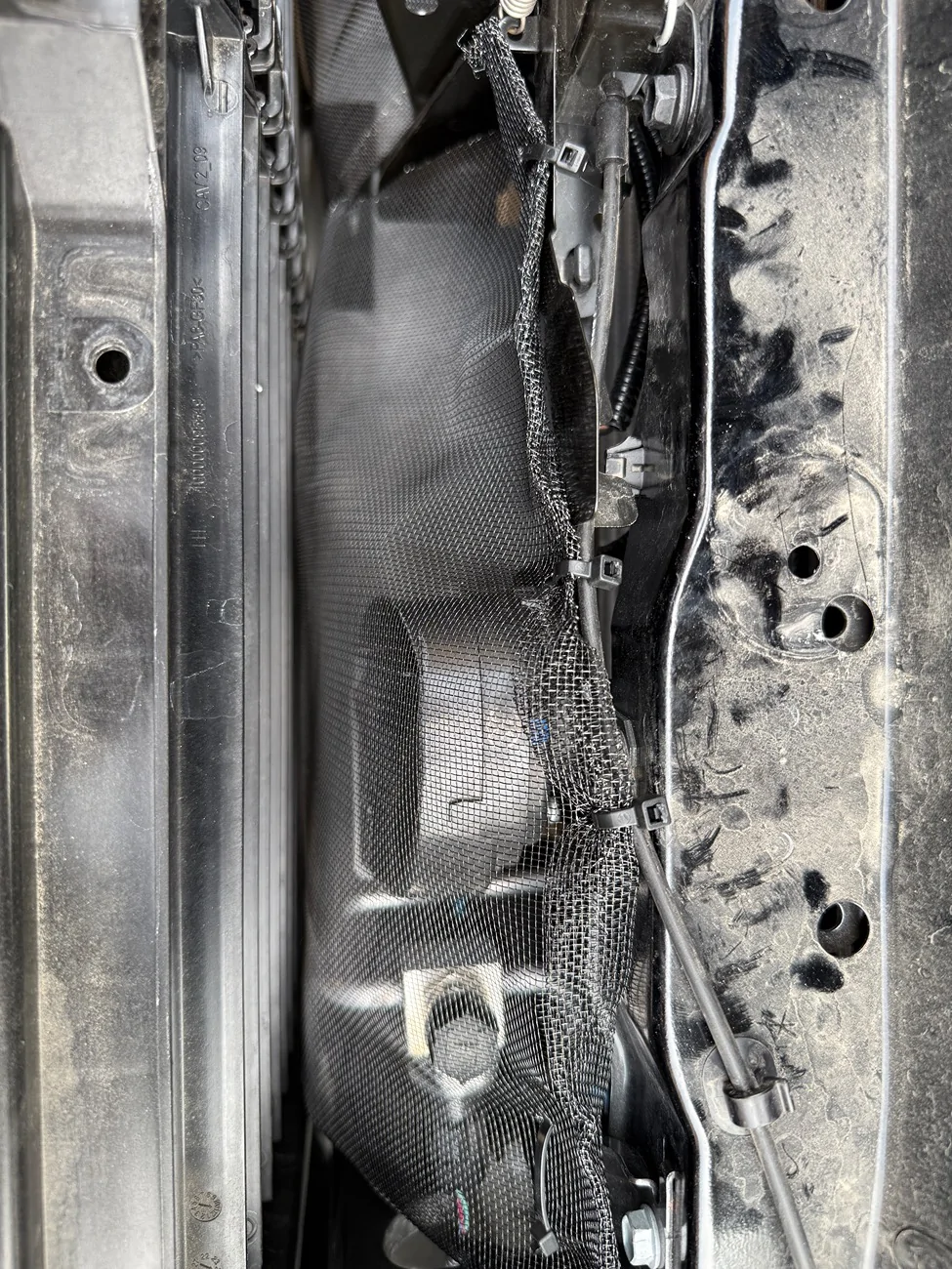

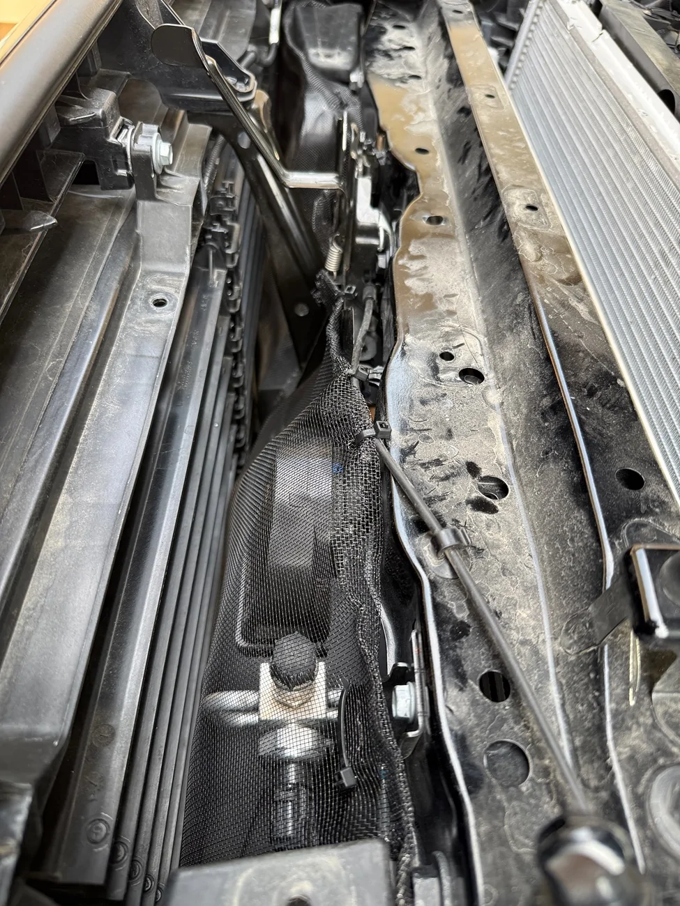

I used black aluminum screen. Had to cut two vertical pieces for the upper, placing it behind the grill shutters. Then another piece across the lower opening. This should help protect the entire cooling system from rocks and bugs. Took me about 1.5 hours to cut and fit it all.
