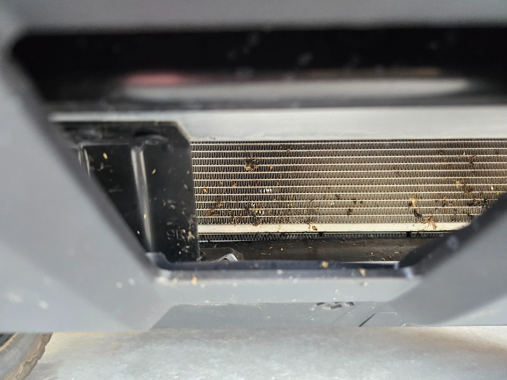

Maybe a rock or large bug struck the A/C condenser, and it leaked over time not to my knowledge until wife wanted to run the A/C.
Toyota dealer stated warranty claim rejected and same with corporate customer service. They told me to file an "accident" claim with insurance to cover the over $3k repair bill.

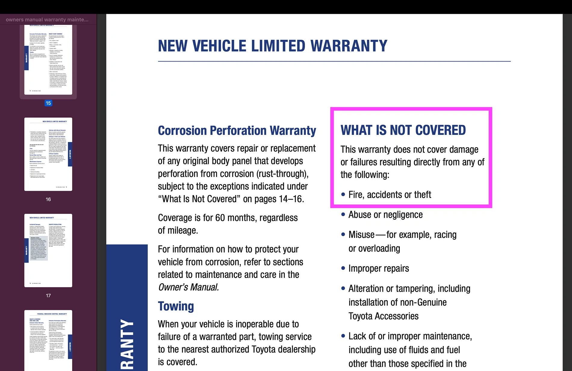

Where was the leak from? I see a few bends and dent marks in the cooling fins but nothing that would lead to a leak from the cooling tubes. If it really was from those little dings that's wild, I've seen way worse damage on nearly all my vehicles. I might have to put up a stainless steel mesh on the valance similar to the factory skid on the 5th gen 4runners.
Tech and service manager said a small pin hole leaked out all of the freon over time.
Right now the condenser is empty.

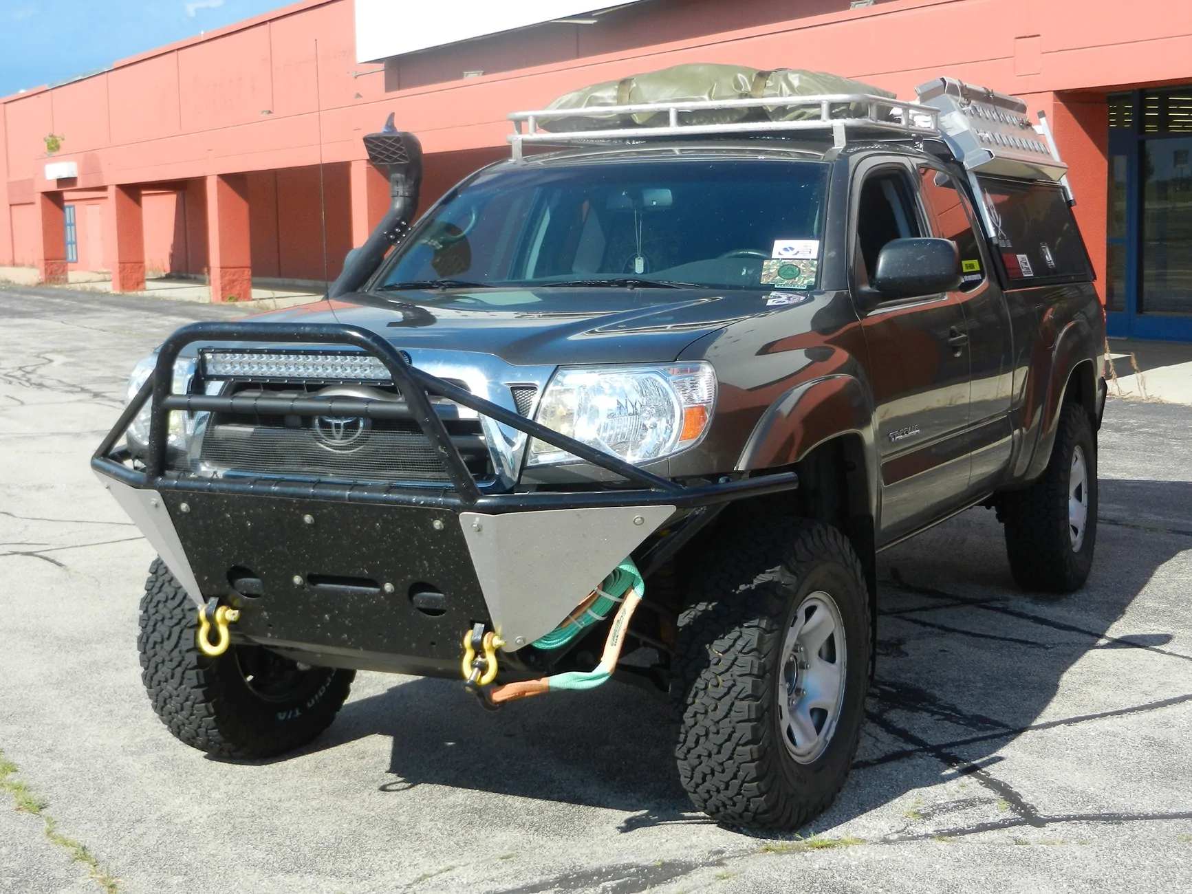

I just saw this post. Maybe those will help in the future.
My 2010 SR5 had skid plate up the front and even chicken wire up there.
But that was my BOTT, this 2024 truck looks too good to mess up the front with a desert type front bumper.
