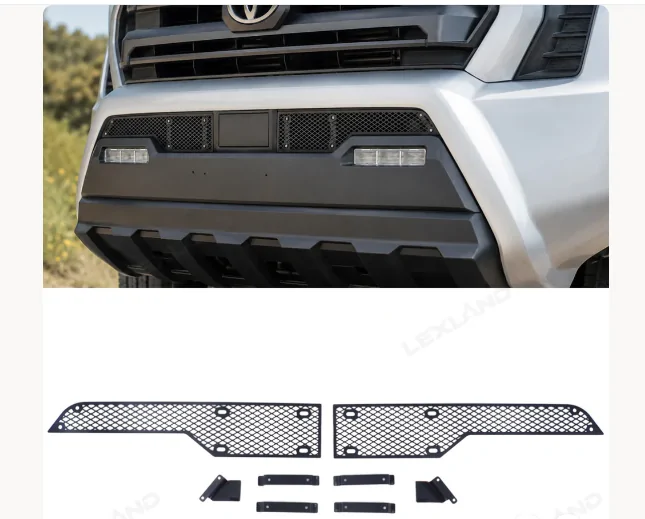

This is very much a common and ongoing issue with the Grand Highlander. Owners have resorted to installing a diy two piece mesh screen behind the bumper to protect the rads against rock strikes.
It’s definitely a design issue on Toyota. Form over function.

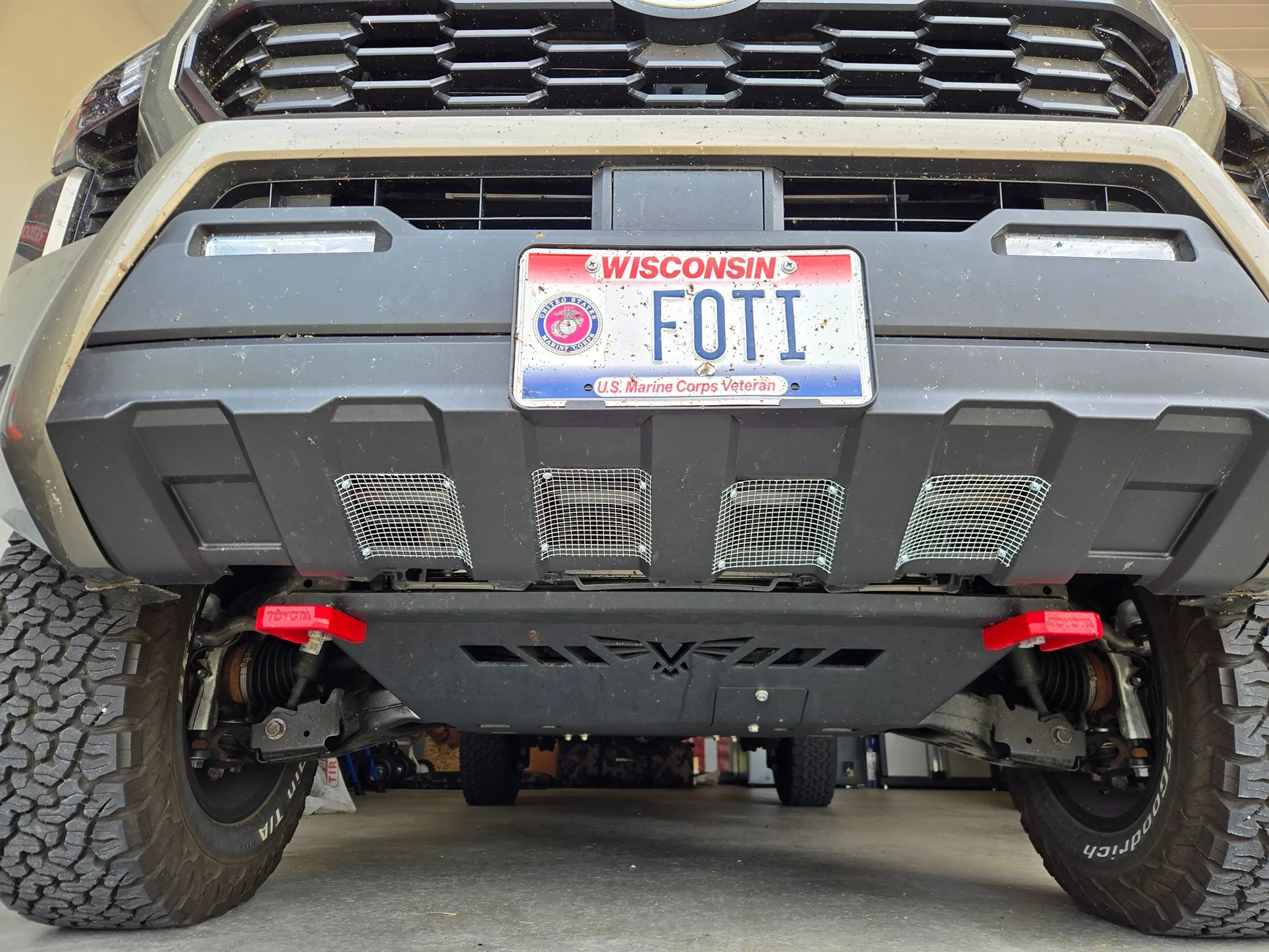

I will start with this:
And I will design some chicken wire squares that I will self-tap into the 4 lower square openings on lower chin that Toyota overlooked when designing a truck.
I have had that exact kit saved in my Amazon cart for like a year now lol. Maybe it’s time to hit purchase! I agree that the lower area underneath between the bumper and skid plate is a very vulnerable area. Should be a screen in the summer and blocked off in the winter to help keep the engine warmer (I’ll be doing that for this winter to hopefully help alleviate my oil dilution issue in the extreme cold).

Since Toyota makes weak condensers, I finished phase 1 of the front project. Basic chicken wire and self-tappers plugged the 4 openings on lower chin.
Does not have to look pretty, gets the job done that Toyota lacks.
