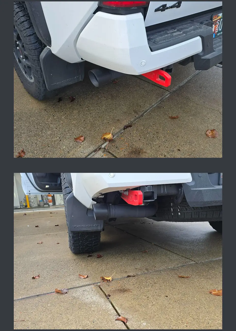

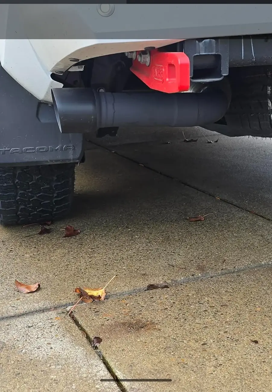

Found that photo. This guy just had the tailpipe cut but kept the resonator and got a new black single tip. Can't remember if he just painted the rest himself or had a shop do it, but painted the new bend.
The nice thing is you can just mess around and try it and change it back if you don't like it. I'm on my way back up through oregon and snagging someone's brand new OEM tailpipe section for free in case I get annoyed with my TRD pipe one day.
People just take the OEM tailpipe off and toss em

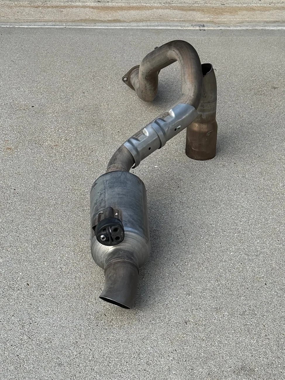

Found a another TRD exhaust so compared side by side for those interested

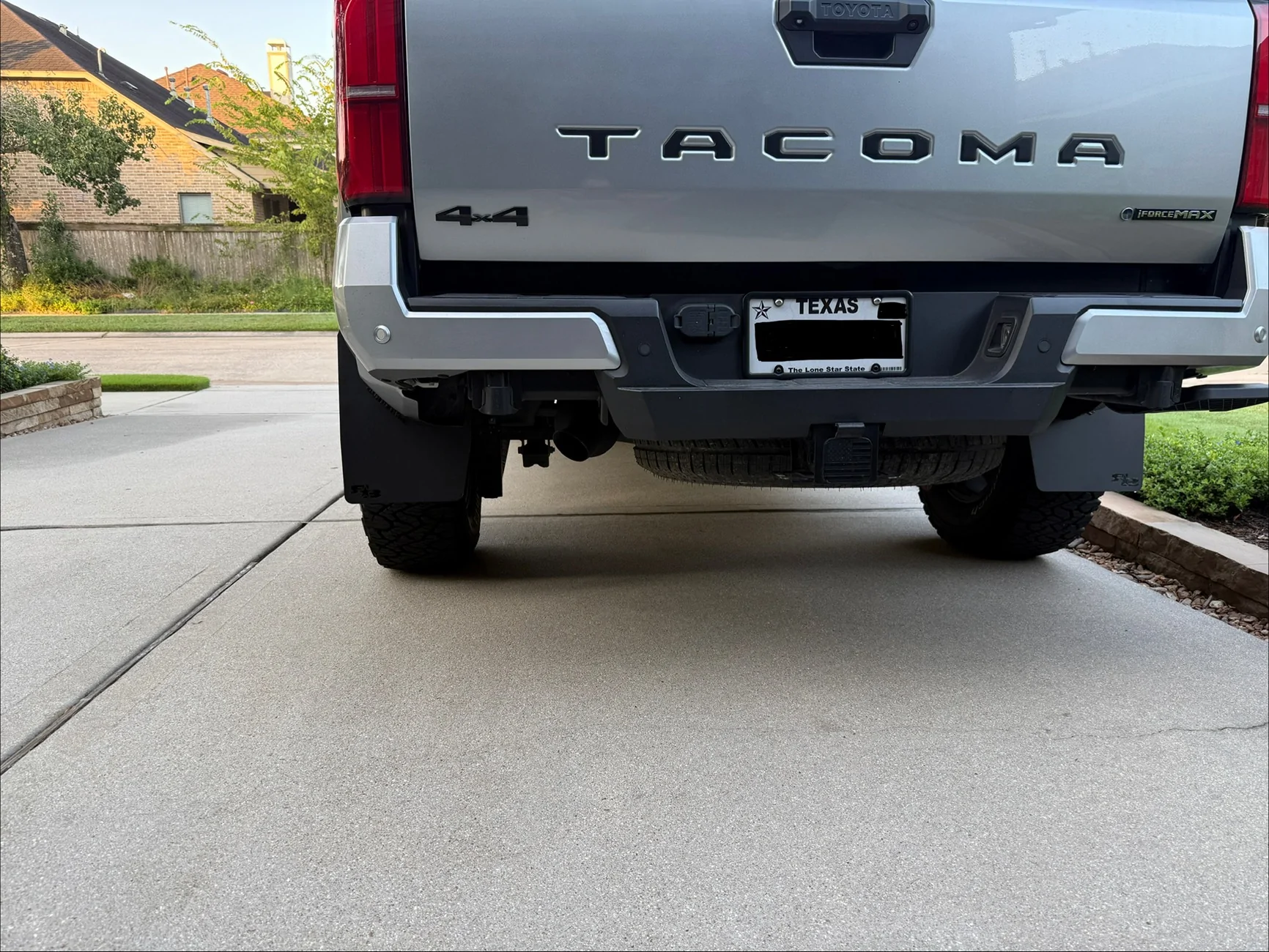

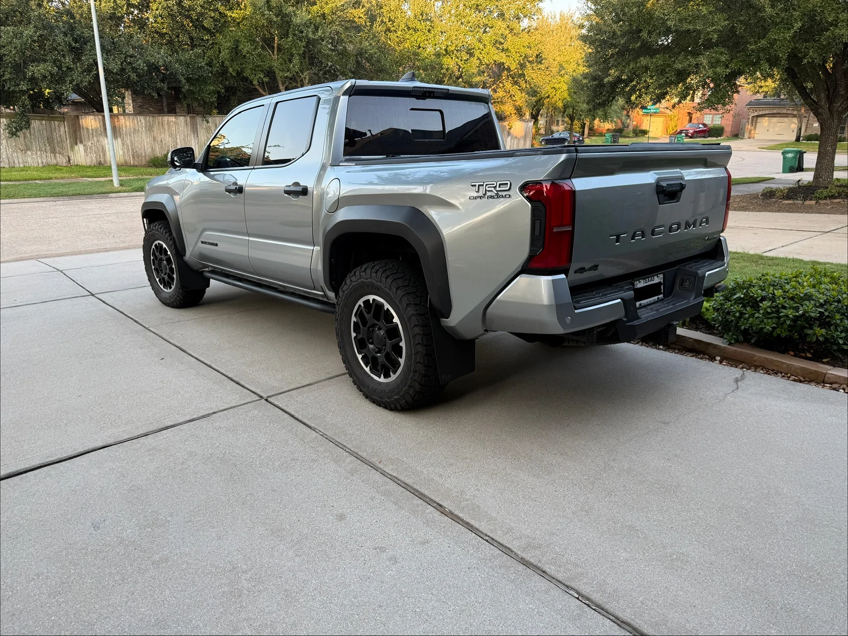

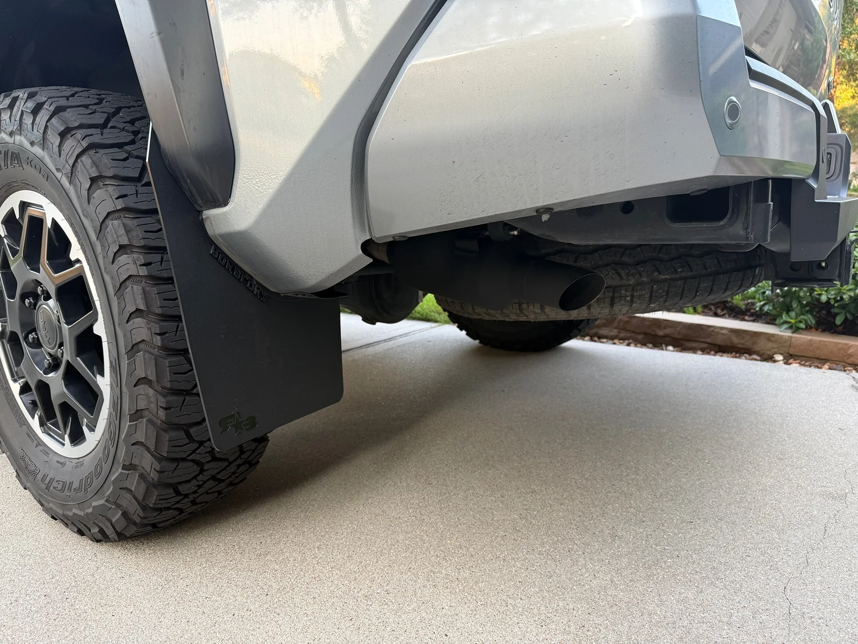

Here’s my fix. Cut the tip off, cleaned it up, painted with high heat ("flame proof") spray paint. Sounds great. Can hardly see it at all. Wish Toyota did this to begin with.
Looks great! And certainly the quietest option
