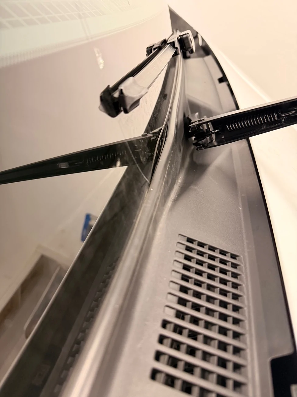

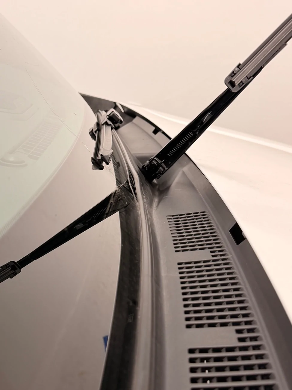

Think I figured it out. The noise is actually stemming from the windshield wiper cowl. The plastic corner pieces when pressed don’t seem to make noise from the outside but when sitting on the inside it rattles in addition to the cowl. I do notice a bit of a gap on the seal of driver side cowl that is supposed to sit flush with the windshield. Gonna bring it and get it replaced under warranty.
Passenger side is completely silent but drivers side makes the noise. I confirmed it by placing a towel between the hood and cowl on the driver side to apply pressure, then I went for a test drive under similar road and weather conditions. Bingo-bongo, the noise is gone.

I do see a bit of a bulge on the cowl…?? But no obvious signs of anything rattling. The wiper fluid hose was wiggling around so I just rerouted it a little. I dunno anymore
