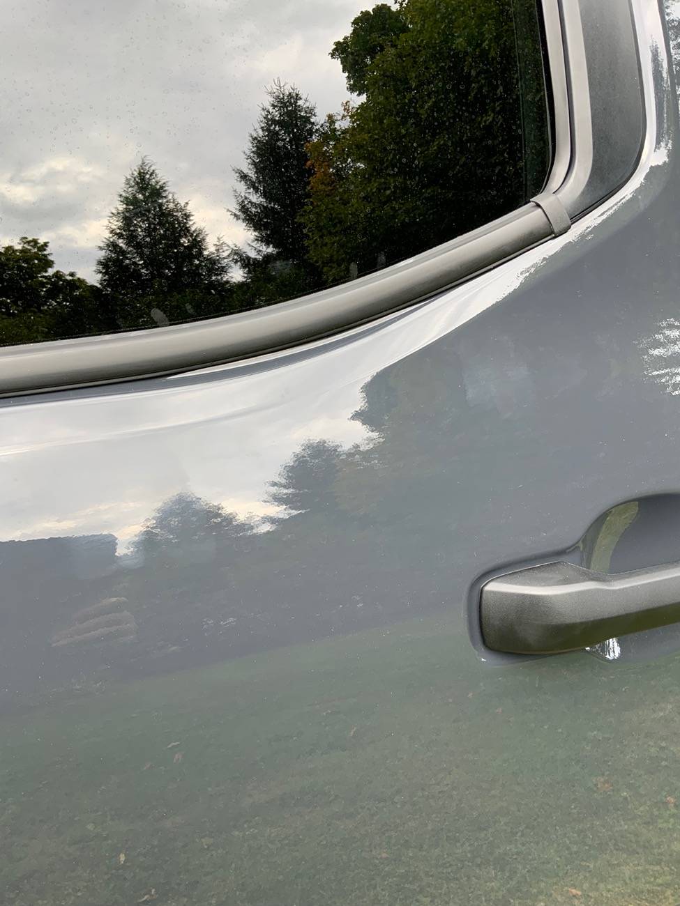

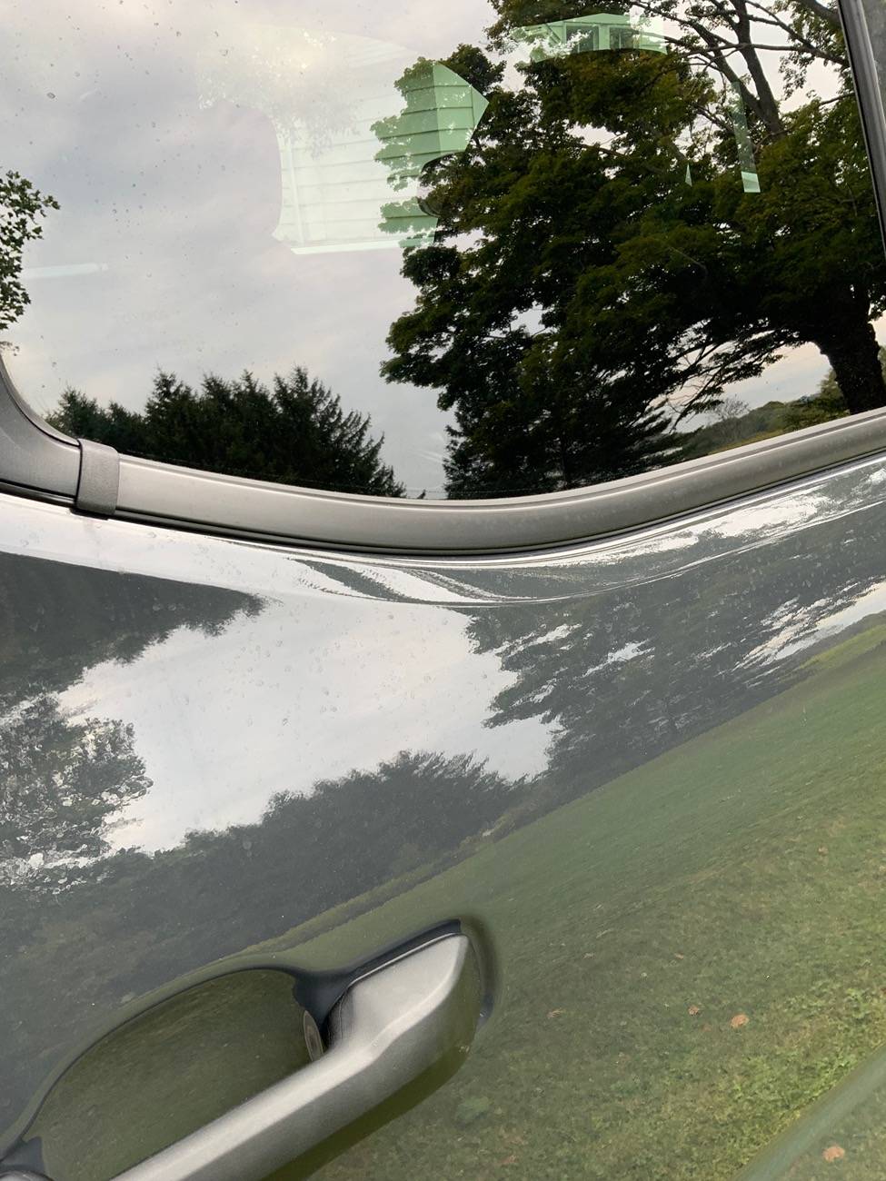

This is a photo of rear door window seal. I was just at dealership Wednesday but I am going to make another appointment to get this looked at in case it’s like the windshield cowl and no time frame on back order of parts.
Some of these people obviously never owned a truck let alone a Toyota truck.
You got that right. It will NEVER be un blemished and perfect. sheesh.
