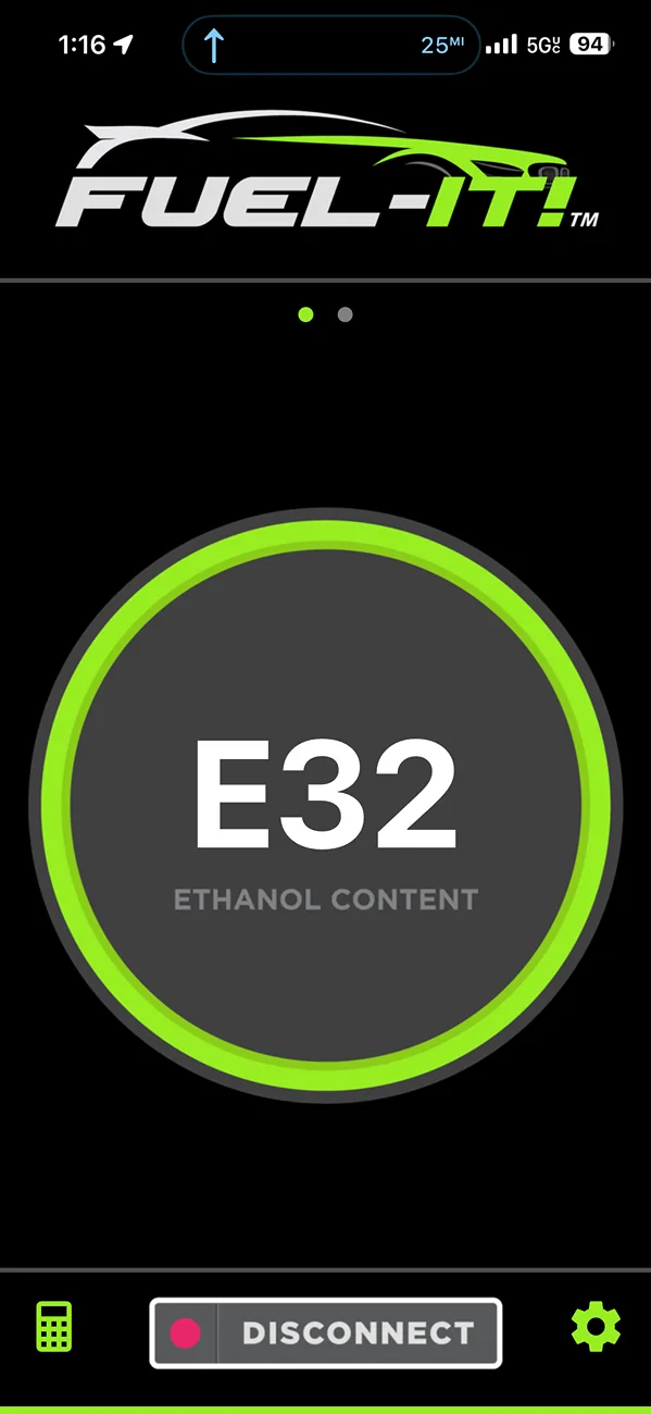

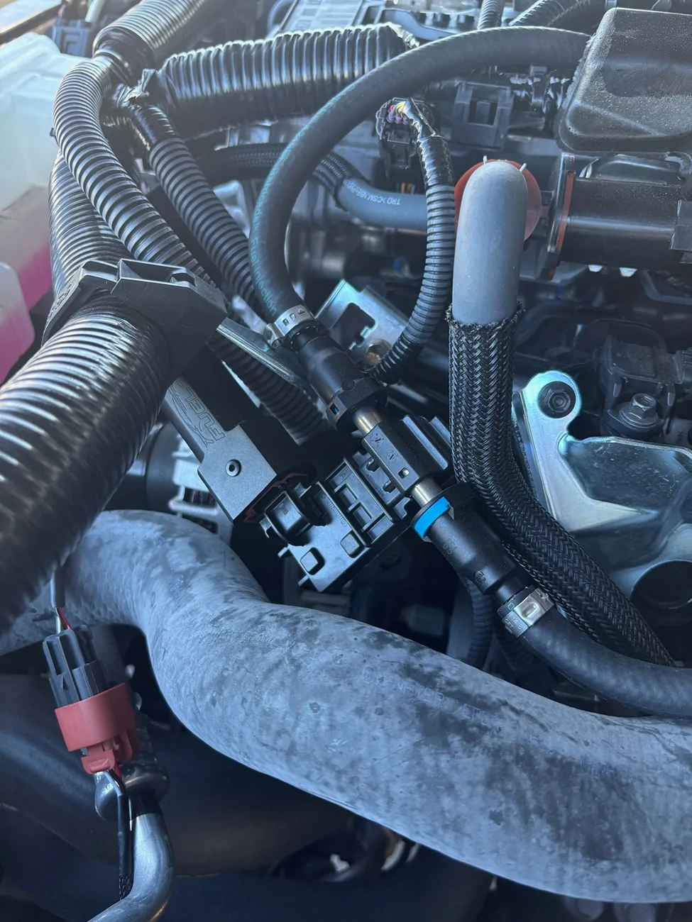

Just wanted to get on here and share my experience with tuning my daily Tacoma. Seems like everyone's first mod on their trucks are wheels and tires. Coming from the Honda game, i didn't realize how heavy a set of wheels and tires was going to be for my truck. I definitely felt a decrease in power and acceleration. With that being said, i looked into getting my truck tuned to compensate the added weight and any weight i plan on adding in the future. That's when i got a Cobb AP. The Cobb AP definitely woke the truck up and gave me that power and acceleration i was looking for. I knew this truck had more left in the chamber so i decided to get a OTS tune from CAMTUNING. This was the best decision I've made for my truck since getting wheels and tires. CAM made my truck feel like a completely different vehicle! The power, the smoothness, the shifting!!! It feels ALIVE! The OTS tune is tailored to my truck so i was definitely getting the full use of my mishimoto intake and SXTH dump pipe. The truck felt so light, the shifting was crispy and smooth, and the power delivery was amazing. I felt like a kid again lol. Cam told me we can squeeze out 20-30hp more just by adding e85 so i got a E85kit right away! Install on the e85 sensor was extremely easy with the help of CAM guiding me over the phone. He was able to set me up with a custom e30 map that felt like my truck was gutted with slicks lol! the e85 made a huge difference in power! the 1st-3rd gear pull put me back into the seat, You can feel the raw power and acceleration! I was extremely happy with the route i went with on this truck! with the help of CAM, this truck is a beast and fun to daily! cant wait till the intercooler comes in! All the added power but CAM always made sure its reliable power!!! something you can daily with no issues! that's what stood out to me! He always made sure the truck was running strong and smooth without sacrificing reliability! So if you guys are on the fence of tuning your truck, JUST DO IT! You wont regret it!

On these trucks, it’s not just a matter of adding a sensor and calling it flex fuel. You still need a calibration that’s designed for ethanol content, whether that’s a fixed blend like E30 or a true flex fuel setup that can adjust dynamically. For what we’re doing here, E30 is a controlled mix, so no sensor is required—but consistency matters. I do recommend using an ethanol test gauge so you know your blend is actually where you think it is.

Thank you for the response, I appreciate it as I don’t know too much about this stuff obviously. So the sensor in this post is just a ‘tester’ for the convenience of knowing the mix ratio electronically at any instant? And the tune is just set to e30? Is a dynamic system possible on these trucks, maybe not currently but potentially in the future? And based on your experience and knowledge, potentially fuel pump and most likely injectors will be the bottleneck, as it is in most cars? These are dual injected engines. You said the port injectors would need upgrade for big power? Does the engine not run off the direct injectors when going for power? Or will it run on all of them?

There isn't an off the shelf dynamic system available yet. I understand there are some folks that have it working on ECUTek, and I expect Cobb will pursue it eventually. I said port injection because that's the easy one to swap, and it will take them releasing some aftermarket DI injectors. The engine relies heavily on the DI under boost, but will fall back on PI for additional capacity when needed.

My MPG stayed roughly the same. i was getting 19.5 to the gallon with 91oct. Now with e30, I'm now getting 19.1. so the change wasn't drastic. Mixing the fuel isn't a headache since the app tells you exactly how much ethanol and pump gas to put into your truck. i do let it idle for at least couple minutes so the sensor can fully read the ethanol content before driving off.
