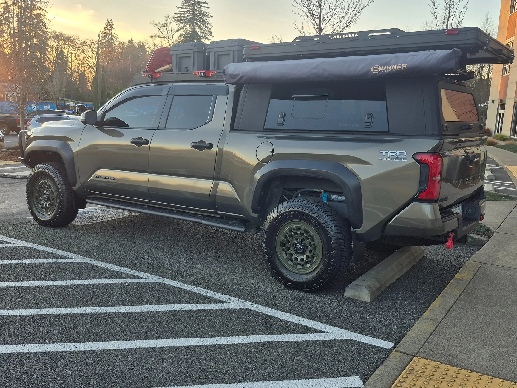

Wife bought my 24 TRD

Dude...we get it, we know what your truck looks like. If you're going to keep posting, at least try to contribute something meaningful to the thread rather than just showing off your truck.
I just did, sorry if you didn't find it informational.
Just saying WHO installed the lift.
